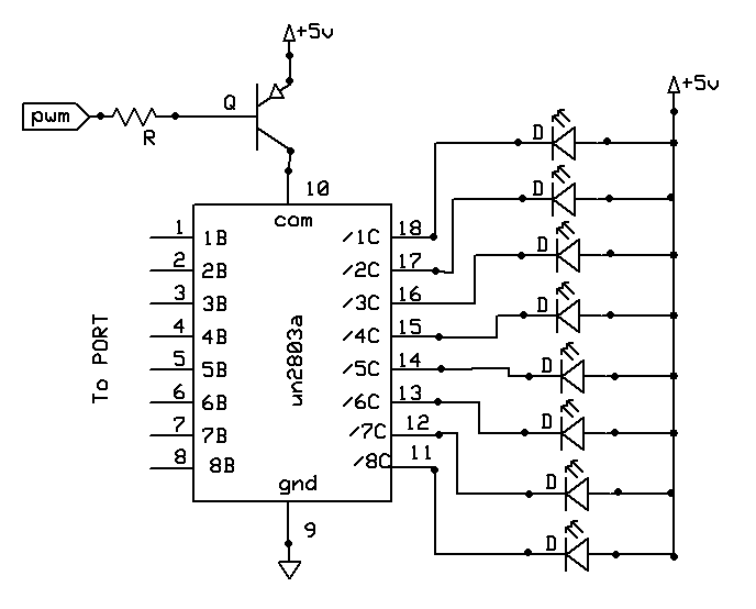

After looking at the video about 4 more times I would say there using pwm and 4 drivers for the leds the fading is broke down to 4 ports if you watch you'll see that.
I'm going to see if I can match it.
You think he is using 4 of the 9 hardware PWM drivers in the PIC to drive individual lines or an actual seperate PWM driver?
If you look at it, the fading is in banks of 8 leds. So there using 4 pwm channels with Led drivers I didn't put all the parts
But like this
Ohhh, I see, banked led's.
I suppose you could, to give that "random" effect wire them "randomly".
Good concept though, thats how he did it with a 16F before with that kind of driver obv.
How sneaky of them!
And clever of you for figuring it out!

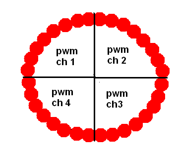

I still think its more like this. Because if you look all actions is in 4 he dimmed 8 leds on the four corners at the same time
then fades from left to middle and right to middle at the same time

Burt, you have much more experience with this sort of thing, but it still confuses me if you are right how he keeps track of the pins and PWM when using the 2803?

Your just scanning the port pins. For the leds and fading with pwm with the driver. I was going to test this out this week end

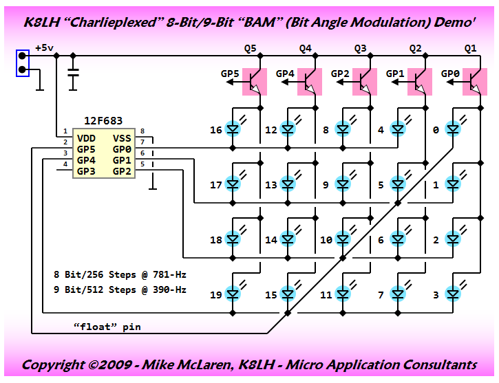

Sure. Here's a Charlieplexed 20-LED circuit with 32 duty cycle levels per LED.
The software PWM driver uses a 20 element array which contains duty cycles values of 0..31 for each LED. You stuff the array in 'main' with the values you want to animate the display.
Here's the code Futz came up with for the pattern shown in the video above (note that LED 0 is top left and LED 19 is bottom right). I had to use very low duty cycle values to keep from overloading the camera. The entire BoostC program listing can be found here.
Cheerful regards, Mike
//  simple interface to pwm driver using duty cycle values of 0..63
  led[0] = led[19] = 11;    // 11 * 0.3125% = 3.4% of 20% max
  led[1] = led[18] = 7;     //  7 * 0.3125% = 2.2%
  led[2] = led[17] = 5;     //  5 * 0.3125% = 1.5%
  led[3] = led[16] = 4;     //  4 * 0.3125% = 1.2%
  led[4] = led[15] = 3;     //  3 * 0.3125% = 0.9%
  led[5] = led[14] = 2;     //  2 * 0.3125% = 0.6%
  led[6] = led[13] = 1;     //  1 * 0.3125% = 0.3%
  led[7] = led[12] = 0;     //
  led[8] = led[11] = 0;     //
  led[9] = led[10] = 0;     //
  while(1)
  {                         // simple animation demo
    temp = led[0];          //
    while(!last_column);    // sync' to 16.25 msec frame rate
    for(x=0; x<19; x++)     //
    { led[x] = led[x+1];    //
    led[19] = temp;         //
    delay_ms(26);           //
