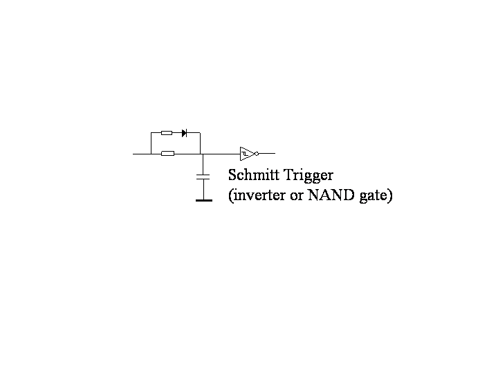

If you want to discharge the capacitor rapidly you can connect a diode across the resistor (or a diode and resistor in series so the discharge rate is known). The diode can be connected either way. One way it speeds up the charging, the other way it speeds up the discharging. See attachment.

Funny enough, in the earlier versions of the circuit I did use diodes, but they didn't seem to do the trick. That's why I switched to the transistors.
Maybe I did something wrong, I'll build another and see what happens.

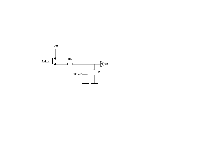

However, I just re-read your earlier posts. Since you are using a switch, the attachment below will be simpler. The R & C values will give you a delay of about 100 millisecond.
Edit, This is the wrong attachment as it gives symmetrical delays, I'll leave it and post the right one later.

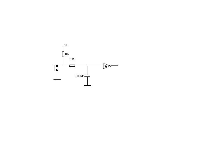

Here is the right one.
The capacitor charges rapidly when the switch is closed so the output of the Schmitt goes low after about 1 millisecond.
When the switch is opened, C discharges via the 1M so the output remains low for about 1 second.
I suspect that the reason your circuit with a diode did not work is because you did not include a "pull up" resistor.
