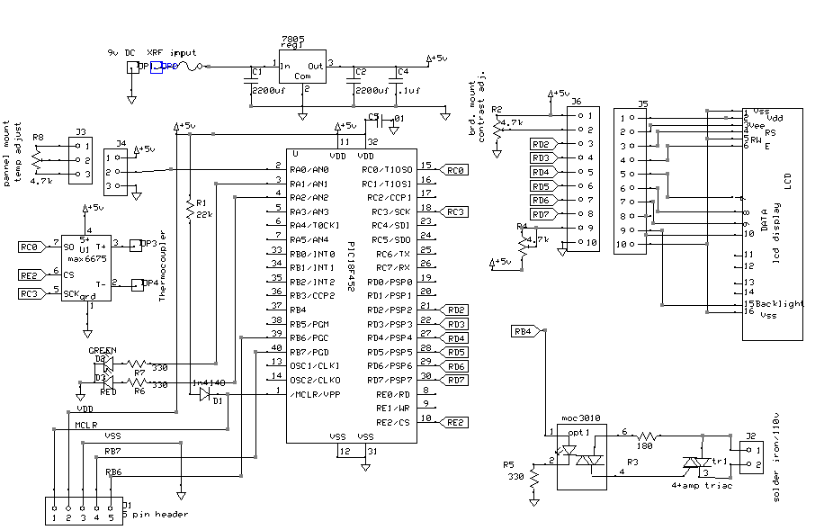

have a fairly simple project **broken link removed** that has the hex file and assembly file but having only worked with swordfish and junebug I need direction on programming a 16F88.
I at first contemplated using swordfish with LCD bas, SIP bas and ?? to read the temperature of the thermocouple.
The project uses a MAX6675 which needs a SIP routine which I understand is fairly easy but to a rookie yea right.
Looking at the code I have concerns that the LCD is using 4 bit code but not with the B ports in a row (B.0, B.1. B.2, B.3)
secondly the schematic shows LED resistors that calculate kinda hig for current but supposedly it works.
Just wish it utilized an 18F pic like a 1320.
Swordfish is sure easier to read.
If I can't get some sort of code then will go with the assenbly/hex file.

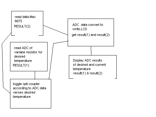

general idea of prg flow
now just need to figure out the spi.bas and how to use it.

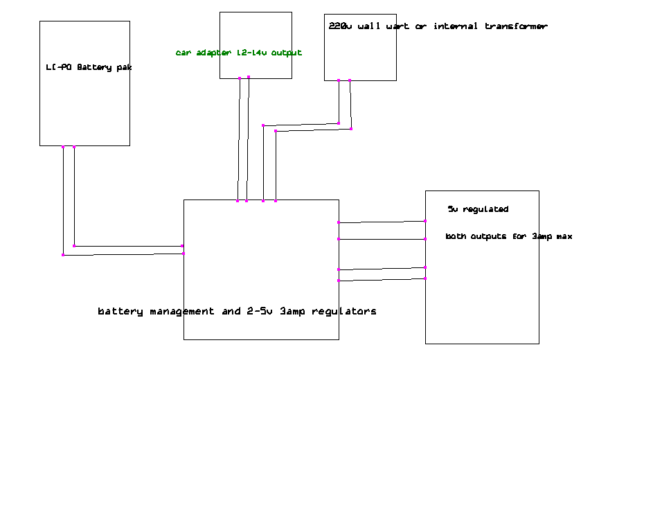

wrong diagram
hopefully this is right
Using the max6675 would be easy as pie. It dose all the work for you It's read only so it's just setting there wait to send out the temp
0*C is 00000000000 and 1024*C is 111111111111
schematic of proposed circuit
fairly easy layout
