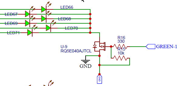

Well, I finally got back to this project and ran into code or mosfet issues.
using this schematic and this code I get more than one LED on. Only one is supposed to be on. Curious, do mosfets tend to bleed when off? ONLY row_1 colum_1 should be on but several other LEDs are on some are dim.

  • Schematic_smd-clock_2024-11-19.pdf

All of your mosfets are wired wrong. The body diode is always conducting even when the gate is low.
No. Your problem was noticed and explained before.
I don’t know exactly what part you're using, but it looks like you have the fet connected wrong... the body diode is always going to conduct. Check the source and drain connections.
Same problem now.
