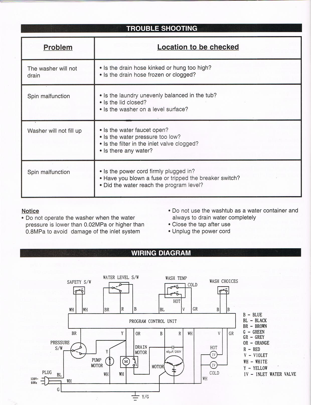

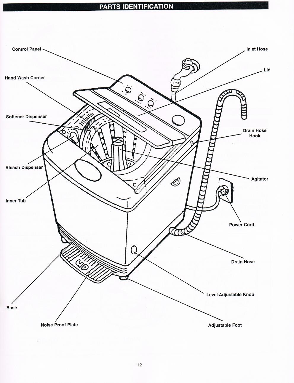

I got a schematic or so of a little one...check it.

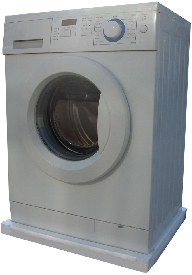

And if you asked for a "Washing Machine" in the UK, this is generally what you'd end up getting ......

oh okay. but can you help me explain from that circuit what added circuits or components might be needed to contrl this without the "program control unit" card (i havnt checked inside yet) but with plc. THeres like 10 inputs perhaps. some outputs.
That isn't a circuit, its a wiring diagram.
I won't go into detail with the circuits I used as they were PIC based and not PLC which is what you're asking for.
To control the speed of a motor its easier to just use a factory made VFD unit. most have 0 -10 volt inputs that translate that right to the programed frequency range.
