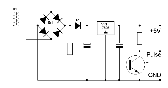

Yup zero crossing circuits is the way to go. It doesn't need to be a sinusoid, but you do need it to be periodic and you need to know how many times it crosses zero per cycle (though you don't need to know exactly where since it's probably spinning fast enough that you can probably wait until it's done a full rotation before getting the next speed update.

DIagram of interest from that thread courtesy of NIgel:
https://www.electro-tech-online.com/attachments/zero_cross-gif.10706/
You might not need a transformer if the AC voltage is low enough which it probably is. (you could probably just clamp it with diodes or something to keep the voltage within the limits of the diode rectifier and transistor. The regulator block is to power other circuits too if your engine is able to power other things and you want it to do so. Otherwise just remove it (VR1) along with the capacitors, and D1. If you used a NMOS transistor then you could just replace all the resistors with shorts (the top of the MOSFET needs to feed into whatever power supply the rest of your electonics is using still, in this case +5V from somewhere else.
Using the voltage to drive the base of a transistor, wouldn't this load the output?
I see the point in using the bridge rectifier and the transistor, but what is D1 for? Protecting against reverse current into the bridge from the input cap when disconnected from mains?
Also the high voltage from the ignition coil (40-100VAC) - wouldn't it fry the transistor?
I was thinking something like a high input impedance comparator with a clamping diode to substitute the transistor...
Edit: I just saw you edit now, and a MOSFET could also be used, thats right, with a clamping diode on the base. I've got high-voltage bridge-rectifiers, so I would probably place the clamp between the bridge and the MOSFET.
The other day I asked a question about driving a MOSFET gate from a PIC, and I ended up using a 100ohms series resistor - would this be nessasary in this case too?
More edit: Actually the MOSFET is not a good idea, since it has gate capacitance, a comparator would probably be better, or am I wrong?

THat's what the transformer is for. THis circuit was originally meant to be used to detect zero cross on a 115/230VAC mains in the first place.
It is capacitive true, but it's very small relative to your engine. Plus...think about what a comparator is made up of...a bunch of transistors. The resistor is to slow down how fast the MOSFET turns on (yes! it's gate capacitance is small enough that it often turns on too fast! that's how small the load is!) Since it's a signal transistor and not a power one, you can reduce the capacitance even more by choosing a tiny one that handles barely any current. You only need it to pass enough current between source-drain for to pull the output low.
CORRECTION: I realize I made a mistake earlier saying that you can remove all resistors if you use a MOSFET. You still need the resistor above the transistor since that pulls PULSE HI, and when the zero cross is detected the transistor turns on and pulls PULSE LO. You must have the base transistor if you use a NPN BJT. The gate resistor (the MOSFET's gate is the equivelant of the base on a BJT, different names), then it is optional. It's used to slow down how fast the transistor turns on. It's not required in this case since the currents being passed are so low.
EDIT: There is one situtation where you might want a comparator rather than a MOSFET. You say the voltage might vary from 40VAC-100VAC. If this is the case, you might not be able to use a transformer to step down 100VAC enough to protect all the other electronics while still being able to reach the NMOS's gate threshold voltage to turn it on when it happens to be at a minimum of 40VAC. The gate voltage can be 1.8V, 3.3V, 5V, or 10V, depending on the transistor but is often 5-10V. Then you'd want a comparator so you could step down the voltage a lot to step down 100VAC low enough but still be able to detect the even smaller signal when it was 40VAC.

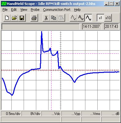

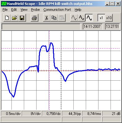

I have now tested the output, and I was wrong. The output can easily drive a 100ohm resistor without stopping the engine.
I also took my scope and made a few pictures of the "typical" sine-like output voltage (see below).
Now my problem is that it does not look that much like a sine, and the scope picture also changes randomly (higher peak voltage and changed "look" of the voltage curve).
So I'm trying to figure out how to read this but I'm kinda stuck.
Assuming the engine could run with a max of 30,000 rpm, there would be a voltage curve every 2ms and the "width" of this output will be a lot smaller than on the pictures. The voltage will also rise when rpm goes up.
The "abnormalities" of the output is also a problem.

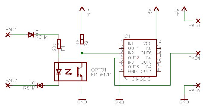

I would like to use an optocoupler to seperate the coil-voltage from the rest of the system (PIC ect.). I've got a few of these from Fairchild I would like to use:
https://www.fairchildsemi.com/pf/FO/FOD817D.html
See the schematic - this is how I was thinking of connecting it. The pads to the left is where the output voltage from the ignition coil will be applied. The output to the PIC is to the right.
Any ideas how I can read the output voltage spikes with the PIC?

When looking at the output voltage curve, perhaps it would be better to just read all the voltage spikes into the PIC, and then make the PIC decide whether the signal was a double or triple spike or it was 2 or 3 rounds.
The 0V pause/gap between the spikes is quite big, so this could help the PIC determine the rpms.
Feed it through a schmitt trigger or a comparator schmitt (so you can adjust the trigger point), this should give you a nice squarewave out.
Nigel, do you mean one square per round or a square for each "spike" above 12V?
The PIC should be able to read the output from the opto, but perhaps I need something with hysteresis since the PIC digital input pin have an undefined voltage area. Is it here you think a schmitt trigger will do the job?
By "schmitt trigger" you mean a comparator with hysteresis, right?
It's what schmitt triggers are made for!.
By making a schmitt round a comparator, you can adjust the actually slicing point as well!.
Nigel, I found a 74HC14 that I'll use.
If you look at my schematic, do I need 2 high voltage diodes (RS1M), one at each side of the opto emitter, or is 1 enough? The emitter can't handle the high reserve voltage from the coil and I'd rather use 1 or 2 rectifiers instead of 1 bridge rectifier - to simplify the output from the opto to the PIC.
One diode should be fine, putting two in series (which is what you're actually doing) doesn't make any useful difference.
