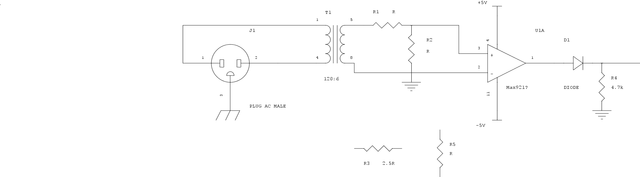

Merry Christmas! This circuit is supposed to detect a mains zero crossing so that a PIC can count them and use it as a timkeeping oscillator.
My thinking (since the rest of my circuit is isolated from the full mains voltage anyways) is that after the mini stepdown transformer it shouldn't be too dangerous to work with the signals. The transformer only steps down the voltage to 6Vrms and the comparator can only accept ~4V or so max so the resistive divider is supposed to reduce step down that voltage again. I can't seem to make the resistive divider symetrical (two m's?) since I need (or want to) ground one output terminal of the transformer (to the DC supply) so that the common mode voltage doesn't exceed the comparator input range. At the same time though, I want to connect the - terminal of the comparator to that same ground to use the "zero voltage" as the comparator's threshold, so I can't separate the bottom terminal of the comparator and transformer in any way (like a resistor to make the divider symmetrical). If I do it the way shown, both Rs have to be the same or the reduction will be lopsided. Can anyone think of a better approach (assume I can't get another transformer to step down the voltage more)?
If the output of the comparator is unipolar it's all good. But the diode and resistor is because I'm assuming the comparator is bipolar. The diode is to clamp out the negative voltage before it gets read into the microcontroller's "change of state interrupt" pin and the pulldown resistor is there to allow a LO to be signalled since the diode stops the comparator from outputting a low.
Does anyone see anything wrong or improvements for this circuit? Like currents from the transformer flowing into the rest of the DC system through the ground or anything like that?
Thanks.

Looks rather over complicated?, how about this, which is the normal way of doing it. The voltage regulator isn't anything to do with it, but would normally be there to feed the micro.

Wouldn't the voltage drop across the bridge rectifier diodes be too great if the transformer was outputting 6V? It would clamp down the rectified AC waveform enough so that the zero crossings aren't spaced apart very evenly anymore? That's the problem I was running into when using diodes so I was trying to avoid that.
I was also having a bit of trouble trying to decide what threshold to use for a rectified signal since there's only one instaneous point where it actually hits zero (if even that due to possible noise). That's the second reason I wasn't using a bridge diode.
Baseless concerns?
Baseless concerns?
Yes, baseless concerns - the simple circuit with the bridge gives a pulse starting just before zero-crossing and ending just after. It's simple to add a slight delay to exactly hit zero-crossing if you really want to, normally it would be done in the software.
dknguyen said:
Wouldn't the voltage drop across the bridge rectifier diodes be too great if the transformer was outputting 6V? ?
No, the transformer output would have to be at least 9 Volt peak in order for there to be enough voltage for the voltage reg. This is more than adequate to turn the transistor on.
dknguyen said:
It would clamp down the rectified AC waveform enough so that the zero crossings aren't spaced apart very evenly anymore? That's the problem I was running into when using diodes so I was trying to avoid that.?
I don't see why it would but it does not matter if it does. The average frequency output by the transistor will be 2F where F in the mains frequency. A few milliseconds of jitter won't matter.
dknguyen said:
I was also having a bit of trouble trying to decide what threshold to use for a rectified signal since there's only one instaneous point where it actually hits zero (if even that due to possible noise). That's the second reason I wasn't using a bridge diode.?
It does not matter what the threshold is. The threshold could be at say 3 Volt. All you need is a circuit that provides a pulse at 2F.
dknguyen said:
Baseless concerns?
Yes.
Oh wait, I get it. The two pulses don't have to be evenly spaced for it to work correctly. You get two pulses, that means one 1/60th second has passed, whether or not the pulses are spaced T/2 apart or if they microseconds apart. It just means you can't count in 1/120ths of a second...but who cares about that. I'm still thinking in terms of AC switching.
Plus I get to use a bridge rectifier! I dunno...I just like the way it works where the current travels along different paths but comes out the same way.
THanks.

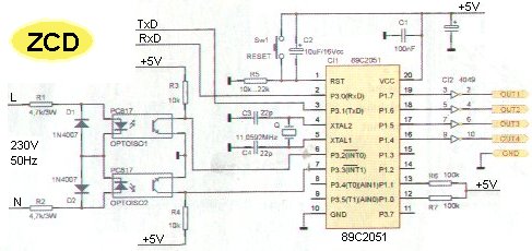

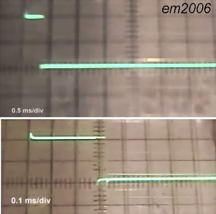

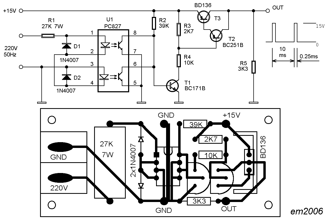

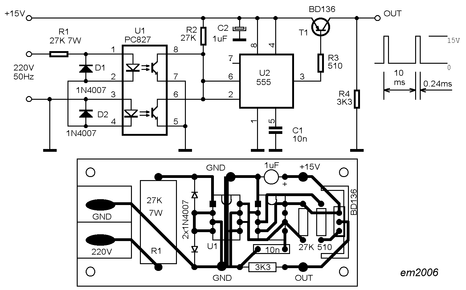

Another ideas for zero crossing detectors wich I made.
3 attached files:

Hmmm, that's really neat use of the diode rectifier and opto-isolator, and without the transformer I would think it would work at both 120V or 230V assuming the opto isolator is rated right Hmm.
In my country, the line voltage is 230V-50Hz.
The 120V line voltage is an advantage for this circuit,
because disipated power on resistor R1 is smaller.

By the way, em2006, those circuits seem more complex than you need. I'd use one H11AA (or similar) opto and Schmitt trigger into the PIC. You will still get both ZCs of a complete cycle.

I used schematics I have posted, for zero cross switching of triacs (I purchased a kit - Controll of the 8 triacs - wich did not had ZCD, and I needed to upgrade it).
I posted the schematics to suggest to choose the method of detecting zero crossing using opto-isolators (as an idea).
Of course, the schematics needs to be modified according to the new purpose.

The diodes D1 & D2 are not necessary, just connect the opto diodes in reverse parallel and they will protect each other.
Also, if you insert a mains rated capacitor in place of the resistor R2 (and reduce the value of R1) you will reduce the energy consumption since the cap does not consume energy.

The diodes D1 & D2 are not necessary, just connect the opto diodes in reverse parallel and they will protect each other..
I like this idea, it simplifies the circuit, but, the current will be double, increasing disipated power on the resistors.
I wanted to avoid the reactive components, to avoid a eventually alteration of phase (angle of phase difference). The phase is important, I want to detect the zero crossing of manins voltage.
It won't make any difference to the current consumption, one LED conducts when the current flows in one direction and the other LED conducts when the current flows in the oth direction; this is exactly what's happening in the circuit you posted anyway.
