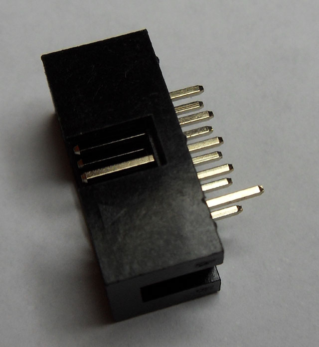

The 2x5 connectors pins might be too short to make good contact with the breadboard. There is a thread here somewhere about long pin extensions to a 2x5 header.

In addition, the pins may in fact be too small like you guys are saying. I was hoping that it wouldn't be the problem as it took me a while to get the connectors. I'll do a search for that pin extension Blueroom mentioned.
Yes that's correct in the photo. In hindsight it's probably the pins are too short for the breadboard.
In a pinch you try pushing the pins down 0.1" or so in the header to see if that makes a difference.

So, the program definitely recognizes the target power. However, I shaved off the little plastic dots (at the base of the connector) to try and buy myself an extra mm of pin length. But, even while applying a decent amount of pressure to the connector, I still get the same error as before when I go to program it. So, that means I most likely do need a pin extension.

What Bill is meaning is that you can pull (or push) the pins a Little so they make contact. In the attached picture I have pulled the corner pin out to illustrate.
Edit, I haven't tried this as I always solder on the headers.
I tried to take the pins out one by one with a pair of pliers, unfortunately some of the pins snapped since they are somewhat brittle. I hope only having a single pin in some of the columns doesn't affect anything. I do have a backup 10pin IDC connector, but I don't want to start ripping some of its pins out just yet. Anyway, here are a few screens of what I set up:
