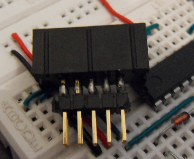

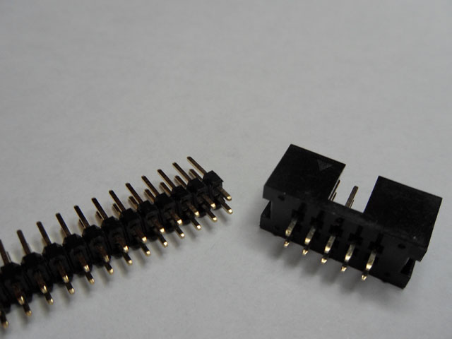

The socket pictured above is the same one that is in the Junebug with a header soldered on. Once it is connected properly selecting Pickit2 and the right device should find it. Attached is what I see when I am connecting to a 16F886.
Edit, for clarity I've attached a picture of the two parts that are soldered together.

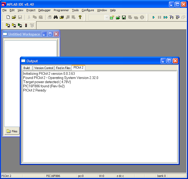

And, when I try connecting (program->connect) I get:
Found PICkit 2 - Operating System Version 2.32.0
PICkit 2 Unit ID = Junebug
Target power not detected - Powering from PICkit 2 ( 5.00V)
PKWarn0003: Unexpected device ID:  Please verify that a PIC18F4685 is correctly installed in the application.  (Expected ID = 0x2760, ID Read = 0x0)
PICkit 2 Ready

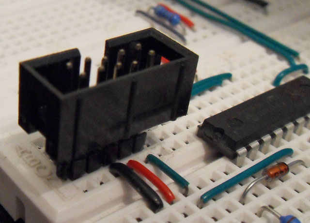

Alright I managed to get an IDC 10 pin socket connector for my bread board:
When I try to connect to it (programmer->connect) I receive the following lines in the output window:
PICkit 2 Ready
And, when I try to program it (programmer->program), the following displays in the output window:

I didn't solder the dual header as Pommie recommended, as I thought it wasn't necessary. Could this very well be a necessary addition?
If anyone can help me, it would be much appreciated, as I really want to start coding for my selected microcontroller. As always, thanks in advance.
