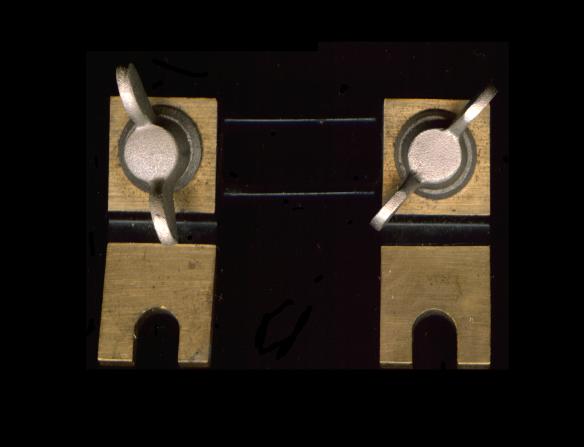

Hi Auriuman78,
Pure technically there's nothing wrong with Eric's explanation
but a 1mΩ 50W resistor will be impossible to find, you'll have
to look for a shunt. You'll find these in surplus stores or
at radio rallies. They will look like this 30A 30mV shunt.
on1aag.

hi on1aag,
As you say, buying one could be difficult.
The way we made very low shunts was using aluminium block or sheet.
Knowing the CSA and the coeff of resistance of the aluminium its possible to get close to the required resistance.
Drilled holes in the block for attaching the external leads, which have to be VERY heavy duty cables for 100/200A.
www.mpja.com
They have 10 through 100 amp shunts.for between 5-10 dollars or so. Shipping is reasonable and they have enough other good stuff it's a great site to buy from.
