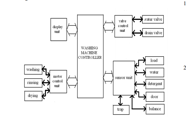

I've come across a washing machine with a damaged circuit board thats way to pricey to warrant replacement, so, I remembered a concept I had some years ago.
Is it possible, feasible or at least, worthwhile to completely bypass the circuitry of some machines and appliances with your own, and have it controlled with a commercial computer?
It's possible, but may not be feasible or worthwhile.
It will require a detailed knowledge of what the original board did, and then design a computer board with all the necessary interfaces, and write a program to perform all the functions.
Definitely not a small task.
Certainly possible, but more practical to do it with a micro-controller (which is what the original one will use, if it's any kind of 'modern' machine).
Either is certainly possible, but expect to spend a great deal of time and money doing it, considerably more than buying a new circuit board.

I did exactly this many years ago. It went rather viral and I was voted "Geek of the week" on Beta.com
To date, it was still one of the most challenging projects I've done, trying to control a drum full of unbalanced washing at a precise speed isn't as easy as you may think. I used a PIC18F1320 for the controller chatting to a PC via Serial. The PIC did the I/O and timing for the phase control of the motor and the PC held the main program and routines. It was affectionately nicknamed "The Frankenwasher" online and ran on "Winwash 2000" ......
I'd just about perfected the PID routines and got it running nicely when my wife came back with a new machine !
I think I remember that.
Do you really need precise speed to wash your stinkers!
I played around with a pid on a universal motor, a grinder, I found the input power response to be really non linear and difficult to control.
Think about 10kg+ of wet washing in a clump in the drum. Drive it up too fast and it will all clump then vibrate the machine to bits. Drive too slowly and it tumbles nicely but never balances or it will suddenly take off when the clothes all move at the same time. It was quite an experience getting it all correct.
I think the OP be better served reading this https://citeseerx.ist.psu.edu/viewdoc/download?doi=10.1.1.736.2729&rep=rep1&type=pdf
