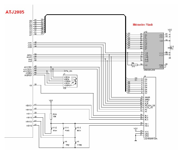

hi
can anybody explain me how to change a C Programm made for a CF, SD or MMC to a Programm for a kind of Flash memory using a parallel interface with the PIC (see the link below)?
https://forums.futura-sciences.com/attachment.php?attachmentid=44937&d=1208713440
thanks in advance.
Rq: I don't need a decoder or USB interface cause the ATJ2085 include them (the PIC 18F4525 will share with the ATJ2085* the use of the Flash memory (SAMSUNG k9f2G08U0M) in reading and writing)
* is a SoC (System On Chip) used in mp3 players

loup-garou said:
can anybody explain me how to change a C Programm made for a CF, SD or MMC to a Programm for a kind of Flash memory using a parallel interface with the PIC.
Not much similarity there. I would start from scratch and develop a program that met a set of written requirements which you need to write. The sooner you get cracking the better off your project will be.
