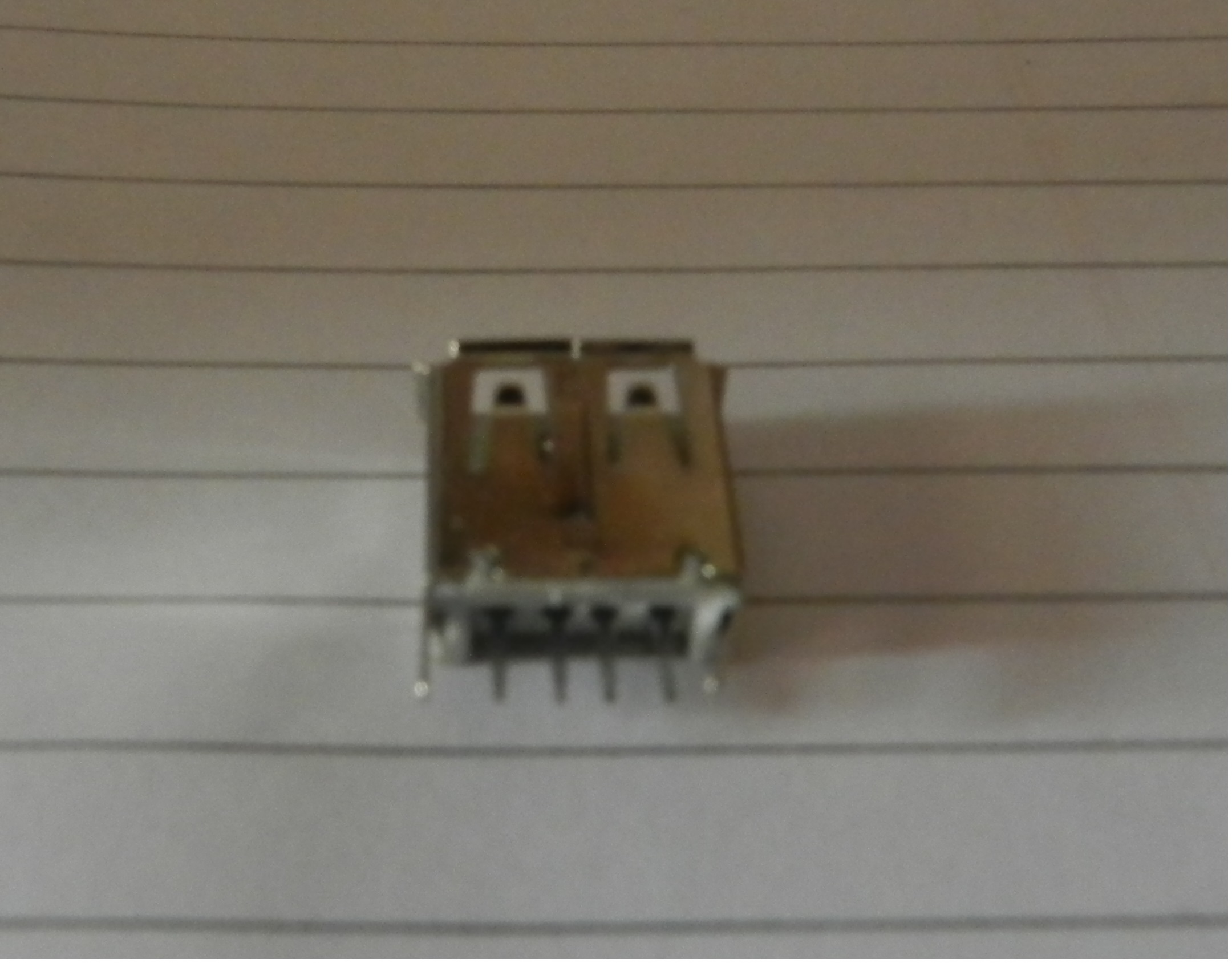

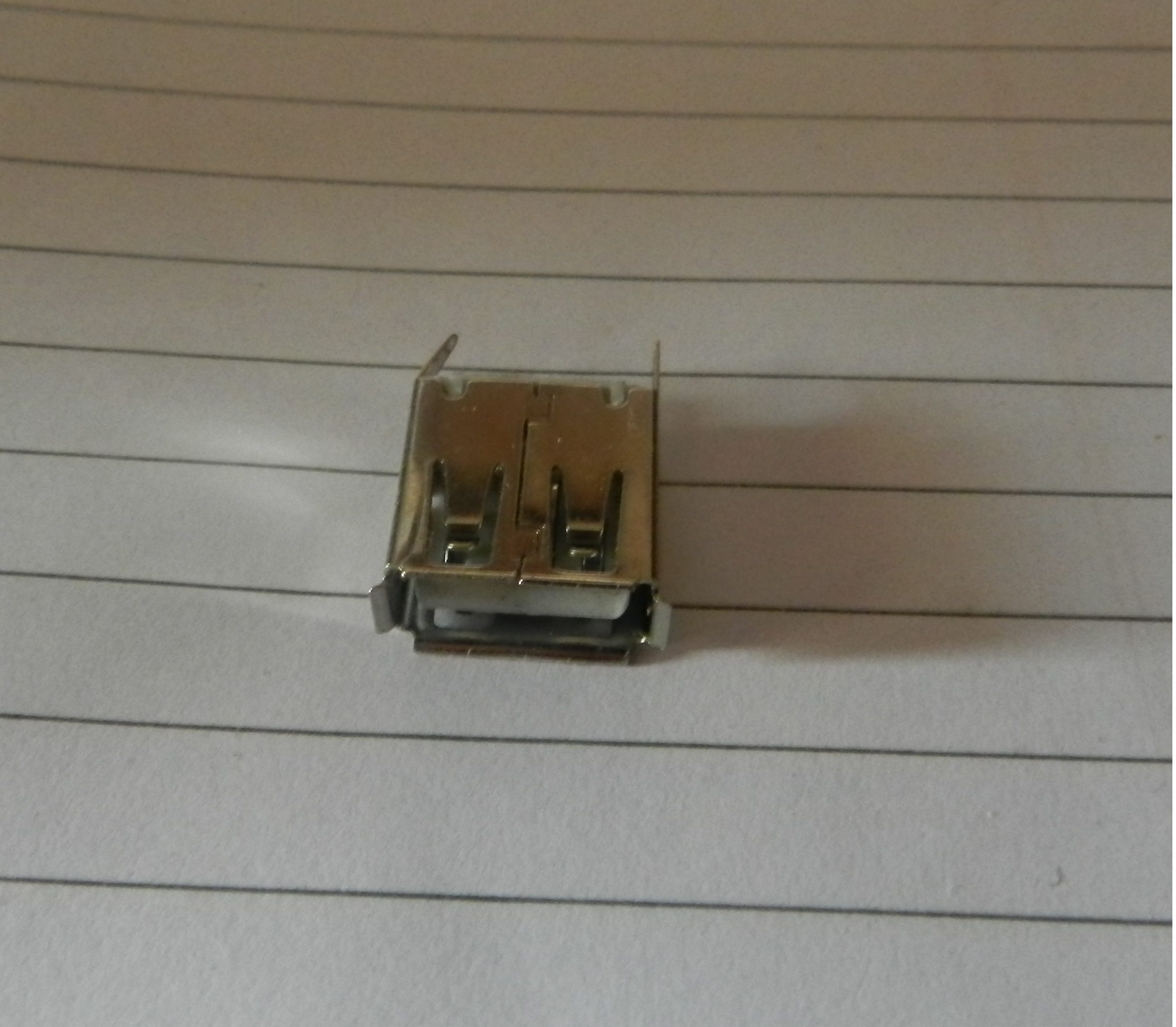

KeepItSimpleStupid You asked about the connectors so that I can connect my USB devices right? Or was there any other reason.
I have these handy. I have got 3 of such connectors. One for the USB keyboard and the other two for the two PCs. I also have two USB to USB wires so that I connect them to the PCs.
At first, I will try to switch the keyboard and then if successful I will switch the mouse as well by buying another 4PDT switch.

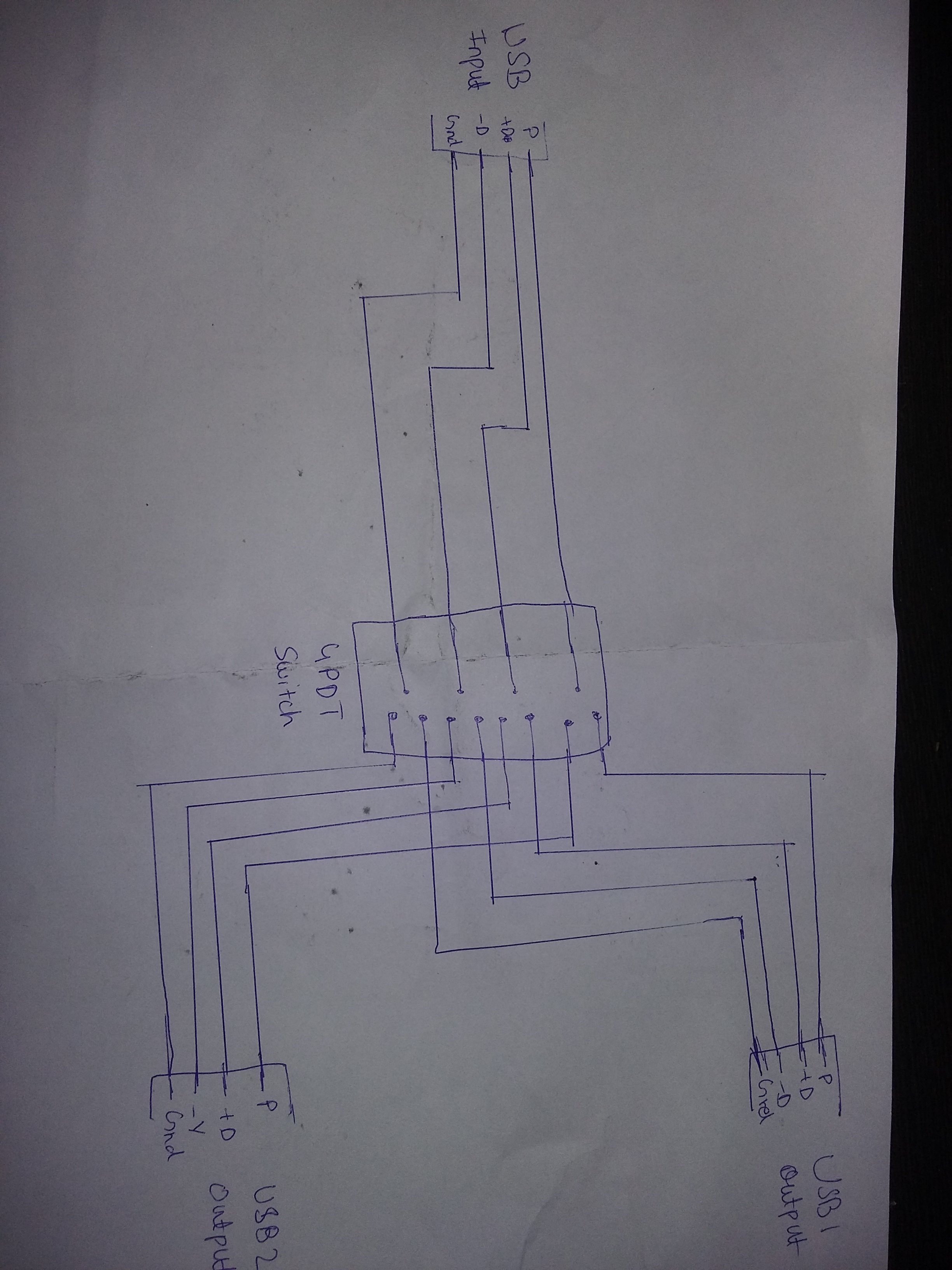

MrAl huh!! Well, I didn't know that. And nobody here seemed to about it either. It seems like it leaves me with using the 4PDT switch only.
How does this circuit look?
Well as long as you have one device being switched on with all four lines and the other device switching off with all four lines it should be just fine. You'll have to keep the wiring short probably. The problem i had in USB 2.0 was i needed at least 3 feet of wire before the switches so i had to modify a hub instead.

MrAl Yeah the switch I am looking at has an on-off-on functioning. So it should break the connection before making another one.
I didn't understand what you meant by this.
Also, did the common ground line make all the problems that you mentioned in your post # 45?
And yeah... I will keep posting my progress.
Thanks for the help.
The wiring to the switche(s) has to be short.
I dont think it was the common ground, just the wire length. Shorter wires worked.

MrAl This is probably a stupid question but shorter as in length, right? Also, why would it cause a problem?
dougy83 Yeah, I am going to be just using this switch for my keyboard and Mouse which operate on USB 2.0 so hopefully it won't be a problem.
What do you think of the circuit, though? Is it right? I was thinking of buying the parts today. So I need to add anything?

Yes shorter wires means each wire is shorter in length. You might get away with using a USB wire, but when i tried that for my devices (mostly USB thumb drives) it didnt make the connection when plugged in. That's when i turned to using a USB hub and wiring my switches right to the hub. That kept each wire less than 3 inches long as opposed to 3 feet long.
The wiring to this represents a transmission line. The transmission line has to carry signals back and forth over the length. The end impedances have to match or else there could be loss of signal or potentially damaging spikes. Because of the way wires translate to transmission lines in theory though is rather complicated so it is hard to predict what is gonig to work when there are so many variables like length, twisting or dual pair, etc. Antenna lines are like this too.
MrAl How did you wire your switches to the hub? Can you please include some pictures. Also, the circuit that I posted doesn't lack anything, right?
MrAlThis is probably a stupid question but shorter as in length, right? Also, why would it cause a problem?
Longer wires cause more signal reflection, noise reception, higher capacitance, etc. which degrade the signal integrity. It is more of an issue as the communication frequency increases. USB is specified at less than 5 metres (IIRC) between hubs/devices.
Your switch drawing looks correct (ignoring the V- in place of D-)
dougy83 My wires are around 3 feet long and a couple of inches inside the box that will house the switch. Also only keyboard and mouse will be used so signal reflection should not be a problem, right?
I would expect it would be fine.
