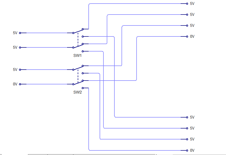

KeepItSimpleStupid Yeah I know but you see DPDT switches are costing me like 1$ for a pair. Also, they have a lower max current setting. I don't need like 5A of current right. At max I will be needing 250to300mA.
So I made temp circuit using two DPDT switches. How does this look?
