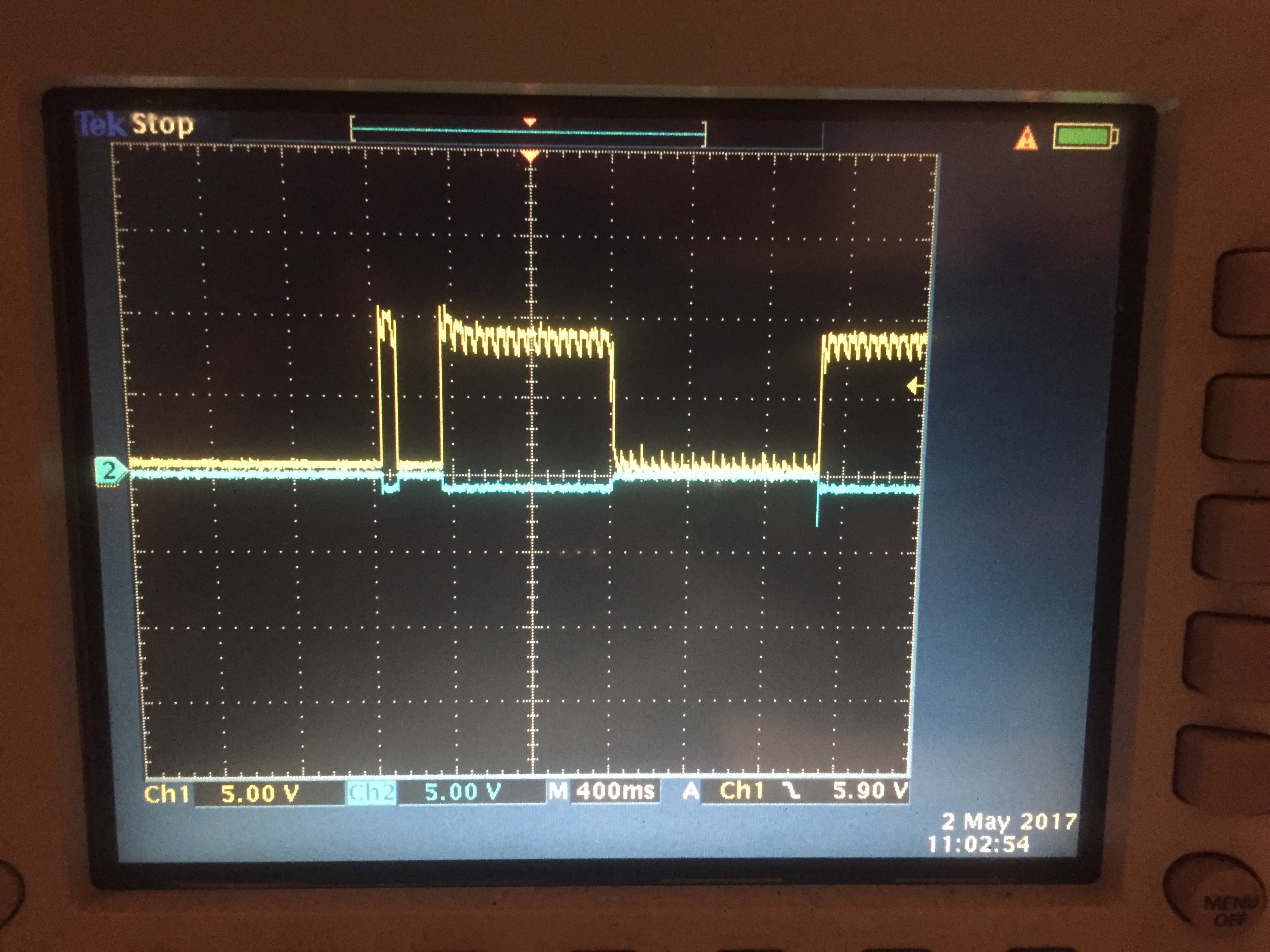

This is now more like it......
Signal A channel 1
1.2 sec System power Up
1.5 sec ignition on
2.4 sec 1st gear selected
3.3 sec neutral selected
Signal B - Channel 2
So am I correct in saying, I can ignore Signal B. Use Signal A to my ADC of my PIC (with relevant drop down, protection and smoothing) and I'll be able to read this voltage.
Would my PIC do the same as what the scope was doing when it was on the mains power? Do I still need to put a resistor across SigA and SigB?
Jason.
I am sure everyone here assumed you mean the negative signal wzs with reference to ground which is 0 volts.
That was my understanding too.
Since the signal you are interested in has only two "levels", why run it into the ADC? Just clean it up (lpf or Schmitt), and run it into a normal port pin and treat it as a 1 or 0.
A "floating" scope can give some strange effects, as you found out. A scope operated from the AC line is usually grounded (earthed?) through the third wire (green) in the AC power cord. A car parked on a cement slab will be weakly earthed through the carbon in its tires. The rule is always to connect the ground clip of the scope to the frame of the car when probing around in a car.

The signal I have been describing is from a Motorcycle engine CBR1000F. (Look at my Profile Picture - it's fitted to that beast) I totally agree, I didn't expect to see negative voltage but as decribed above it seemed to be a scope grounding issue.
I beleive the signal is from the original motorcycle wiring loom where the signal use to drive a indicator on the original motorcycle dash to indicate Neterual has been selected.
Thanks Mike. I could do but I'm still not entirely convinced that it doesn't change for other gears. I can only select 1st at the moment so going to use the signal going into an ADC and the output the ADC value whilst driving to finally fine out.
thanks for all your help.
