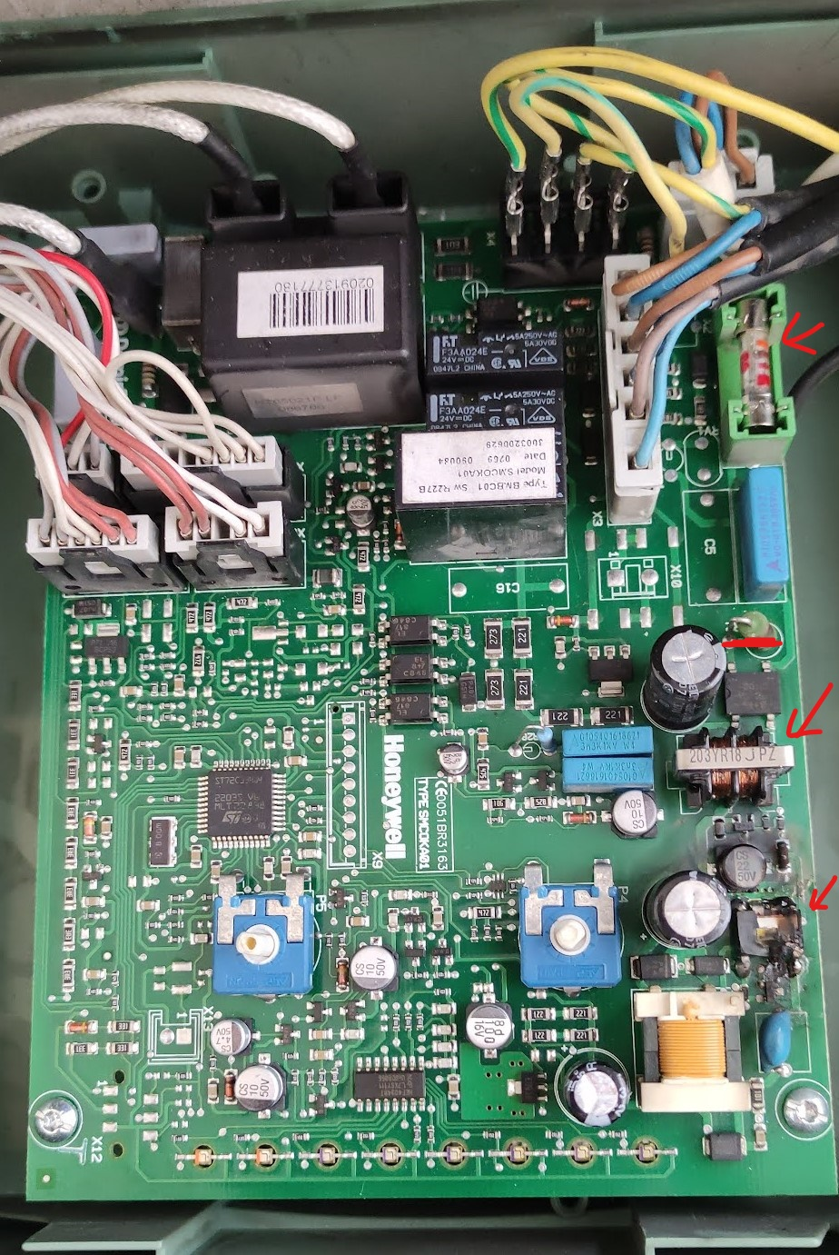

Tony Stewart Nigel Goodwin Bad news for me guys, it "popcorn-failed" again.
It only worked for 2 days. Yesterday night it failed. Very similar failure. This time since the surge resistor was shorted the fuse is blown (first arrow from top to bottom). The power switch was blown, again(third arrow from top); Nigel was right at his first impression.
Or maybe I made a mistake in swapping back (correct) ground and neutral?
Maybe the guy who did this saw the impedances of ground and neutral and by incorrectly wiring them, he somehow tried to prevent this kind of surges, eh? But wait a minute this does not make sense. The board looked clean it does not have history of these kind of failures.
Moreover, I think the secondary of the Flyback transformer (second arrow from top) also looks like melted and became an open circuit. (primary is measuring around 500-Ohm secondary is open circuit now). I
Correction: that one (center red arrow) is a common-mode suppression choke as rjenkinsgb pointed out.
The bottom orange wired transformer is the main Flyback transformer. It looks okay.
Resistances of orange transformer with an ohmmeter: ( I know this is not a perfect measure of inductance) 11-1.7 = 9.3 Ohms on primary 2.2-1.7=0.5 Ohms on secondary. ( Turn ratio ~ 5/93 ~ 5.4%) 220*sqrt(2)*5.7% = 16.8V so I guess this is a 12V? or 18V? regulator. That transformer has another winding (of resistance1 Ohm) on the primary side, I guess it uses this to get its feedback (probe-like action).

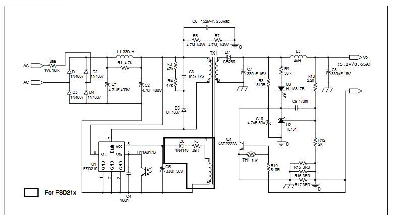

(Figure: My understanding of the flyback circuitry)

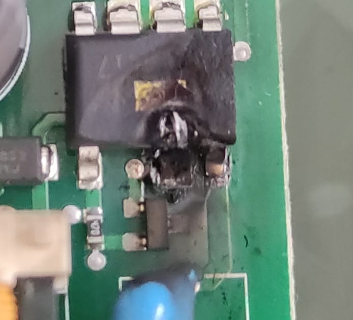

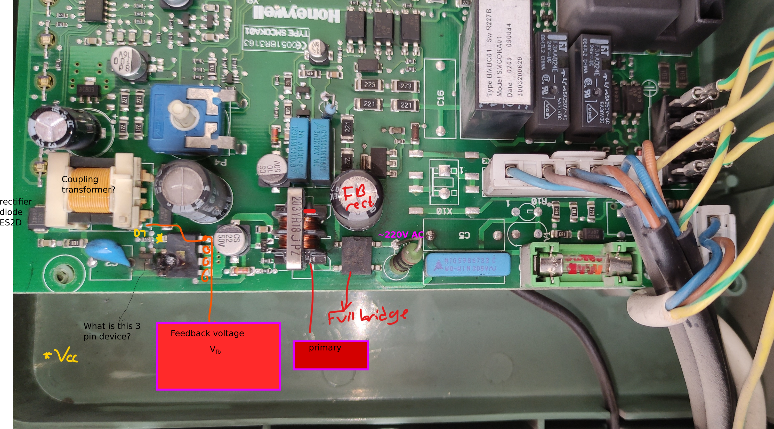

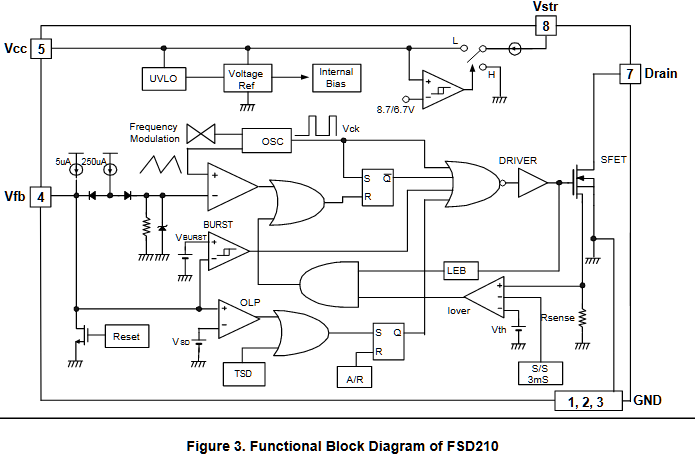

POST START: - Problem Statement -
After a long idling in spring and summer, at winter start, after a few hours of working, my mains heater stopped working.
12V Flyback regulator supplying the main board is busted. The thing did not show any sign of life.

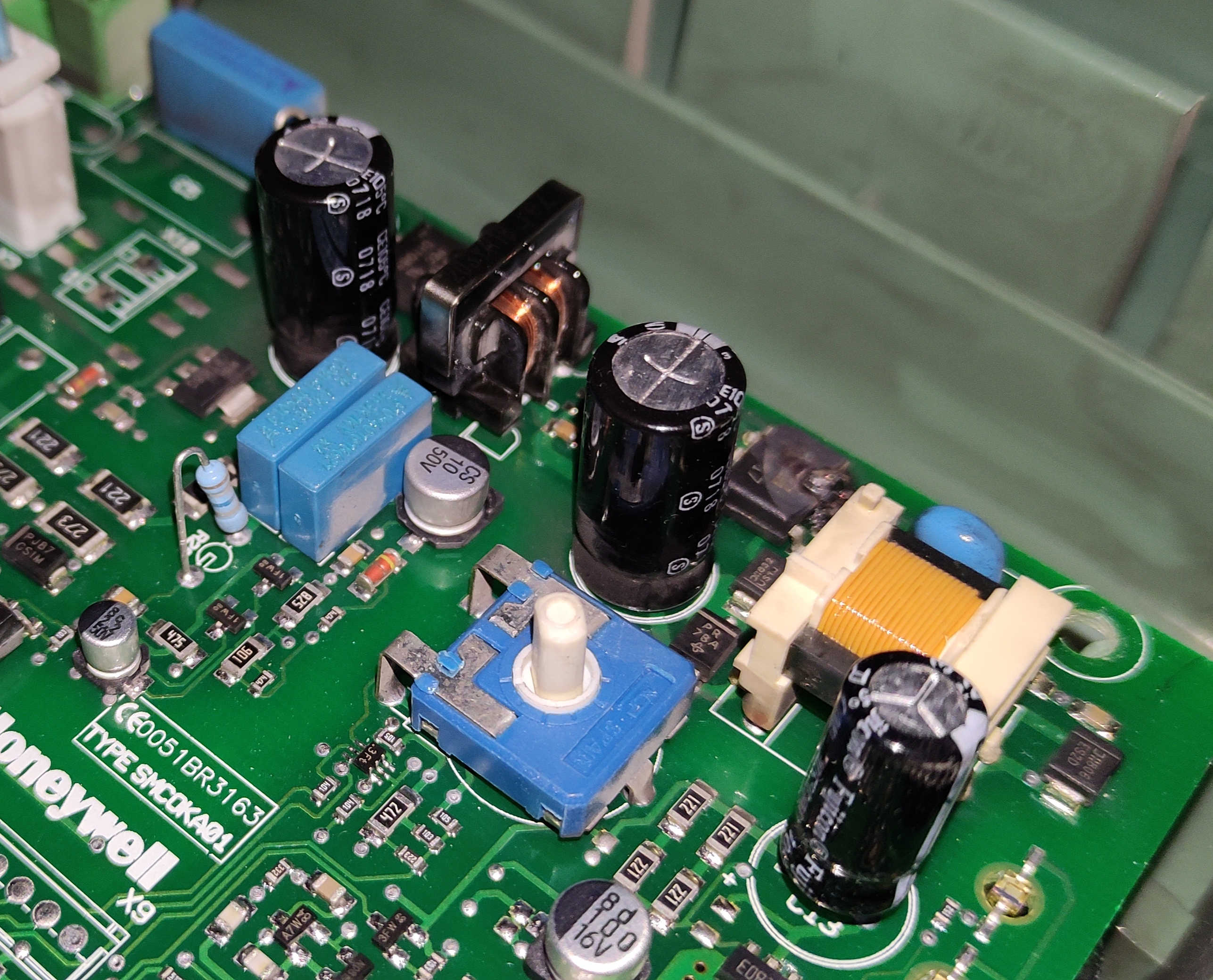

Below are some photos (that also show the close-up situation of the busted FSD210 switch - At first, I could not identify the part number of the switch, and looked at another revision of a similar Honeywell board that supplies the same line of products in my area

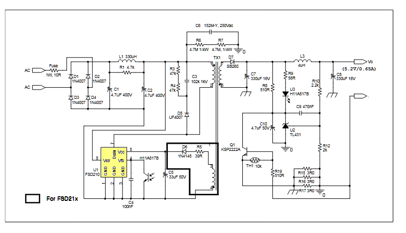

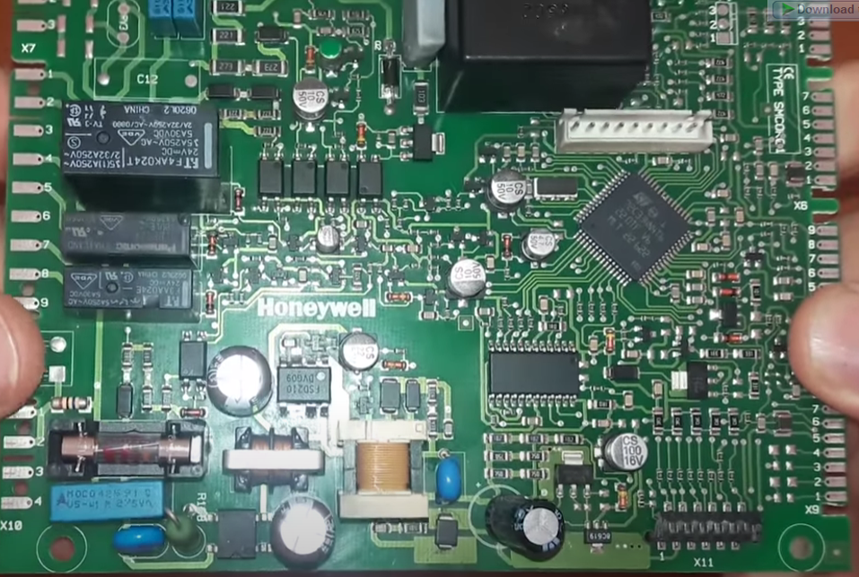

(Figure: Similar Honeywell board)

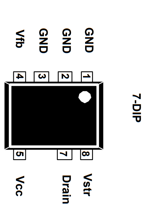

) https://pl-1.org/getproductfile.axd?id=8085&filename=FSD200.pdf

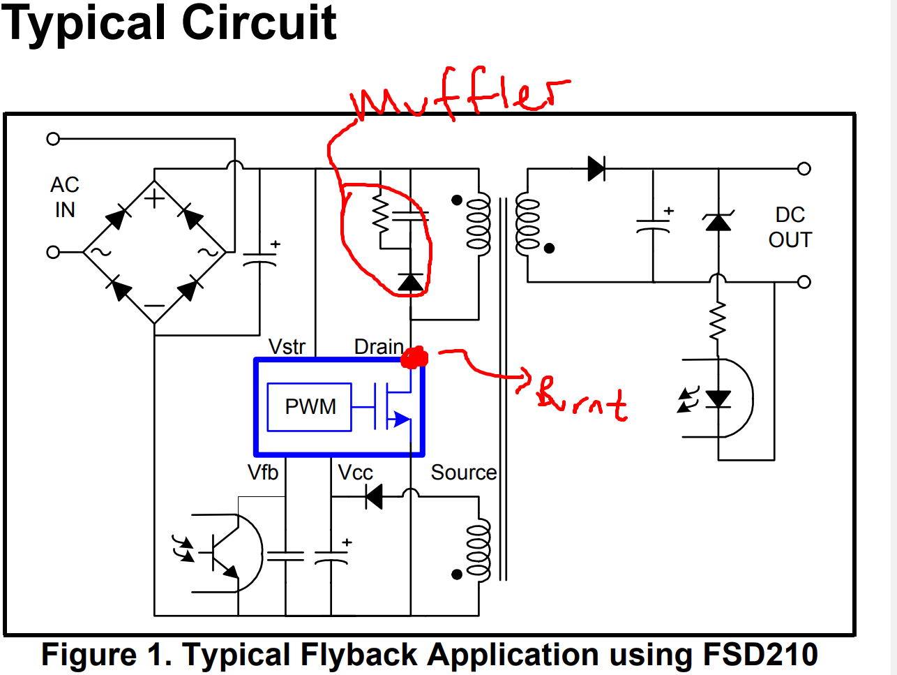

My question is what could have caused such a destructive heat in that area? The transistor has probably suffered a breakdown (probably because damping (muffler?) circuit did not do its job?) but why particularly now at first power-up after 7 months of idle state?
I am afraid the replacement part (FSD210) I ordered will immediately share the same fate (Or, will it?) , I want to identify the root cause of this problem.

(Figure: My Honeywell board's power switch - unidentifiable and only the FSD210 rf017 part's number characters '17' is visible, rest is burned out, I am guessing)
and Pinout ( same orientation) The side looking the Drain pin is completely destroyed.
It's almost absolutely certain that replacing just that device will not cure it, it's a safe bet it will blow instantly if you do.
You need to replace all other faulty components - and whatever 'might' have caused the problem.
It could have been a big mains spike? - but it's suspicious that it failed after not been used for a long period - electronics usually fail when you turn them ON or when you turn them OFF, leaving them running is most reliable.
As a minimum, check the ESR of any electrolytics in the PSU - if you don't have an ESR meter, them simply replace them - also check/replace any diodes or rectifiers. Also any resistors that might have been destroyed by the high currents.
I've repaired thousands of switch-mode PSU's over many decades, they can be an absolute nightmare.
As a professional engineer I used to create 'repair kits', so if a similar unit came in again I'd simply replace all the parts in the kit for that unit - and if I ever found another dead component in one of them, I'd add that to the kit for future use.
The bridge rectifier looks discoloured?
(The four pin device next to the other large capacitor, just above the failed IC).
The capacitor may have failed & caused the power IC get unsmoothed DC.
This explosive popcorn failure can occur with rapid overheating > 100'C with moisture ingress after a long summer. It is an SMPS IC with a built-in power NFET but we don't know if it failed on power-up , but I suspect it did. It is common for inrush power to greatly exceed the steady state load power, but isn't a huge thermal problem for transient startups. But this looks like it released much more energy that a 2W transient with a 200 mW steady loss. This looks like one of those shoot-thru failures for CMOS where the interface signals exceeded the logic rails.
Using an adjustable current limiting power supply, you can safely drive the output after it is cleaned up to look for a load fault. This is one of those "really simple" SMPS IC's that is likely obsolete or going that way. I didn't check if there was a soft start on this chip.
You may also need to check the active devices with a diode tester on any nearby semi's or inject 1mA AC thru a resistor and observe the waveform.

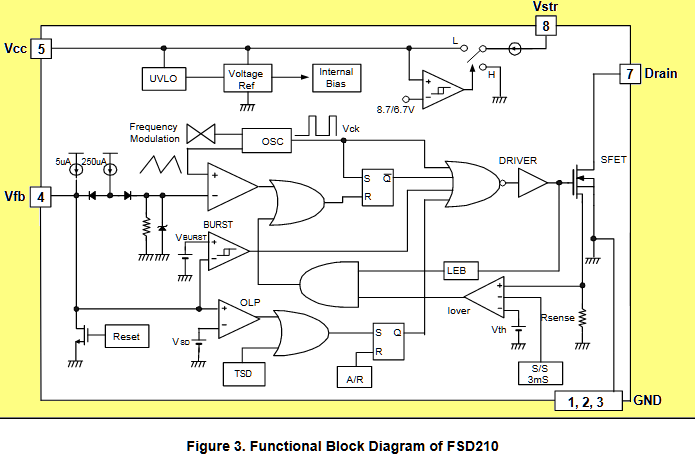

"This looks like one of those shoot-thru failures for CMOS where the interface signals exceeded the logic rails."​
Tony Stewart That failed part is the drain of the power mosfet, basically the switch . This is beyond logic level stuff already. In a flyback converter, that voltage jumps as high as 1000V without the muffler circuit (basically it is open circuiting an inductor like in a spark-plug of a car). But this one has its muffler intact. So it will limit it to probably a few 100V.
About one unlabeled (?) strange 3 pin component (the little one next to the pop-corn failure) I could not understand what its function is.
As far as also understand this board uses transformer feedback coupling, not optocouplers. I also tried to draw the isolation line below:
After you pointed that out I triple checked them and cleaned some dirt off it. They look similar. Seems it is okay.

Among those suspects, one ntc thermistor parallel series resistor (ptc-burn protection) the 220vrms AC line is mildly discoloured but it is still alive (not burnt out). ( it turns out, this is also burned down to high impedance (normally it should've been short))

Among those suspects, one ntc thermistor parallel to the 220vrms AC line is mildly discoloured but it is still alive (not burnt out).

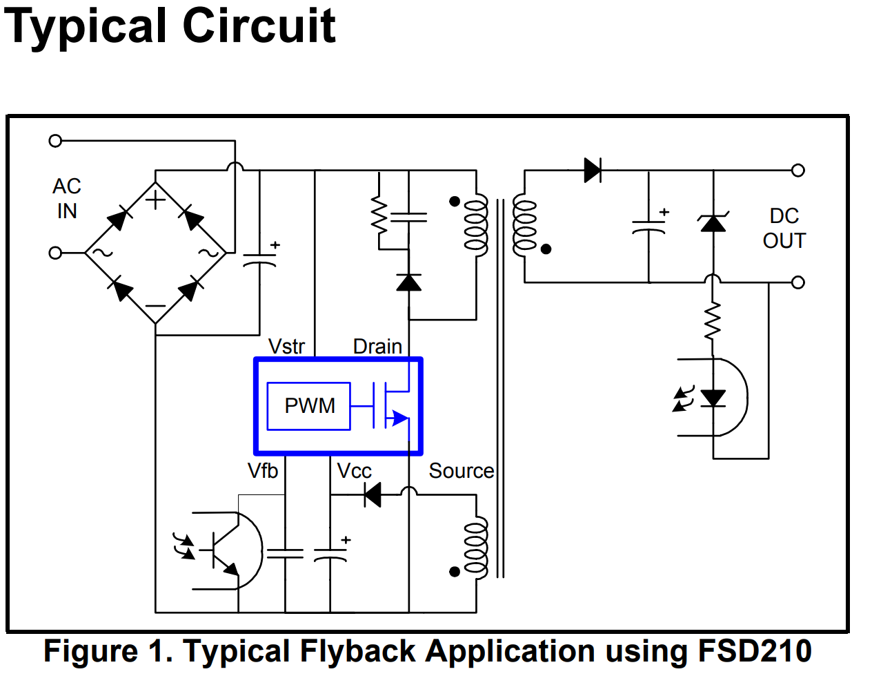

It will be difficult to isolate the root cause of an avalanche effect failure where SFET RdsOn is too high (I expect) to cause the detonation like a reversed Tantalum cap. considering all the internal protection to prevent a stuck ON FET.
I doubt your schematic will be much different from the one in the datasheet. Each active device ought to be tested for bipolar current properties at least or a pseudo-ICT if you have the chops and patience.
For a high-voltage breakdown from humid dust , I might consider 10% worst case of a clean breakdown voltage like 3kV/mm for air and ? V/mm for ionic surfaces but I would expect Honeywell to meet all std. design clearances around the transformer and you have to make your own determination guess around the insulation between pins 1 and 8

It will be difficult to isolate the root cause of an avalanche effect failure where SFET RdsOn is too high (I expect) to cause the detonation like a reversed Tantalum cap. considering all the internal protection to prevent a stuck ON FET. View attachment 138943
You're vastly over thinking this? - by FAR the most likely cause is simply a failed component (odds on electrolytics or diodes) which has caused the normal catastrophic failure of a SMPSU.
A far less likely reason would be a large mains spike - messing about considering breakdown voltages etc. would be above the odds of winning the lottery jackpot.
However - nice diagram, with values and references :D
Things to check/change U1,D1-D4, fuse 10ohm, C1 (C2), C5, C7, C8, D6,D7, C3 (if duff it will almost certainly have visible damage), TX1 (rare, but happens - shorted turns, O/C, or short between windings).

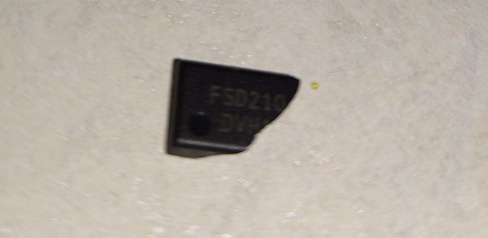

Figure: Tony Stewart It was really a popcorn explosion, lol. I found the cap of the package laying around the site of explosion.

Turns out, something inside that power switch ( like a tantalum capacitor) is explosive. That component is not shown on this functional block diagram. I guess the reason why this chip failed ( if not a stuck-ON fet) still remains a mystery.
