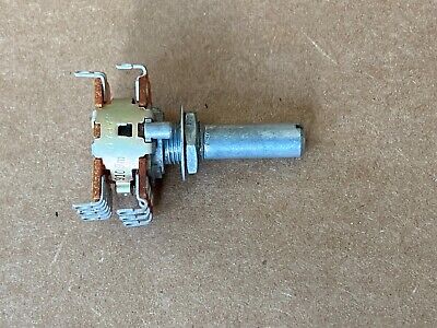

Can someone explain the potentiometer, R55, in the figure below. I only know about three terminal pots. It is ganged with an identical pot for the other audio channel and is the volume control for an OLD Grundig radio. I want to simulate the tone circuit but can't because I don't know the internal structure of a 5 terminal pot.

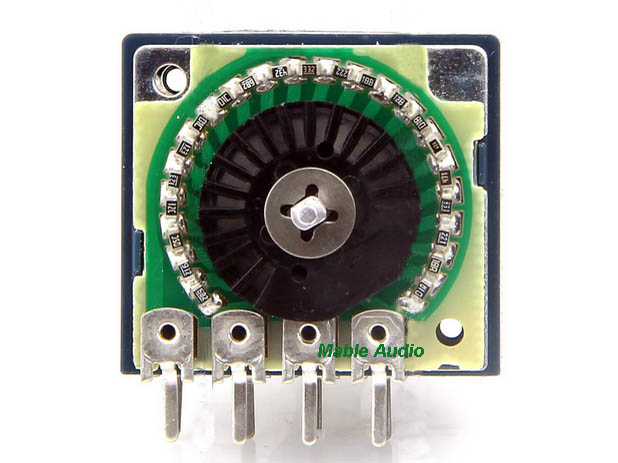

It's probably some version of a "Loudness" volume control - the commoner ones have a single fixed tap on the track as somewhere around 40% or so.
Some examples:
You should be able to simulate the effect using a fixed resistor divider to provide the taps, in parallel with a standard potentiometer for the volume output?
The effect is supposed to be to reduce bass (and sometimes treble) a bit less than midrange with the volume below a certain point, to compensate for hearing being more sensitive to midrange at low volumes.
As suggested, they are taps are for 'loudness' adjustment - but usually there's only one tap on the pot.
'rjenkinsgb' is unfortunately mistaken about simulating it using external fixed resistors, as it requires the slider of the pot to pickup filtered signals as it goes up and down, the external resistors don't provide this.

So, Nigel, would you have soldered the wires that went to the two taps, each connected to the nearest respective endpoints of the 3-terminal pot? Or just leave the tap connections disconnected? Or a combination of those two, depending on which tap? On this radio, the thing actually stills work, but I'm just curious.

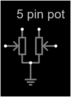

I'm guessing he's trying to show that a 5-terminal pot can also be made with two pots but the design ends up with two wipers and that's completely different from the 5-pin pot with one wiper in the OPs schematic so you shouldn't do that? Maybe?
Is the volume control built using a single resistance element with fixed taps to the resistance element near each end, or are there separate resistance elements for the taps and a shared wiper. Of course, I'm only talking about one of the two gangs, here.
The pot shown in post #6 is just a stereo volume pot using a shared ground pin for the two pots, presumably to give it a smaller footprint. The sort of thing you get in car radios.

Interestingly, the Alps RH27 type I linked to above is a resistor chain based "pot" so it could be possible to add other taps to it??
If you knew where the taps were :D
Although I suppose you could measure the resistance from the taps to the ends etc.

I just thought of something, although the original schematic was hard to read and clipped.
It doesn't give me any useful filter shapes but the pot arrangement is easy to make with 2 ganged wipers in a 5 pin pot.
But if I move the 22k to some high impedance bias, then it behaves like I expect it should going from treble boost to cut with bass boost in one full turn. How slick is that?
