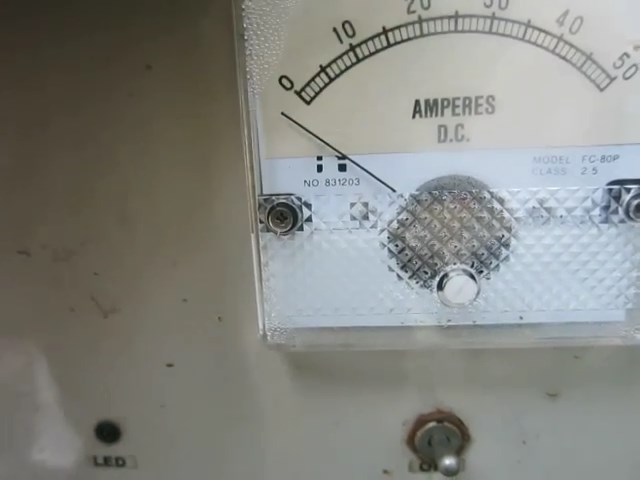

I received a gift of a nice old forklift battery charger, It got wet outside in the rain.
I observed the ammeter needle move when I touched the front , played around a bit & got inconsistent but repeatable needle movement & it would even hold a position, (doesnt seem like sticky pivot) .
There would be high humidity inside the meter as there is h2o condensate visible inside the meter front.
___ Strange.
After dry out it no longer reacts to touch.
Video attached

I have seen this effect before, on several meters, each completely different form each other.
I believe that the effect is due to electrostatic charging of the meter "window".
yes, electrostatic induction. the plastic (or on older meters, glass) acts as a dielectric, which charges up if you touch it with a static charge on your finger the charge inside acts on the needle and makes it move.

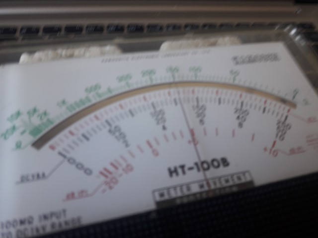

Brushing my Kamoden HT-100B (bought it 45 ++ years ago), got this. Just by touching it with the palm of the other hand, it went to zero. A dry day here.
