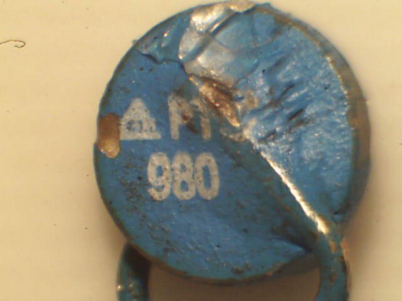

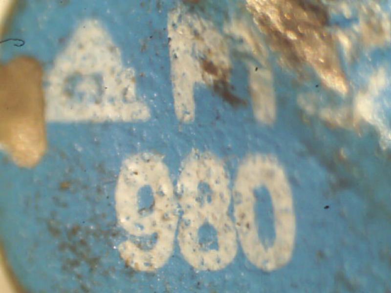

I dont know enough to properly identify this part. Just by looking at it can someone determine what it is or do I need to use a multimeter? There are six and I believe the three letters are "PTC". I put the part under a scope to get a nice picture. Any help is greatly appreciated!
-Jared

It is a Positive Temperature Thermistor.
But What actual Value, that another question.
Does it Still Measure a Resistance?
Does it Change Resistance with Temerature?
Yes, it's most probably a positive temperature coefficient thermistor - what is it out of?.

All thermistors have the same resistance of 25hm: at room temperature. I applied a heat gun and the resistance jumped to around 55hm: within 3-4 seconds. I got the thermistor to around 250-300 degrees F. Thank you for the help.
The thermistor is out of an old Balluff Encoder that supplies commutation for a servo motor in a CNC machine. There are six commutation channels, each one having this part.

It's probably used for overcurrent protection. When too much current flows the reistance increases dues to I²R heating until only a small current flows.
