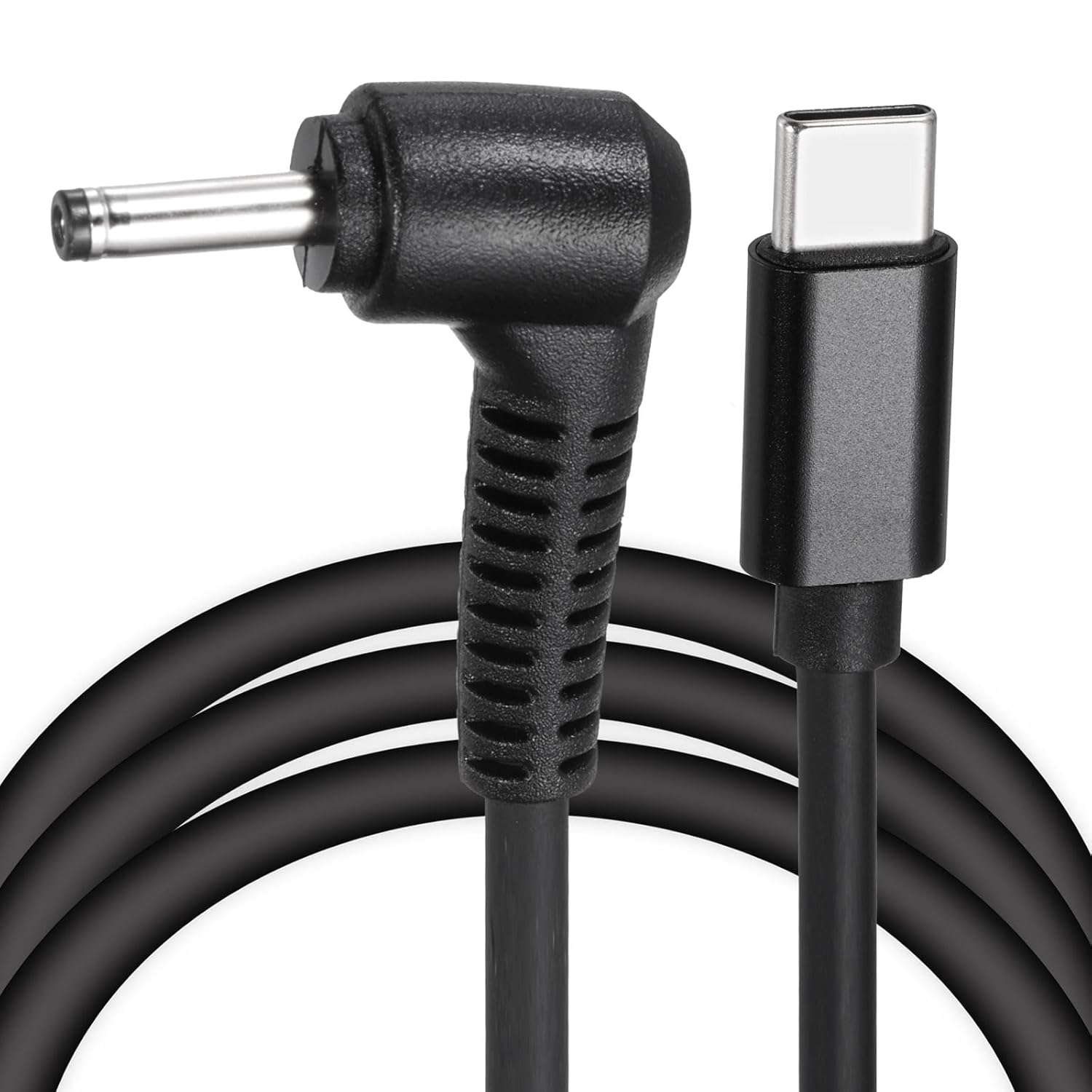

So I should buy a suitable cable. Do you think this is good? It costs 15.74 euros.
Is it able to charge the battery of my Zenbook laptop.
Conductor: 24 AWG.
Cable diameter: 4 mm.
Maximum current support: 3A;
Voltage: 12 V.
Maximum wattage: 65 W.
I read this:
sourcing map USB C to DC PD Fast Charging Cable, 3.5mm x 1.35mm, 65W/12V DC, 3A Jack Adapter Converter Adapter for Router, Camera, TV Box, Desk Lamp.
EDIT: The original charger has these specs: Asus Zenbook UX331FN Series 19V 3.42A 65W 4.0 x 1.35mmDoes it still charge if I put a 12V cable in it?
Very unlikely.
For charging, in general 9V or 20V chargers are for four cell batteries, 15 - 16V for three cell, 9 or 12V for 2 cell & 5V for one cell.
Each cell reaches about 4.2V at full charge, and some overhead is required for the charge control circuitry etc.
Try searching for "20V PD to laptop DC cable" and find one that has the correct connector for the laptop?
I can't figure out if this is the right one. The connector must be DC4.0 x 1.35 mm.Unfortunately there are no other cables. Maybe this is the right one:
