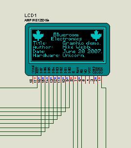

Experimenting with you KS0108 GLCD code with limited success. I can properly simulate you example on Proteus and works like a charm. But when hardwired it fails and I can not get anything to display. Using ICSP and programming the PIC I will get some semblence of the display to work, but when the project is powered off/on nothing is displayed. I suspect the KS0108 is not initializing properly. Have experimented with adding various delays etc, but still no luck. The GLCD is fine as I have experimented displaying using other project code with success, just can not get you example to work. Any suggestions??

Hi bryan,
The only thing that would stop it working is if the defines in LCD.h were wrong or you don't have a crystal. I'm assuming you are using the code from this thread. If you have earlier code then you need to change Init_GLCD in GLCD.c. You should also try switching to the internal oscillator - see page two of above thread.
