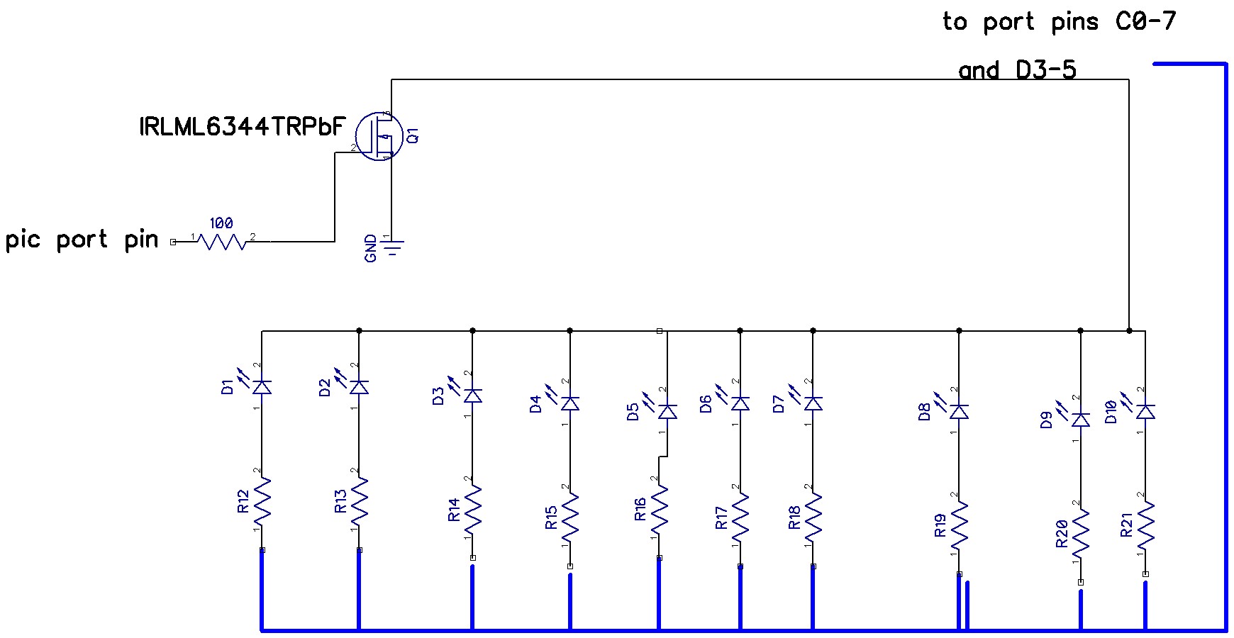

Well back at this project. Have an assembled circuit that needs to be tested but thinking of adding a mosfet or transistor to enable the cathodes of all ten leds.
REASON for considering adding a mosfet or transistor is to pulse (ON/OFF) the enabled leds (each led is 10ma so maximum is 100ma). Toggling after each port scann with a 100ms delay.This should extend battery life. Thought about going with PWM but want to keep things simple.
Any thoughts on my direction?? Yes I need to remove un-nessary code as suggested.
Using three AA batteries for power and an 18lf4520 pic. So a AA battery has 2000mah dividing in half for redundancy so 1000mah thus the batteries would last 7 hours at 100ma current draw. I realize these figures are extreme but why not plan for worst case. I may be wrong in my calculations but ??
Thus my reasoning for toggeling the leds, save on current consumption hopefully.

I *think* what you're saying is that you want to pulse the LEDs at higher currents to save battery power?
Sorry, multiplexing doesn't work that way. The purpose of multiplexing is to save on the number of connections and port pins.
An LED driven at 10mA will appear exactly the same brightness as one driven at 100mA with a 10% duty cycle. The average current determines the perceived brightness.
As I understand it, if I pulse the leds (10 ma current draw) with an ON time of 500ms and OFF at 500ms the total current draw over a given time span is cut in half since the led is on only half the time compared to on constantly.
Is this not correct??It is a crude method of reducing amount of battery drain as I understand it using POV
oups here is my basic schematic
That is correct. And the apparent brightness is reduced by half as well.
You can accomplish the same thing by driving the LED at 5mA full time.
Brightness is proportional to average current.
10mA × 100% duty cycle = 20mA × 50% duty cycle = 100mA × 10% duty cycle.

Having nt much experience using mosfets am uunder the impression that a 100 ohm resistor on the gate should be sufficient for this application. Read that somewhere during researching using mosfets.
So run them at lower current to start with.
Make an experiment - test 5mA on 100% of the time next to the exact same type of LED on at 10mA 50% of the time.

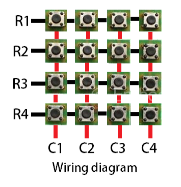

You DON'T need 20 pins! You could set up your switches as a 2x5 matrix.
I thought of using a matrix but then it would involve using the ADC feature on the pic plus a bunch of resistors to form a ladder of resistors assuming this was your idea??
Having to re do my code as the port assignments are different. Have switches on two different ports as well as the leds.
Still trying to figure out how to use all the switches into a 16 bit variable as suggested n post #13
I think you would have a tough time implementing a matrix keypad but the linked article shows the idea pretty clearly.
In your case, you could have a 5 x 2 matrix using 7 Port pins. Trading the number of Port pins vs code complexity isn't a good idea for you.

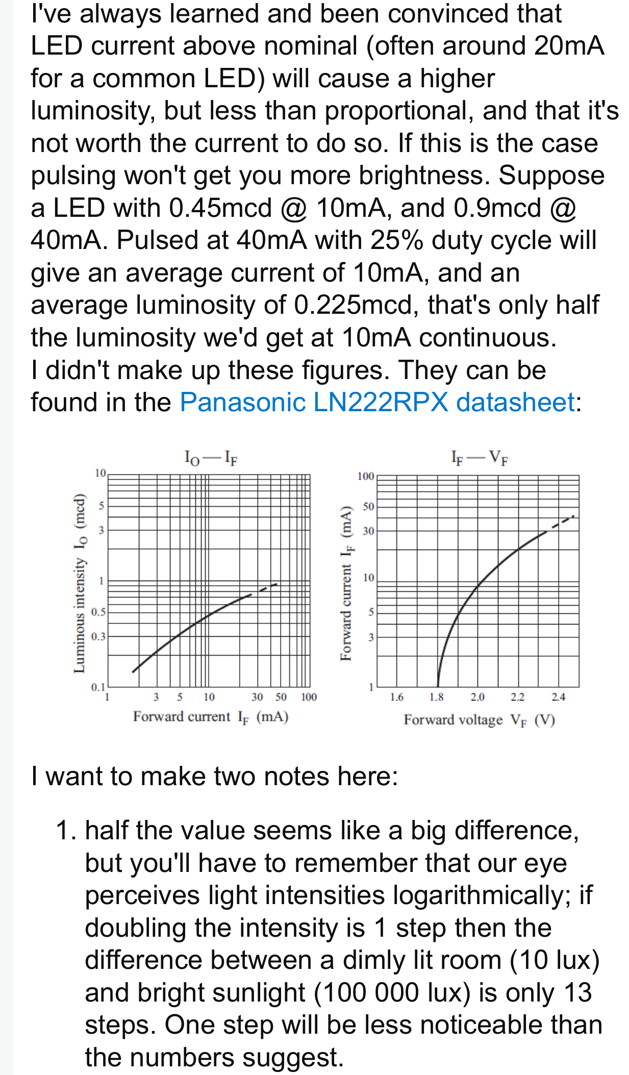

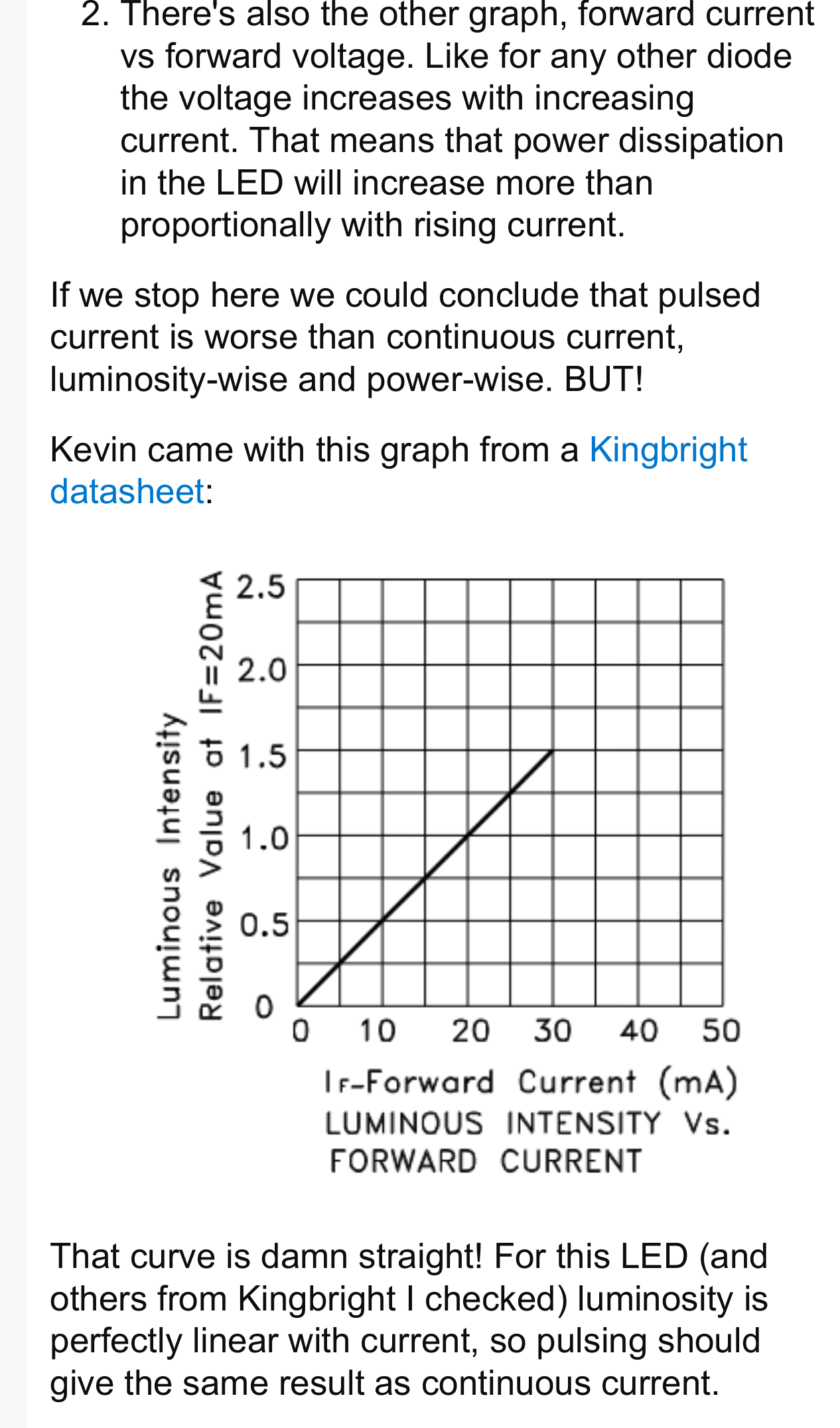

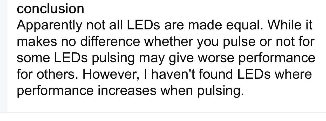

The above paper concerns high power LEDs, not the indicator type LEDs we are concerned with here.
From a Stack Exchange discussion, Olin makes a reasonable case that low power LEDs do not exhibit apparent increased brightness when driven at higher currents using PWM. If there is any effect of increased brightness the amount is so insignificant as not to justify the additional effort here.

You also didn't understand a switch matrix. I provided an illustration and a link to a clear explanation...not that I think you should do it, just in case you wanted to understand.
