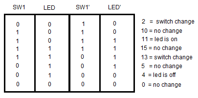

The other way is to create a state machine
dim condition as byte
condition = 0
if switch then condition = 1
if led then condition = condition + 2
debounce!!!
if condition = 1 then LED = off
if condition = 3 then LED = on
if you create an old and new combination then debouncing isn't necessary..
loop
  condition = condition * 4 ' shift two to the left
  condition = condition and 12  ' mask the old condition
  if switch then condition = 1  ' add new switch
  if led then condition = condition + 2  ' add new led
'now we have
  if condition = 2 then LED = on
  if condition = 13 then LED = off

I went back and reread Ians post #5 and started as an experiment using an index counter.
LED = 1 then index = 1
if swt = 0 then index = 0
continue on if index = 1 then the LED is enabled. Add in the swt so if index = 2 then the led AND the swt are enabled
basically generate a truth table
INDEX = 0 (both led and swt are off
INDEX = 1 (swt is closed and Led is off
INDEX = 2 (Led on and swt is open
INDEX = 3 (Led on and swt is closed(on)
maybe not correct but along those lines of thought.
