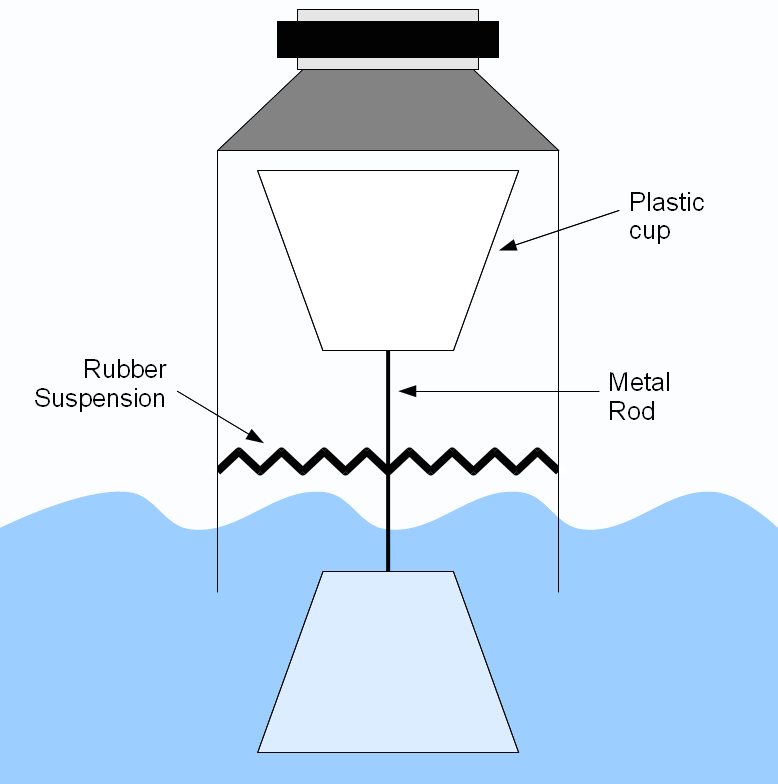

I have another idea, the schematic should explain all.
You might need more than one rubber suspension if the rod is long.

Hero, I can't see how that schematic is practical at all. You're still going to have the impedance mismatch, you're just adding a secondary impedance mismatch (the rod) to the equation.
Have you tried it?
I know that using a couple of cups and a piece of string seems to work well enough and a steel is a better conductor of sound than cotton so it should be better.
Hero, I didn't say it wouldn't work, it won't work well, and it's totally impractical for a real world device.

I made a mistake in my diagram above, the cup in the water should be a low smaller than the one in the air because it will loose it's energy much more easily to the water.
