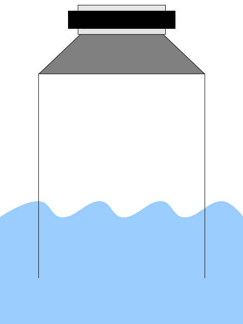

What about using a piece of pipe to couple the sound to the water and have the speaker out of the water?
You'll probably still need to use a Mylar conned speaker, as the high humidity might ruin a paper cone but at least you won't have to worry about insulating the electrical connections.
If a speaker with a pipe into water worked, sounds over the surface would be heard underwater. It does not happen.
The transducer element has to be submerged.
No.
A pipe will improve the impedance matching between the cone and the water so the sound will be transferred to it more efficient.

Hero while you're right so is Externet, a speaker in a sealed PVC pipe would waste most of it's energy as the energy reflected off the PVC pipe many times, basically ending up as minuscule heating in the plastic, some sound would transfer through the PVC pipe but you'd need a flexible membrane in direct contact with the water moving to transfer sound efficiently. So it really goes to asking what you consider an under water speaker, one that works, or one that works well =-)

I don't see how much of the energy could be reflected or lost inside the PVC pipe, maybe higher frequencies could be reflected back and fourth between the speaker's cone and the water's surface, if the impedance isn't well matched but I don't see how significant amounts of energy could be wasted inside the pipe, especially if it's kept as short as possible.
It is impossible to match the impedance, you're talking about a water to air boundry layer, most of the sound of any frequency will bounce right off the water, it can't just seamlessly pass through that great a density change, the tendency is going to be reflecting off the denser layer. This can be easily proven by showing how well sound travels when the air and water temperature conditions over a still lake are juuuuuuust right an area thermal difference in the bulk air and the air right next to the water form a waveguide, and that's just with thermal density differences in open air, what you're talking about is a liquid to gaseous boundary layer. You'll get almost total reflection. Doubt me? Submerge yourself in water and have someone standing right next to you scream as loud as they possibly can (with their upper body out of the water) You'll barelly hear a thing because there's an air column still in your ear that meets with the water, and an air cavity at the surface of the water to the person yelling.
Make no mistake about it, it will work, but you'll get really attenuated audio with horrible peaks and valleys.
