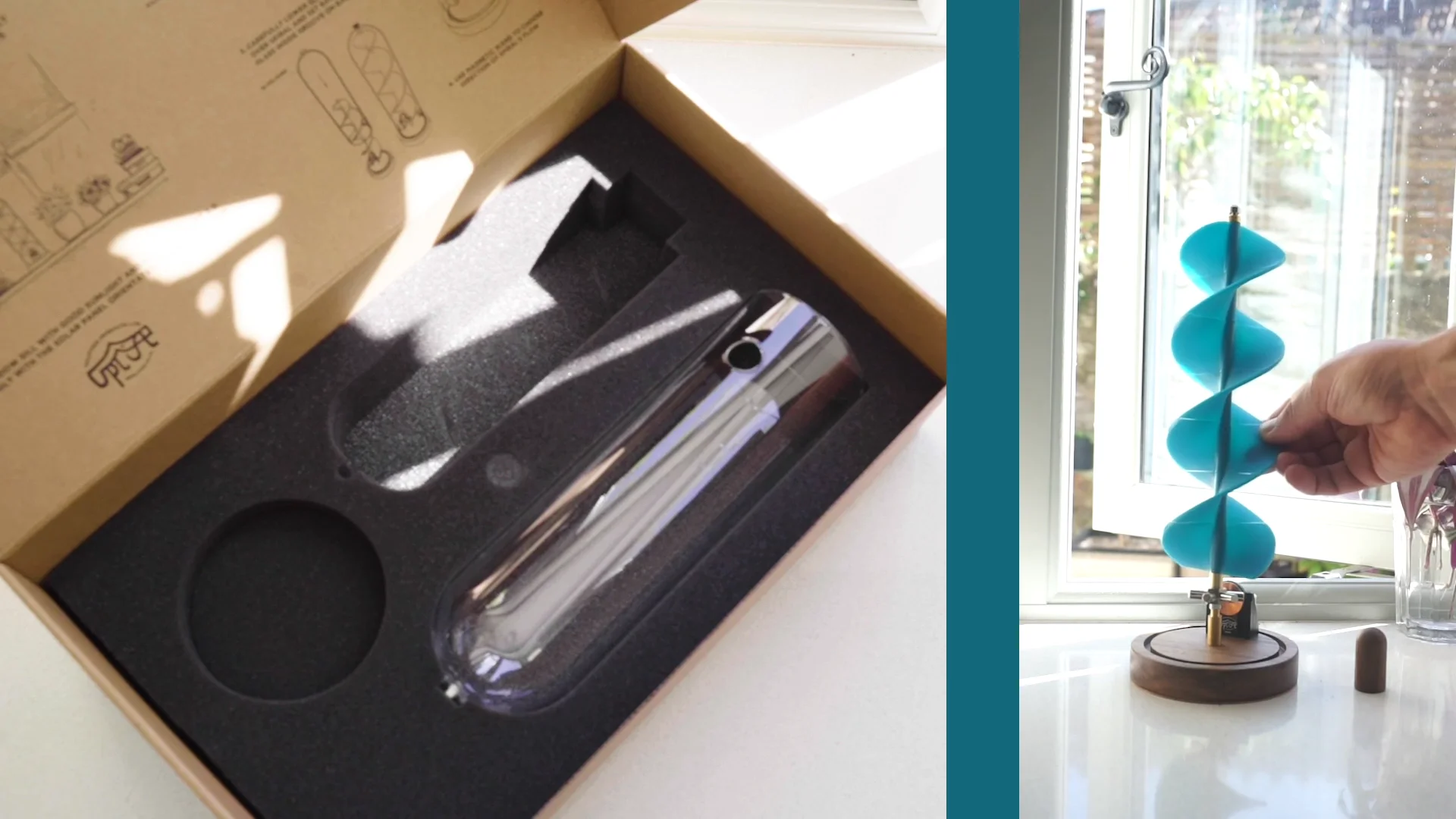

First of all this is not a spam ._., second I want to build this for my friend and I don't understand the physics behind it or how I will build it, how does the magnet interact with the copper thing? How does the physics work here, if anyone can guide me through it, or point me to relevant materials so I can do it myself, that would be helpful thank you
It has a solar cell for power (photovoltaic or "PV" cell) for power.
The motor uses a solenoid type coil and I'd guess a hall effect sensor controlling a transistor, so it can give a brief current pulse just as one of the magnets sticking out from the rotor gets to the best position near the coil pole to give it a kick around.
The loose magnet with the machine could be used to pull the rotor around initially, to set it moving.

Diver300 , I found another video, where it seems like the copper part is also rotating.
At 00:38, the copper things looks like it is rotating.
Nevermind it isn't
