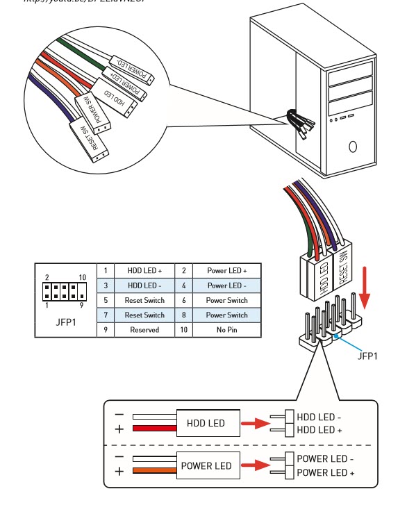

LEDs are usually on a computer case and connect to pins on the motherboard. There is a standard set of pins on the motherboard and a standard set of wires with connectors on cases. The attached picture from a motherboard manual is a fairly typical setup.
I am located in Atlanta, GA.
That doesn't tell me if any of the pins are connected directly to +5V or GND, or if the current limiting resistors are on the motherboard or inline in the wire harness, usually up against the LEDs. With the computer turned off and the wires unplugged, can you measure the resistance from each of the - pins to a ground point?
