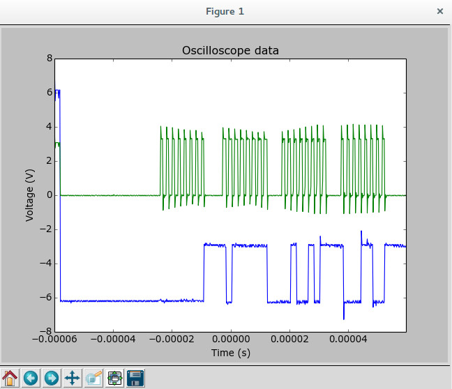

Hello everyone,
I made asimple XC8 program for PIC 18F25J11 ( https://ww1.microchip.com/downloads/en/DeviceDoc/39932D.pdf ) that reads ID from serial flash memory SST25VF040B ( **broken link removed** ). I have used spi library provided by XC8 for communication. Program appearantly successfully writes SPI command for reading device ID ( 9F H ) but when it fills buffer only with zero values although I can see valid MISO data on the scope.
Does anyone have any idea what could be missing here? Do I need to configure anything else about port RB1 to get it to work as an input?
Below I paste only a part of my code.
Thank you very much for any help!

Thank you so much, that was helpful and you saved me some hours of researching! I had solutions for all other parts of our project including analog inputs functionality but I somehow missed the note which says "On a POR, the RB<3:0> bits are configured as analog inputs by default and read as ‘0’; RB<7:4> bits are configured as digital inputs." as I returnd to implement functionalities for FLASH few months later.
