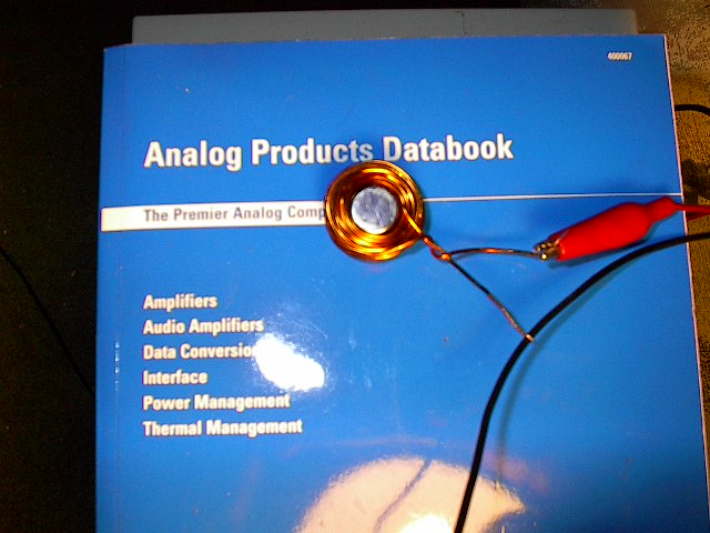

Ultracapacitors have come a long way, and still going..
Zack you gotta see the video of this , its hilarious..
in the pic its loaded and ready to go..
10 ...9...8... :lol:

thats one of my neo magnets nested in a coil of 17 gage wire..
and a little over 8 Amps , supplied by a 9.6 V royobi drill battery..

Looking at the video again, I noticed that the projectile actually tore through the paper at the top.
So I am sorry, it is much better than a Mexican jumping bean. :oops:
You didnt lock close enugh. The paper is just bent out.The pojetile fals back down the tube if you didnt se that.But those must be some prety powerful magnets.

I looked and looked and looked again. I didn't see the projectile fall back down. It seems like it is gone (stuck in your ceiling).
The magnet isn't strong, it is the crocadile clips that must be strong. I don't use them for more than only 50mA. :lol:

You do need HV to make a coilgun. The inductor's rise in current is proportional to the voltage on its terminals. At low voltage the current rises too slowly to be useful. If you had a lower inductance then of course the current rises much faster for a given voltage, but a one-turn coil would not produce a useful force.
The current driving capabilities of the source is only part of the requirements.
The second tup sound is the sound of the magnet bouncing off the book that is under the coill.
You need to step frame by frame to see it.
