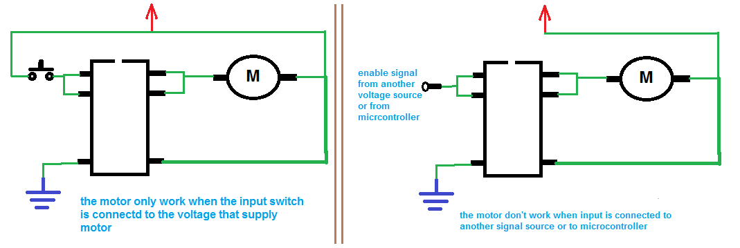

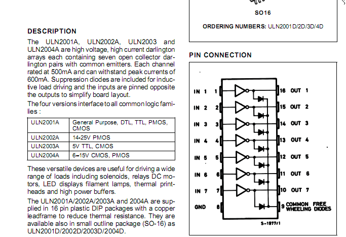

i'm trying to Drive a DC motor with ULN2003 and PIC16f877a PWM

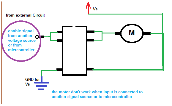

i test PWM output on a led and it works very good and when connected it to ULN2003 it didn't respond . so i test it alone when i connect the input to an external source(+5V) it also didn't respond , but when i connected it to the same voltage that supply the motor it works very well.
So can any one see where is the problem?? and help me.
here is my connection :
Do you have any 'clamp' diodes on the motor other than the diode in the ULN.??
EDIT:
IF the motor works when you connect the ULN in this way,[with the input open circuit] I suspect the ULN is blown

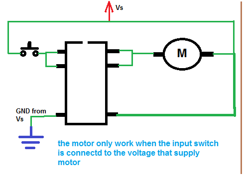

Is the 0V or earth connection from the "microcontroller or other voltage source" joined to the 0V or earth of the ULN2003 circuit?
hi Eric
I depended on the diode inside ULN .
but if it is blown how could it work when the input signal (bias voltage) is only from the source that supply motor ( even it was 5 v) i.e they should share the same voltage (any value )
and the motor didn't work when the input is open circuit.
hi Eric

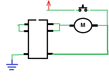

Are you saying it does not work when connected in this way.?
NOTE:
The Input voltage must not exceed +5V for a ULN2003, so +Vs MUST be =< +5V

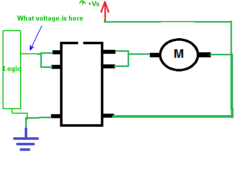

Is the 0V common of the external source connected to the 0V of the motor voltage.??
What is the voltage at the logic input pin when High and Low.???
The 0V's MUST be connected together

I'm sorry for being late
the 0V from both arn't connected together as i read from data sheet they shouldn't connected together
the voltage at the logic input pin:
5V --------> HIGH
0V---------> LOW
5V --------> HIGH
0V---------> LOW
Where in the datasheet does it say they should not be connected together.????
ok i found it on a website so i just take it.(the one who wrote this information said he read it in datasheet)
now reconnect the circuit and share all the 0Vs and it works very good as it should.

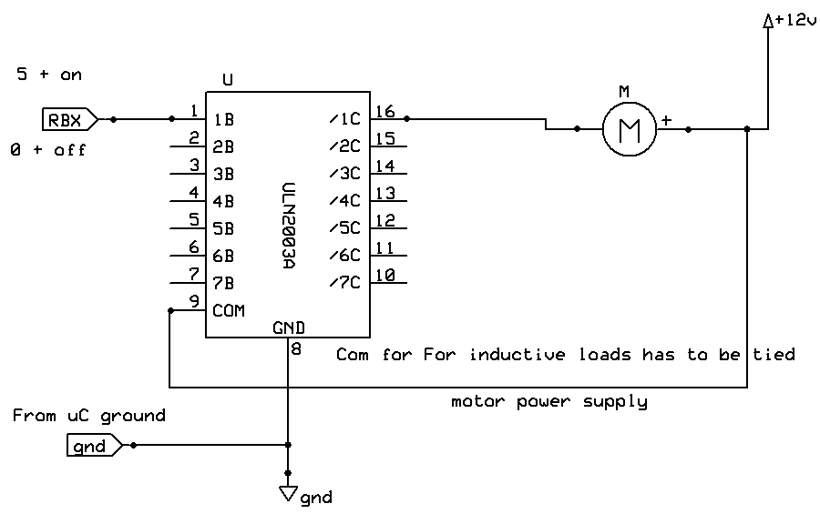

Here this may help you hook the com pin 9 to the motors Vdd or the EMF diode don't work.

hi Burt,
The OP's post#13, says its now working.
Thanks Burt
now it is working , I connect it like your circuit and it is the same as in post #8 .
so Thanks for ALL.
