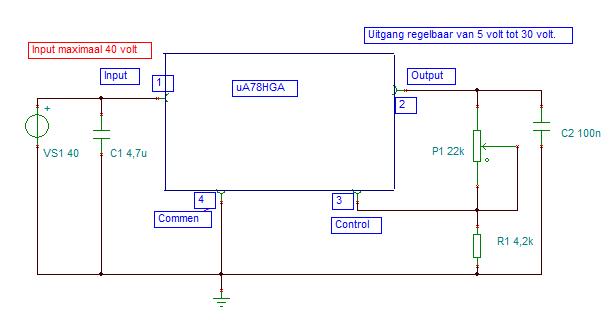

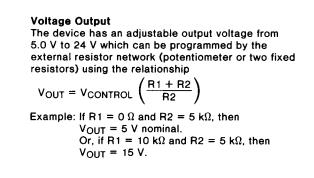

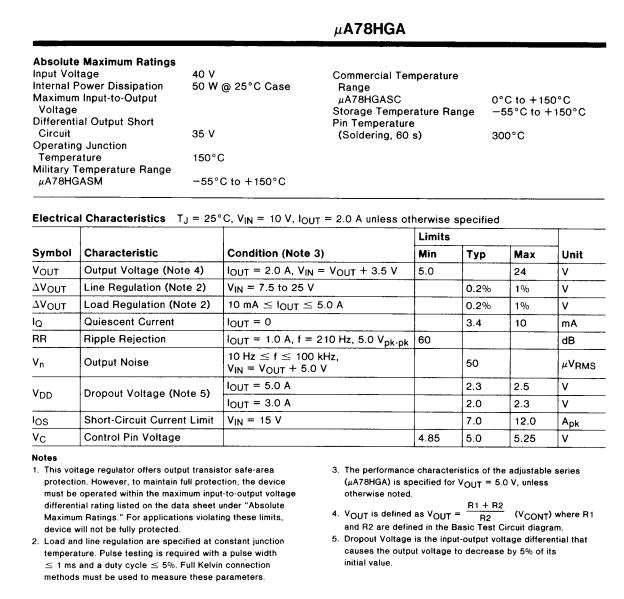

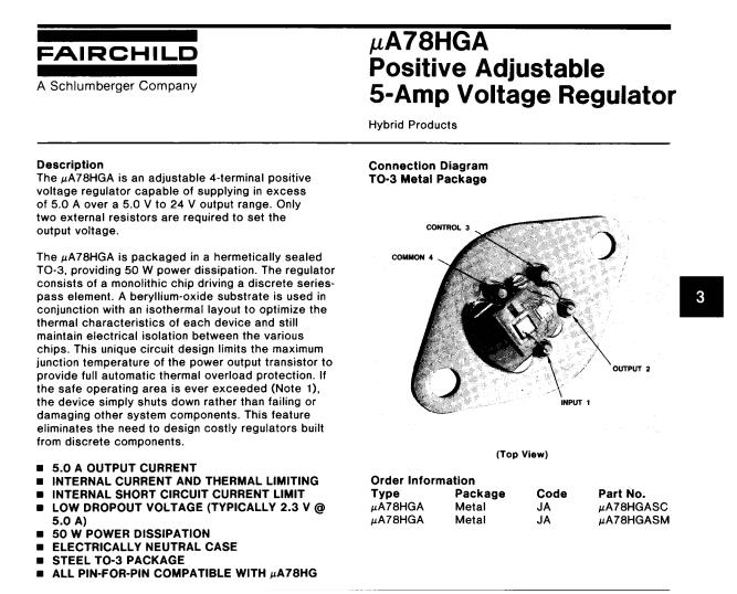

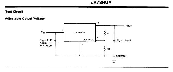

There are a number of uA78HGA in my possession, so let's build a power supply, normally these regulators are adjustable from 5 volts.
Now I was wondering is there not a trick to make these regulators work from a lower voltage, it was also done with the uA723 ic in the past which originally could also work from 7 volts.
Is there anyone who has an idea to let the voltage of the uA78HGA lower than the minimum 5 volts that can now come out.
Below some details of the uA78HGA.
Greeting,
Pim

The only way I can think of getting a lower output voltage than 5 volts is to scale the output voltage up using an op amp. As the reference voltage to the error amplifier is fixed at 5 volts the IC attempts to keep the control input to the error amplifier at the same voltage. (5 volts.) So for example if you wanted 2.5 volts out then the resistors in the op amp circuit would have to double the voltage. You may have stability problems using this idea.
Les.
Thanks for your comment, don't see how that should be done yet, but if it causes stability issues, that's a new problem.

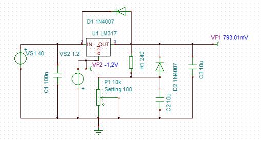

Had the idea to use an LM317 up to 5 volts and then switchable, but that causes a lot of hassle with wiring.
Greeting,
Pim

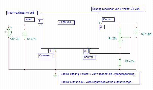

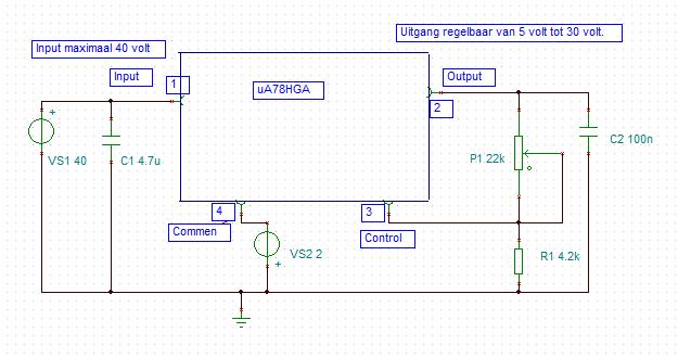

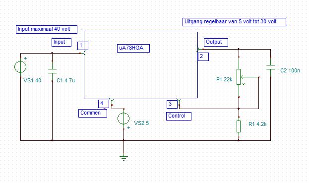

Another possible solution might be to connect the common pin to a STABLE negative supply. That should subtract from 5 volts. So if you wanted 3 volts output the negative supply would need to be 2 volts.
Les.

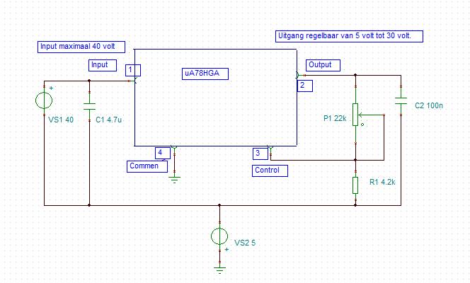

Since the output voltage of the uA78HGA is relative to it's ground pin, another way to lower the voltage would be to shift it's gnd pin negative.
If the GND pin is at -2 Volts, then the output would be 3 Volts. Whatever you use to drive the GND pin needs to handle the ~10mA operating current of the uA78HGA .

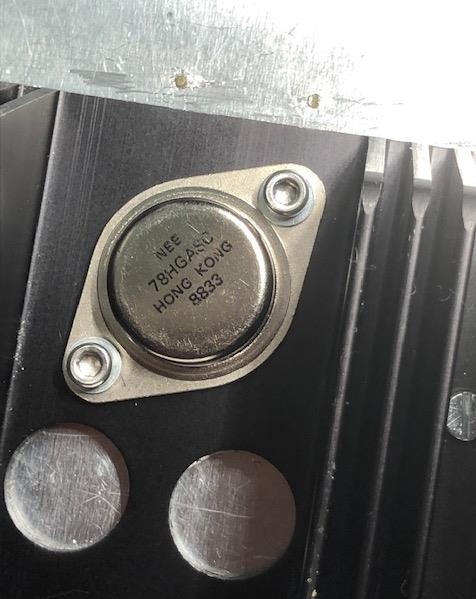

Could you take a photo of the device’s top? I would like to read the date code.
If these are legitimate NOS devices, they will be worth good money.

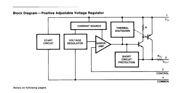

Do not let the ground pin float. It must be tied to some stable point.
The uA78HGA regulates it's output to be 5 Volts above the ground pin. If it were left floating, then the output could be as high as the input, or probably be a volt or two below the input voltage.
That is clear, the ground connection will be at a low negative voltage.
Preferably adjustable.
Not quite - it's output is set by the control pin, which has a 5V reference offset from the ground pin.
The "ground" could be fixed at -5V and the control would then be zero - referenced.
This is like Antiques Roadshow where some guy turns up with some rusty metal and it turns out to be worth 1M dollars. Looking forward to the answer.
It works with the LM317 and that can also be proven in Tina software, but unfortunately there is no model of the uA78HGA available in Tina software.
But if the "ground" pin were left floating, then there is no return path for the internal operating current, and no point for the internal 5V reference to know where it's zero point is.
Now, I have no personal knowledge of this condition, but a couple years ago Flyback put up a post where he complained that the output of a regulator that he was using went close to the input when it lost it's ground connection.
