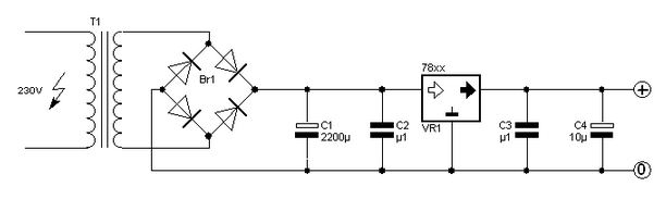

I have read a lot about two capacitors in parallel with power supply but I still got stuck.
parallel-capacitors-in-power-supply-jpg.75326
Here is what I get:
1. Big capacitors (electrolytic capacitor with large ESR and ESL) handles low frequency ripple and mains noise and major output load changes.
2. Small capacitors (ceramic capacitor with very small ESR and ESL) handle noise and fast transients.
My question:
1. At very high frequencies, the ceramic capacitor will be short, right? And why this shortage don't cause the power supply be damaged?
2. Why "electrolytic capacitor with large ESR and ESL" is excellent for "handling low frequency ripple and mains noise" and major output load changes and ceramic capacitor with very small ESR and ESL is excellent for "handling noise and fast transients"?
The large capacitor handles the lower frequencies simply because it has a lot of capacitance and can hold the voltage over the time of the cycle or half cycle. The smaller cap cant hold the voltage long enough to filter properly.
The small cap can handle the higher frequency components because it has less inductance.
The higher the frequency the lower the amplitude of that component, so the diodes dont blow out.
The diodes could however blow out when the power supply is first turned on however if the input voltage is near the peak of the sine wave because the big cap acts like a pretty good short for a short time. So sometimes we have to insert a current limiting device in series with the rectifiers or just the input. Typically these will be thermistors that can handle higher currents and their resistance decreases as they heat up so after a short time their resistance goes down and the power supply acts normally.
We could look at the harmonics coming out of the rectifiers so you could get a better idea about the amplitude of each frequency component. As the frequency increases the amplitude goes down so there is less current at that frequency.
Also, the input transformer often has both series resistance and leakage inductance which also limits the current at many frequencies, and acts as a low pass filter too which reduces the higher harmonics too and also helps with the turn on surge current.

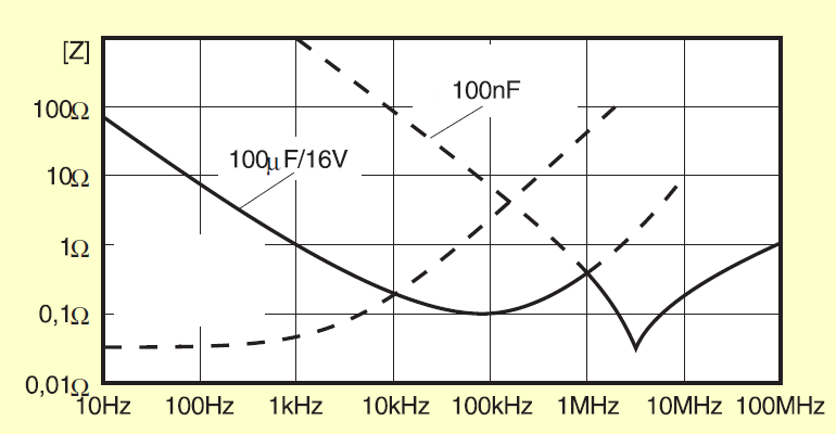

Simply at high frequency electrolytic capacitor has a much larger Zc than 100nF ceramic capacitor.
See this example
1a-png.75328
When you have a plot of a Zc Vs frequancy for 100uF electrolytic and 100nF ceramic cap.
Theory tells us that the Zc of a capacitor will decrease monotonically as frequency is increased. In actual practice the ESR causes the impedance plot to flatten out. As we continue up in frequency, the impedance will start to rise due to the ESL of the capacitor. This is why we often see larger value capacitors paralleled with smaller values. The smaller value capacitor will typically have lower ESL and continue to “look” like a capacitor higher in frequency.
https://forum.allaboutcircuits.com/showthread.php?p=296744#post296744
