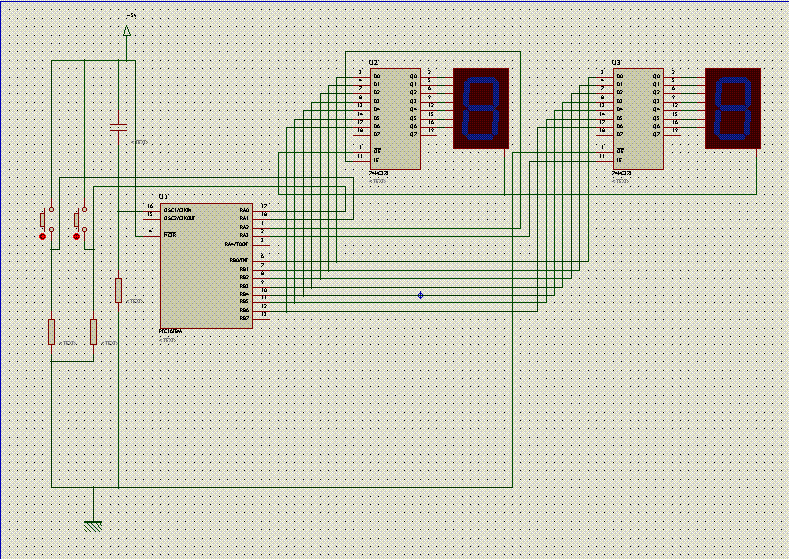

Two 7-seg Up-down counter with two switches
this is design
Why are you using a RC oscillator I thought you where using the 16f628a
You beat me back lol changed to 16f84a
Always start your files at 20h so the program can be ported to another PIC chip.
You have already been shown how to multiplex two 7-segment displays so that no other chips are needed.
Don't keep going backwards all the time. PIC84's are out of date and expensive. PIC16F628A's are less than $2.00.

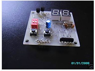

I have a 16f54 PCB which includes 2 buttons, a 2-way DIL switch,
it's on ebay right now (link is on my website)
not a very good design, indeed one of my first PCBs,
but it works, good brightness, and source code for
hex up/down counter, and random numbers is included.
I could even give the source code seperately if interested (just it is explicitely customized to specific PORT bits).
I use plain 2n3904, and no resistors, one 74hc595 buffer.
yes the 16f54 does not have A/D, and also otherwise is limited, only 512 words.
PS. i do not really intend to sell large numbers of this design, it was just an experimental prototype. Indeed, i have made a new design recently.
still have a few unpopulated PCBs around.
money i made out of each PCB was $2 or $3.

thank u for your advice
