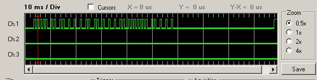

*update: i got it up, here is my code now:
what kind of code could it be......also it may be inverted?
that is 58mS long right?
do i need that full pulse train?
Yes, you need the entire pulse train - the output from a TSOP is active low - so I suspect your sample is inverted (which is actually how you would transmit it).
ok, i figured out that im using the NEC protocall, but as you can see i have ripped the code but the tv still dont respond(and GF won't let me open it to attach a probe),

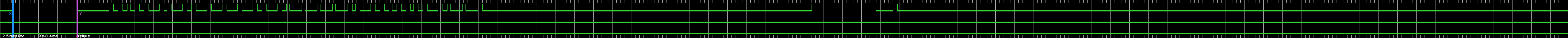

here is my pulse codes using a 18f886 with the following code:
and here are my pulse scans, one with the remote, and one with my IR gun,
how accurate a signal do i need to get this thing goin?

aCK! those two horizontal lines posted(right above the code) vertical are my 2 signals(bmp) captured off the TSOP( one from the actual remote and one from the PIC IR)
