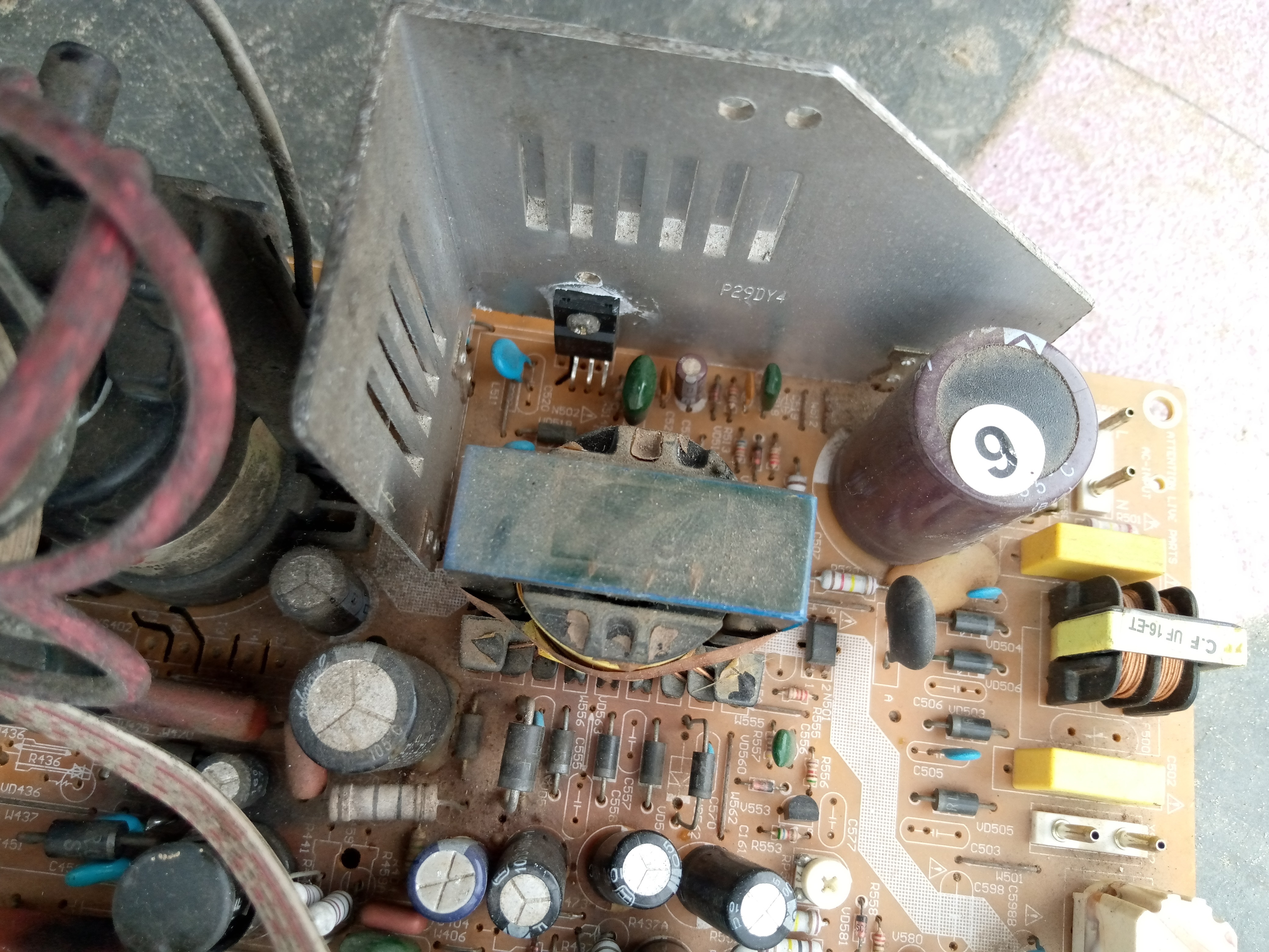

China TV 21 inches has this problem whenever i put it on, power LED will turn on normally and also line-transformer will sprays for 2-3 seconds and go back to standby mode. i have changed the the power ic and the flame ic yet it still the same. please i need help.

you may check shorted driver transistor of fly-back transformer, or any diode in that area

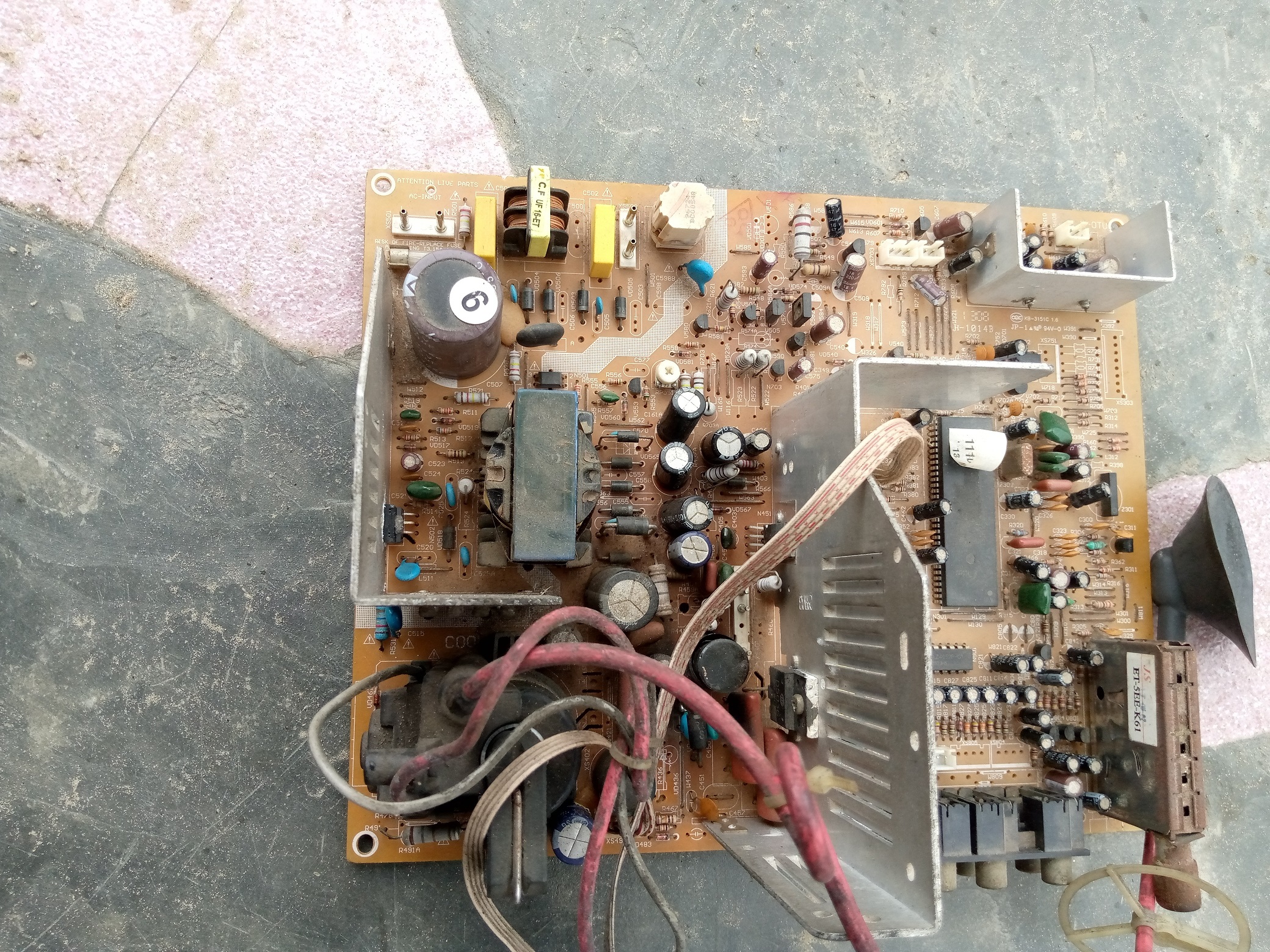

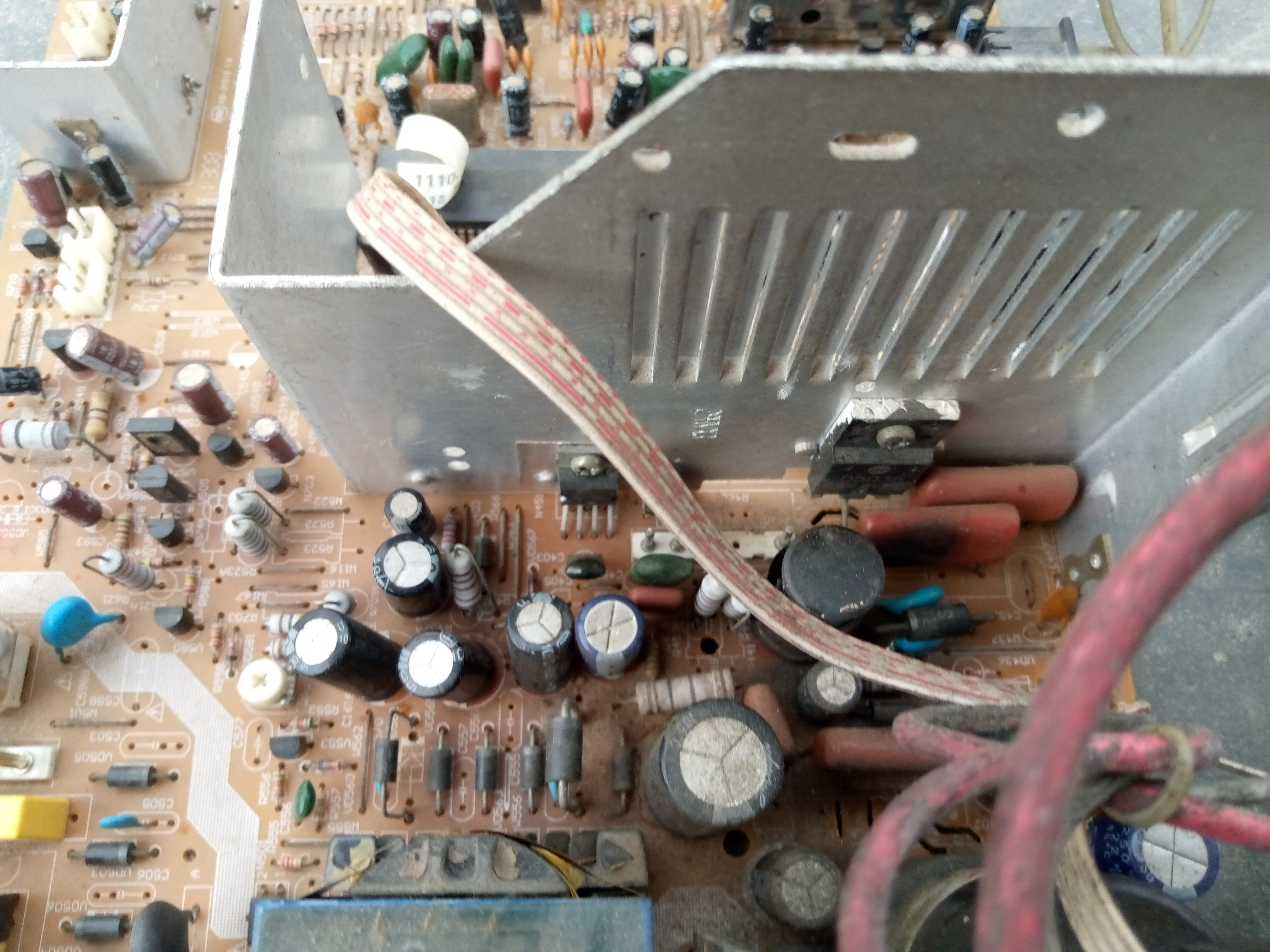

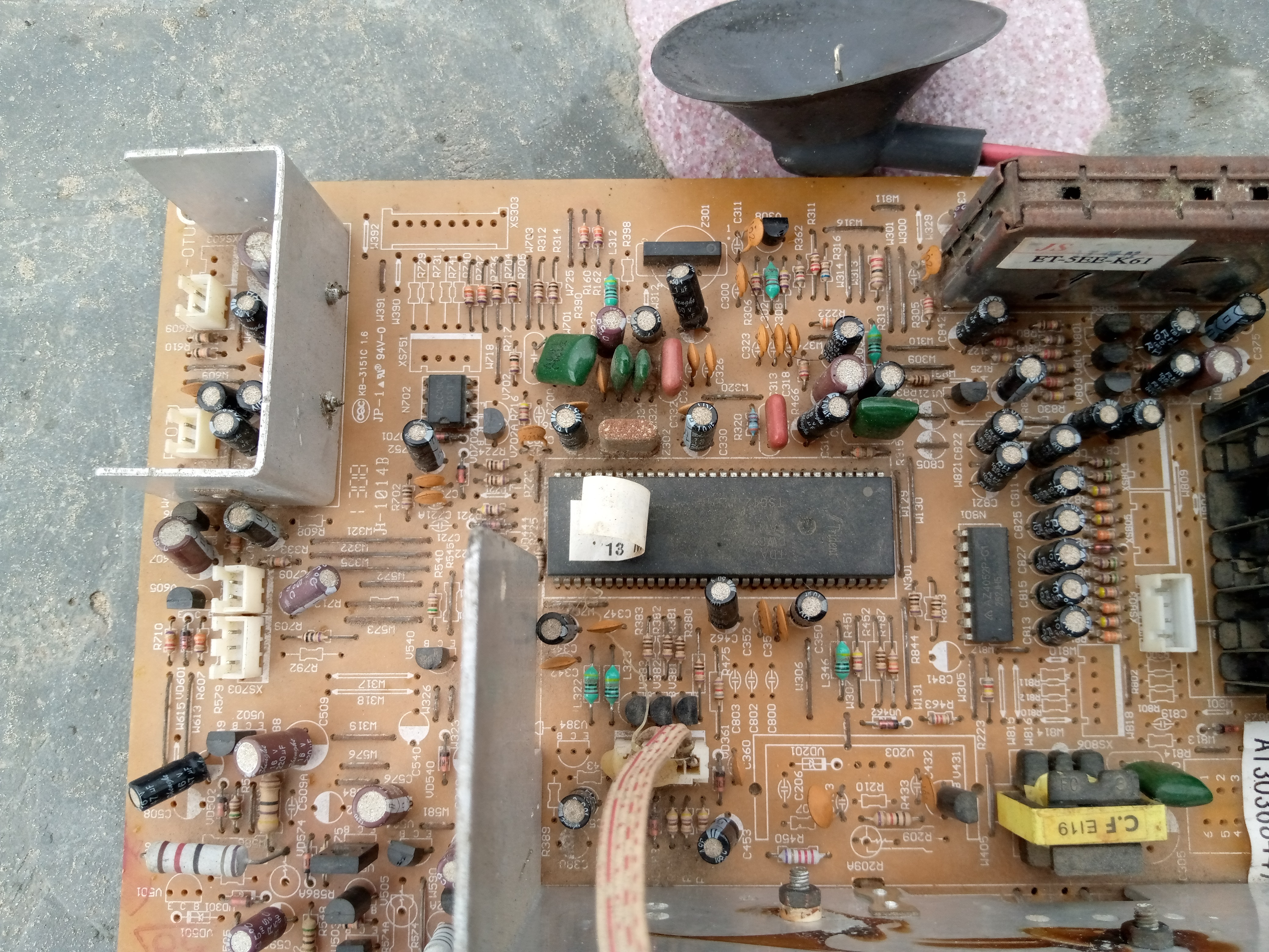

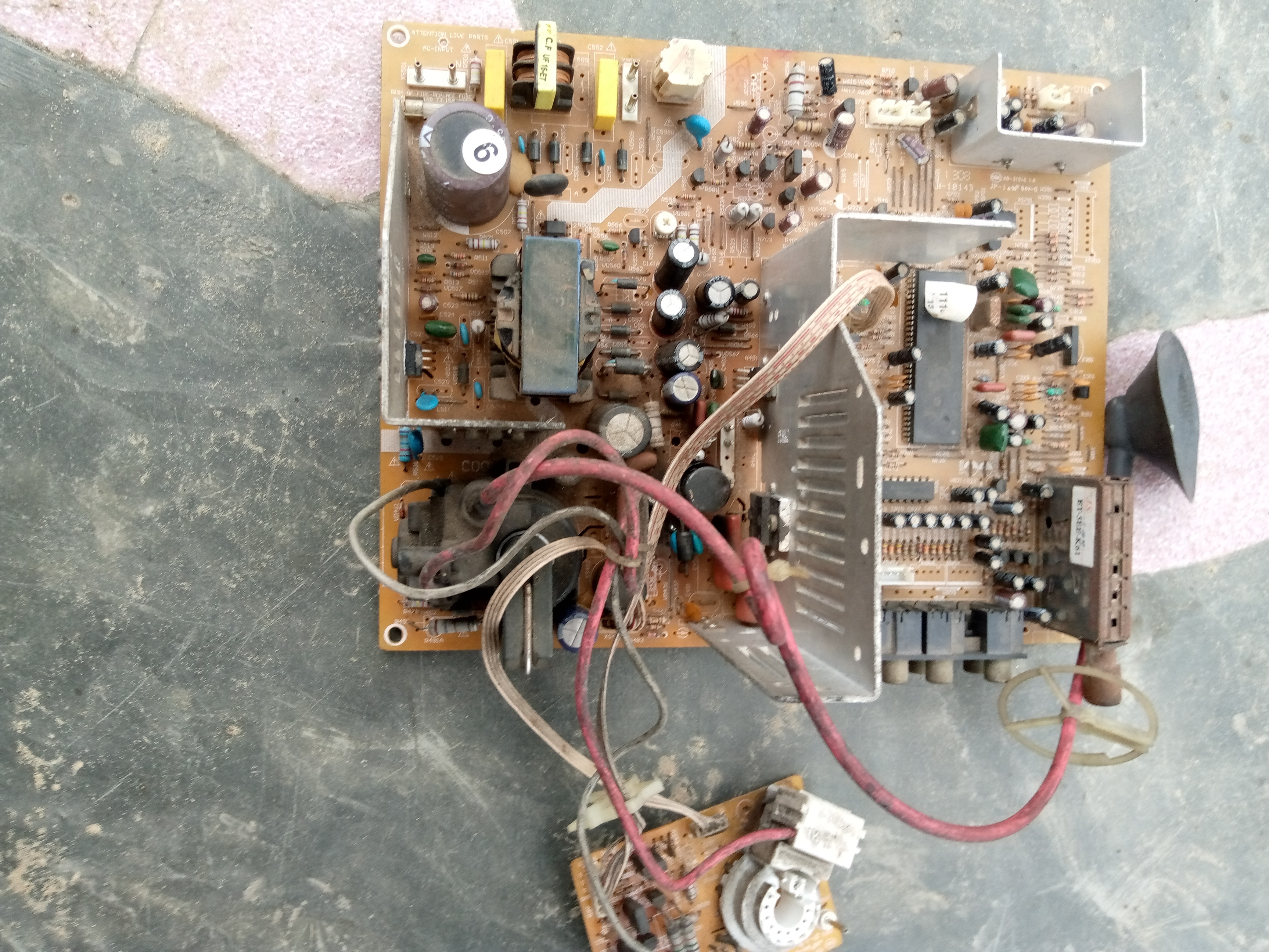

China CRT TV 21 inches has this problem whenever i put it on, power LED will turn on normally and also line-transformer will sprays for 2-3 seconds and go back to standby mode. i have changed the the power ic and the flame ic yet it still the same. please i need help.
below is the panel for the tv.

I found a schematic here.
The Live side looks to be a little different, because in the schematic is an IC at LIVE side.
I've found another schematic with Transistor drivers too, but the picture is crapy.
It seems to be T08X-21A-VS Chassis
At PCB it's marked with KB-3151C 1.6 ( at the pictures of "Samsontimy" ).
I hope that's helpful, or another User can find a better schematic.
Better no; the right one.
I've take a look into the schematic.
The Power supply produces 5 Voltages
+5V CPU - I think it's standby Voltage for the CPU
+5V - Electronic supply
+110V - High Voltage / deflection
+27V - Power for deflection IC's
+8V - Additional Electronic Supply
At first I would measure if all of that voltages are present, when the TV runs in Power Mode ( 3 seconds ).
The 5V CPU , +27V and +110V should be present in standby too.
+27V and +110V would be lower value in standby, because the Power supply runs in standby Mode with lower power.
The other 2 Voltages will be swiched off by 2 Transistors.
Measure this and give us a feedback.
