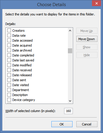

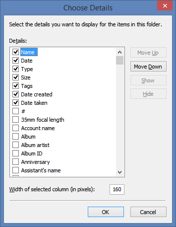

Hi MrAl,
In Windows explorer you have the option of having the files sorted by alphabetical order or date modified. If you have the display option set to details then clicking on the heading name sorts them in alphabetical order. Clicking on date modified sorts the by date. (Clicking on the heading a second time reverses the order.) The same sort of thing happens if you click the type or size heading.

I have many utilities to change the exif file contents which includes the file creation date but I never use them since my PC is connected to TV , all my TV video comes from the PC
These are Windows EXtended InFormation or EXIF attributes reserved and included for every file.. I'll look for the app.
Be sure which date attribute is the one it recognizes.
https://www.techgyd.com/software-view-edit-remove-exif-data-from-photos/7762/
