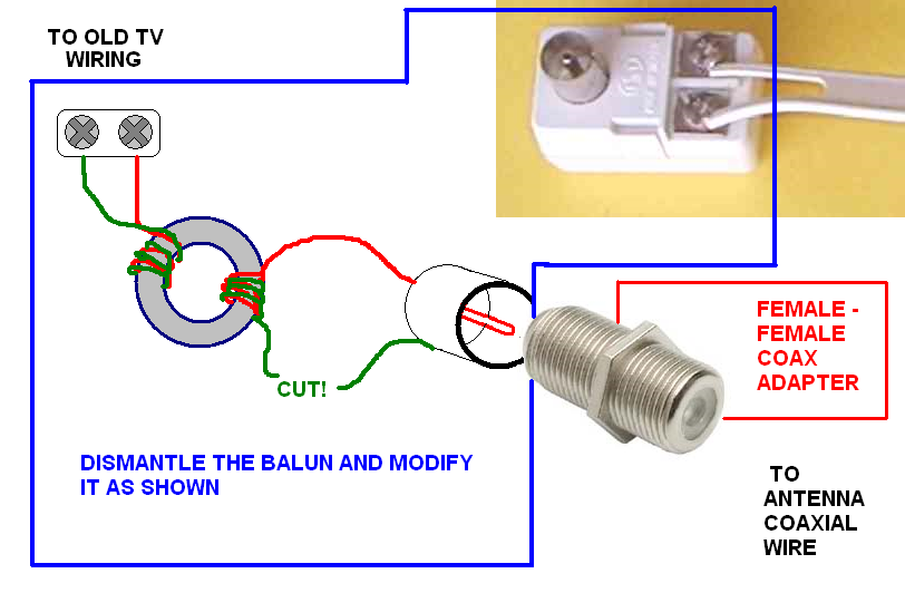

Hi again guys!
I'm having serious problems with a very, very old SONY KV82ME7. I know it's a ... again, very old! TV, but it belongs to a low-income family, so I must fix it to sleep well.
The antenna female jack wasn't the one I was used to
example:
Instead, a strange jack
I removed the strange jack and soldered a common female jack. But, when I plug the coaxial coming from the antenna... explodes!!
I'm sure the female jack is energized, but I don't know why! The explosion only occurs when the coaxial makes full contact with the TV... if only the central pin is connected, the TV works great (I saw the Obama's speech on it)
I didn't changed anything else, and the wiring is OK (the antenna is not touching the PSU or anything else)
What's going on? :confused:
Just in case that any person in the world has the same problem:
I've found the deal. In older TV's, the chassis is energized! It was a new, really amazing discovery form me, after too much explosions and zaps.
I've added a Balun between my new jack and the TV's sintonizer PCB... and problem gone! Somebody told me a ceramic capacitor would to the trick too.
The "modified" balun was made with a 75-to-300 ohm common balun, take a look

If you know so little about TV's you really shouldn't be trying to repair them for people - this is how TV's always used to be, live chassis's were the norm for decades.
The aerial socket would normally be isolated by special isolating capacitors, usually (in more modern sets) built-in as part of the socket itself.
BTW, it's not a 'strange jack' - it looks like a Belling Lee Coaxial Socket - the standard aerial connection for most of the planet.
Yes :( That's why I only work for friends and for free. Normally, after discharging the CRT, I look for obvious signs of failure (blown capacitors, brown board). If that fails, googling the failure, usually I get where is located (i.e. check and replace V sync caps, your diode is blown, etc.). More complex failures are beyond my spectrum.
You are right, I'm pretty sure the little box I discarded contained them. I'll never do again such a thing :mad:
You are right again! Thanks for the name. I had never seen a Belling Lee on a old or new TV before. I remember them in CB radios, but on old TV sets, a pair of screws for the UHF antenna was the rule for me.

Sounds like the chassis is hot, has 120v AC on it. Did they make TV's without transformers, like some radios. Then if the power plug got reversed of if the wall socket was reversed it would cause the problem you describe.
Get your voltmeter out and make a check.
ALL TV's used to be like that, originally they used half wave rectifiers (usually metal ones), so the chassis was full live mains if the plug was reversed. Later, because the electricity companies complained about the mains been pulled to a DC offset, they started using bridge rectifiers - which left the chassis live at half mains potential regardless of the plug direction.
The only socket on the sets was the aerial socket, and these were isolated by special capacitors on both connections.
Later, with the advent of switchmode supplies and AV inputs, the main part of the chassis was isolated, and the aerial socket became directly connected to the chassis. There were also a very tiny number of sets that used conventional mains transformers for isolation, but these were very uncommon.
