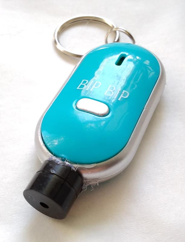

Done! I bought a HYDZ buzzer (a real DC one, don't trust the + sign on the others!) and wired and glued it in place of the LED.
It works perfectly! Thanks everyone for your help and advice.
