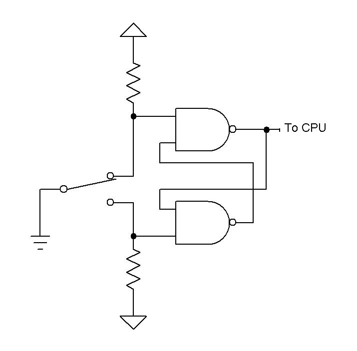

Debounce
Using a momentary contact switch in Eric's circuit is always dodgy.
They normally produce a stream of pulses "switch bounce" and your output will be random depending on whether you get an odd or even number of bounces big enough to toggle the flip-flop.
Try putting a cap (1-10µF) across the switch or a debounce circuit using your 4011 chip.

hi hdc,
Your circuit works fine with a change over switch, not with a simple push to close switch.
I would guess if the OP has a change over switch he wouldnt need any logic ic's.:)
