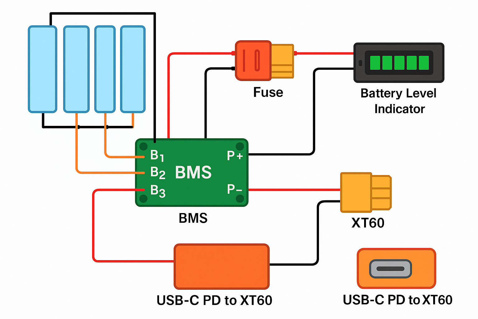

I decided to build turbo jet fan (enclosed), with a lot of help from chatGPT.
Can you help me with feedback on this one?
LiPo batteries are expensive and hard to integrate in smaller form factor.
Motor is bit too powerful, but I can dial it down.
I am looking for feedback compatibility of component and safety.
components:
- motor + ESC + controller; 40mm=460W MAX in 16,8V; 29,8A, working voltage 7.4-16.8V
https://www.aliexpress.com/item/1005006184419940.html
- battery 4x Samsung 21700 INR21700-45T Li-Ion 3.6 V 4500 mAh 50 A
- BMS
https://techfun.sk/produkt/bms-modul-pre-litiove-baterie-3s-4s-5s-100a/
- Charging board
https://www.aliexpress.com/item/100...V5Vlpn9m&utparam-url=scene:search|query_from:
- battery indication
https://www.aliexpress.com/item/1005005727166588.html
-amp meter
https://www.toolkitrc.com/product/wm150/
-nickel strips 0,2mm x 10mm (6 layers between each battery connection - spot welded)
-copper strip 0.2x10mm alternative for 6L nickel (sandwich of nickel (bottom), solder(center), copper(top) spot welded on battery)
-XT60 connectors
-21700 Battery Terminal Insulator Rings
-heat shrink tubing
-Kapton tape
-car fuse 40 amp
-Balancer connector (JST-XH 5-pin (male +female)
-case 3D printed by friend
-High-temp silicone rubber cable (e.g. 200 °C rated)
[somehow in metric part of this world the silicone cables are also categorized by "AWG" size]
wired connection Current Wire Size (mm²)
Battery to ESC ~30–50A 4.0 mm²
ESC to Motor ~30A 2.5 – 4.0 mm²
Charging leads ~5–10A 1.0 – 1.5 mm²
Balance wires <1A 0.14 – 0.25 mm²

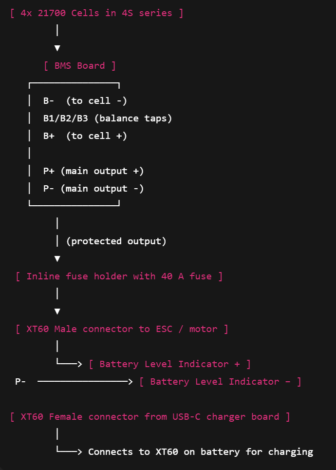

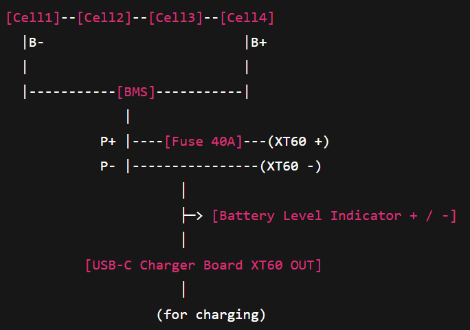

wiring scheme straight out of chatGPT:
the last image is little bit "sus"
