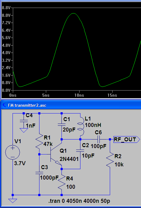

I simulated the circuit made by S!dd!k.
I increased the value of the tuning capacitor by 5pf to 20pf due to stray capacitance and to reduce the frequency away from the aircraft band to the FM broadcast band.
I used a powerful 2N4401 transistor.
The oscillator stops when a load on its collector is less than 680 ohms so its output power is very low.

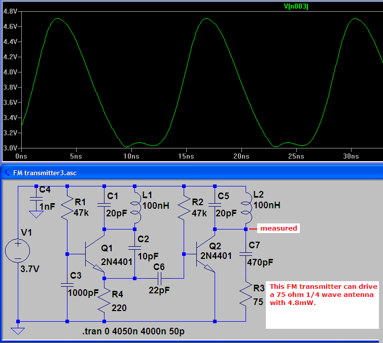

I added an RF amplifier transistor to isolate the antenna from the oscillator. The oscillator stops when the RF amplifier is cap-coupled to its collector but works fine when cap-coupled to its emitter. The RF amplifier drives the 75 ohm 1/4 wave antenna. The output power is low but useable.
The output has strong even harmonics which will cause interference to communications.
