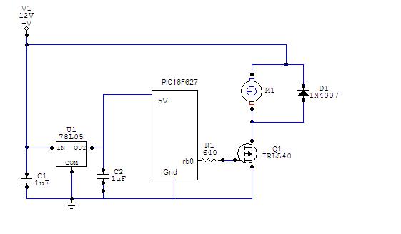

I did the tests as you suggested, all of them turned out as expected, so that means the MOSFET and motor are working properly right?
Here's my circuit. Tell me if there's anything wrong with it.
The motor is suppose to have a max current of 0.92A.
Using this circuit, the motor sometimes turns on, sometimes doesn't work at all. And when it turns on, it doesn't turn off after, even if my PIC attempts to output a 0V, the gate of the MOSFET remains at about 2.5V
I really need help........thanks a lot :D

Good. We are making progress, at last.
Do the above test again, but this time at step (6), connect the gate via R1 to +5V instead of +12V. i.e. disconnect R1 from rb0 and connect R1 to +5V.
If the motor is functioning good, then problem is in PIC or programming.
If the motor is sometimes running and sometimes do not, then problem is MOSFET assuming R1 is good. The gate voltage of IRF540 worst case requires 4V to start conducting so at 5V it could conduct only a little and not been able to start the motor. Solution is to use logic level MOSFET type of which operates on gate voltage of +5V. Or you can use a normal P-Type Mosfet and drive it with a NPN transistor.
If problem is in PIC, either there is bug in your programming or the port pin of the PIC is damaged.
Have you set up the port properly? How do you turn the motor On and off?
You can attach the source file here and other PIC experts can have a look.

The mosfet works fine with that test, how do I determine if the R1 value is correct?

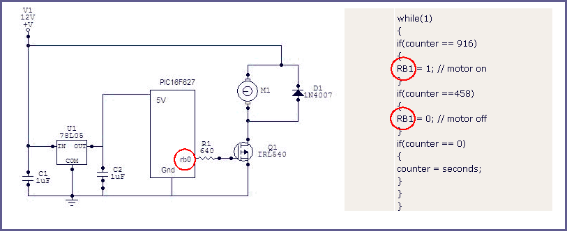

Here's my code. It basically turns on the motor for 30seconds, turns off for 30 seconds, turn on for 30 seconds... Anything wrong with it?
#include <pic.h>
#include <pic16f62xa.h>
// 16F77 config word
__CONFIG(0x2121);
//feedback
static unsigned int counter; // counter for time elapsed
static unsigned int seconds; // sets desired pulse frequency
// ON time of pulse
void main(void)
TRISA = 0x00; // Port A: output
TRISB = 0x00; // Port B: output
PORTA=0x00; // Initialize Port A to 0
PORTB=0x00; // Initialize Port B to 0
//timer0
T0CS = 0; // Increment timer0 on instruction clock
T0IE = 1; // Enable interrupt on TMR0 overflow
T0IF = 0; // Clear the Timer0 interrupt flag
TMR0 = 0;
PSA = 0; // Sets the prescaler to Timer0 module
PS2 = 1; // Sets the prescale to 1:256
PS1 = 1; // Sets the prescale to 1:256
PS0 = 1; // Sets the prescale to 1:256
// overflow every 4*256*256/4000000 = 0.065536s
seconds = 916; // 60s/0.065535 = 916
counter = seconds;
// ADCON1 = 0x06; // Set PORTA to digital I/O
GIE = 1; // Enable global interrupt
while(1)
if(counter == 916)
RB1 = 1; // motor on
if(counter ==458)
RB1 = 0; // motor off
if(counter == 0)
counter = seconds;
static void interrupt
isr(void)
if(T0IF) // Timer0 interrupt
T0IF = 0; // Clear interrupt flag
counter--;
Because MosFETs are controlled by voltage, the resistor value is not critical, anything from 0-1K (yes, you can leave it out!) is fine...
PIC enable to go back down to 0V
I tested my PIC, the output rb0 goes 5V, 0V, 5V, 0V... correctly!!
I tested my mosfet and the motor, they work too.
however, when i feed the output rb0 to the gate of the mosfet, the mosfet turns on when at 5V, but it stays stuck there. Why is that?

Hi Jay,
Do you see any problem in this C code? Or in C code the first pin of the port is 1 and not zero.

eblc1388 said:
Hi Jay,
Did you set RB0 to output?
I will make and send you sample code in Assembly, wait... :wink:
I do not want any assembly code. The drawing & code is related to this thread by ptewright. I just wonder about the rb0 and RB1 notation.

You still have not answered my question. Is rb0 = RB1 in C ?

Sorry, I changed the output pin to rb1, just to see if the pin was broken. It didn't make a difference.
From my testing, it seems that the PIC is resetting every time it tries to drive the motor, that is why it never turns off.
So then i tried setting rb1=0 first, then rb1=1 second. When tested, the motor is off for 30seconds, then the motor turns on for about 2 seconds, and the whole thing resets, so motor is off for another 30 seconds, then it tries to turn on the motor for like a few seconds, and then automatic reset again........... :twisted:
(and obviously, if i take out the motor, then the PIC does the on/off thing properly)
why is that??? is the PIC not able to drive the mosfet???
is there a way to stop the resetting?
I didn't think that this circuit would be so complicated!!! :shock:
I don't "speak" C yet, so I can't tell you! But it's highly unprobable!!! I think rb0=RB0 in C
