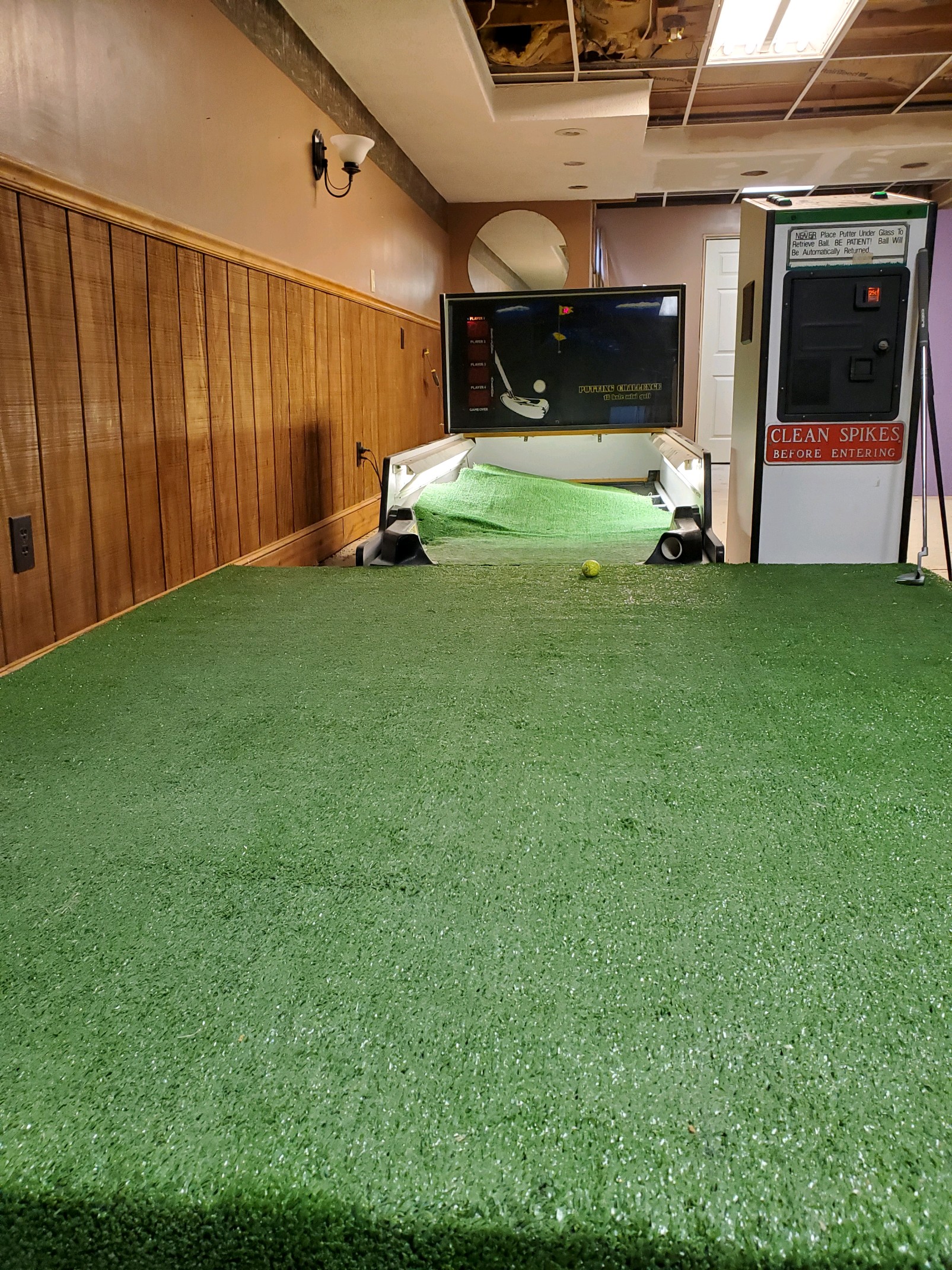

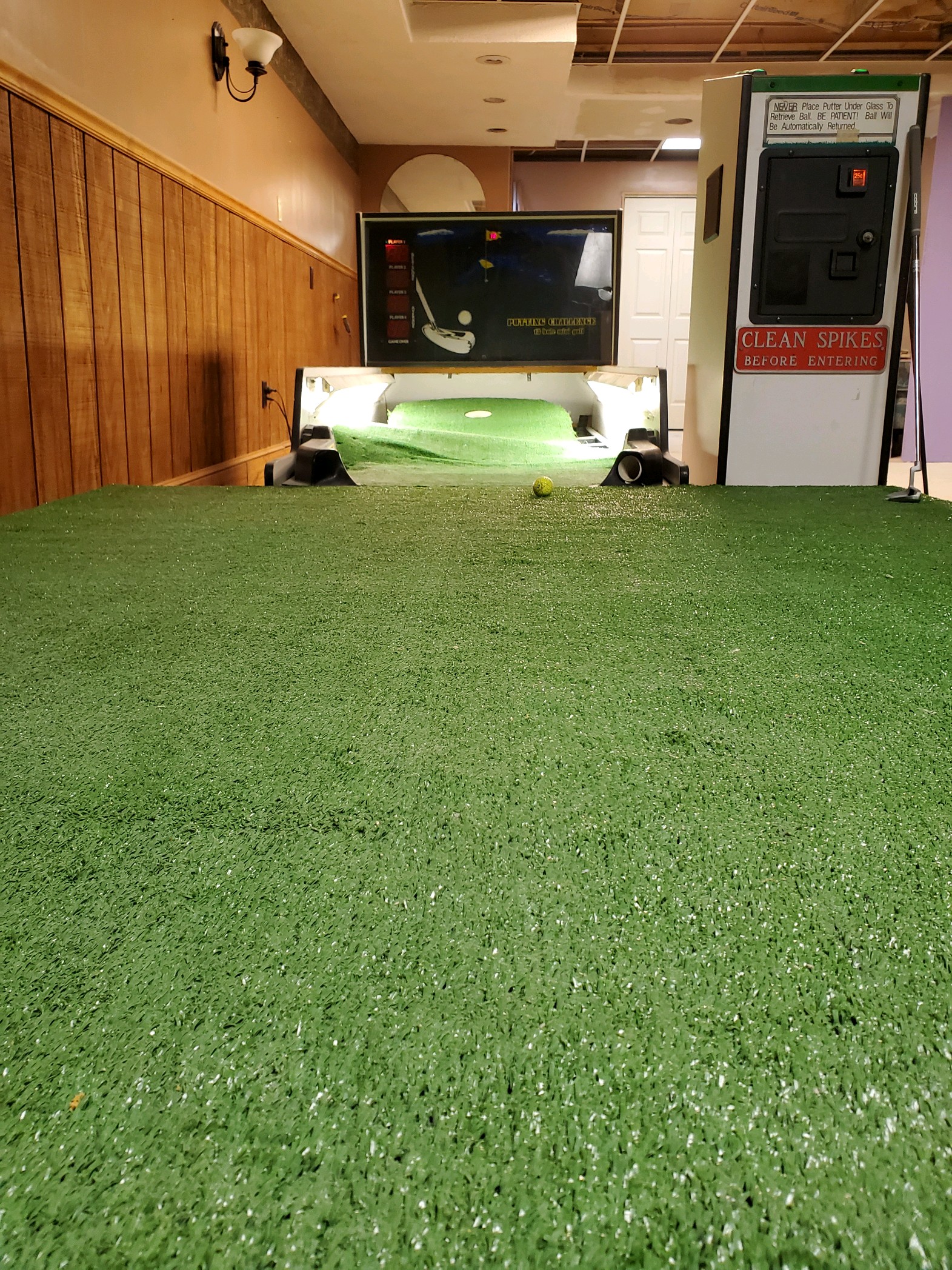

thank you all for all the help... i am victorious..
It needed 2 new OP sensors, neither of them were putting out LED light. original problem
when i soldered the new OP on, 1 of them had a trace on the component side of the board, and it was not making connection
so on OP2, there was no connection between the resistor and LED. just put on a jumper wire, and it works perfect. (self made problem)
So i'm back, i now have a 11 foot putting green, that changes between 18 different contours.. like 18 different mini golf holes. the kids love it
Thanks again for everyone's time.
