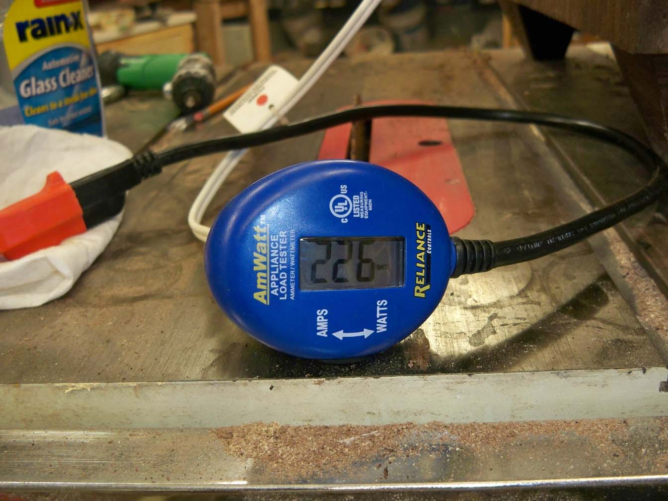

Do you have any photos? I'd like to see one of your incubators and it might help people suggesting efficiency improvements etc.

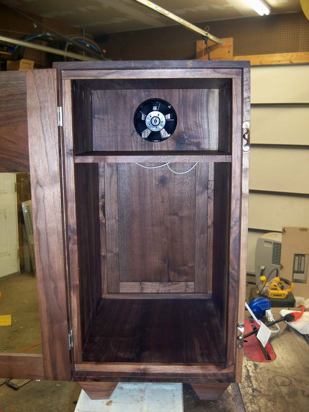

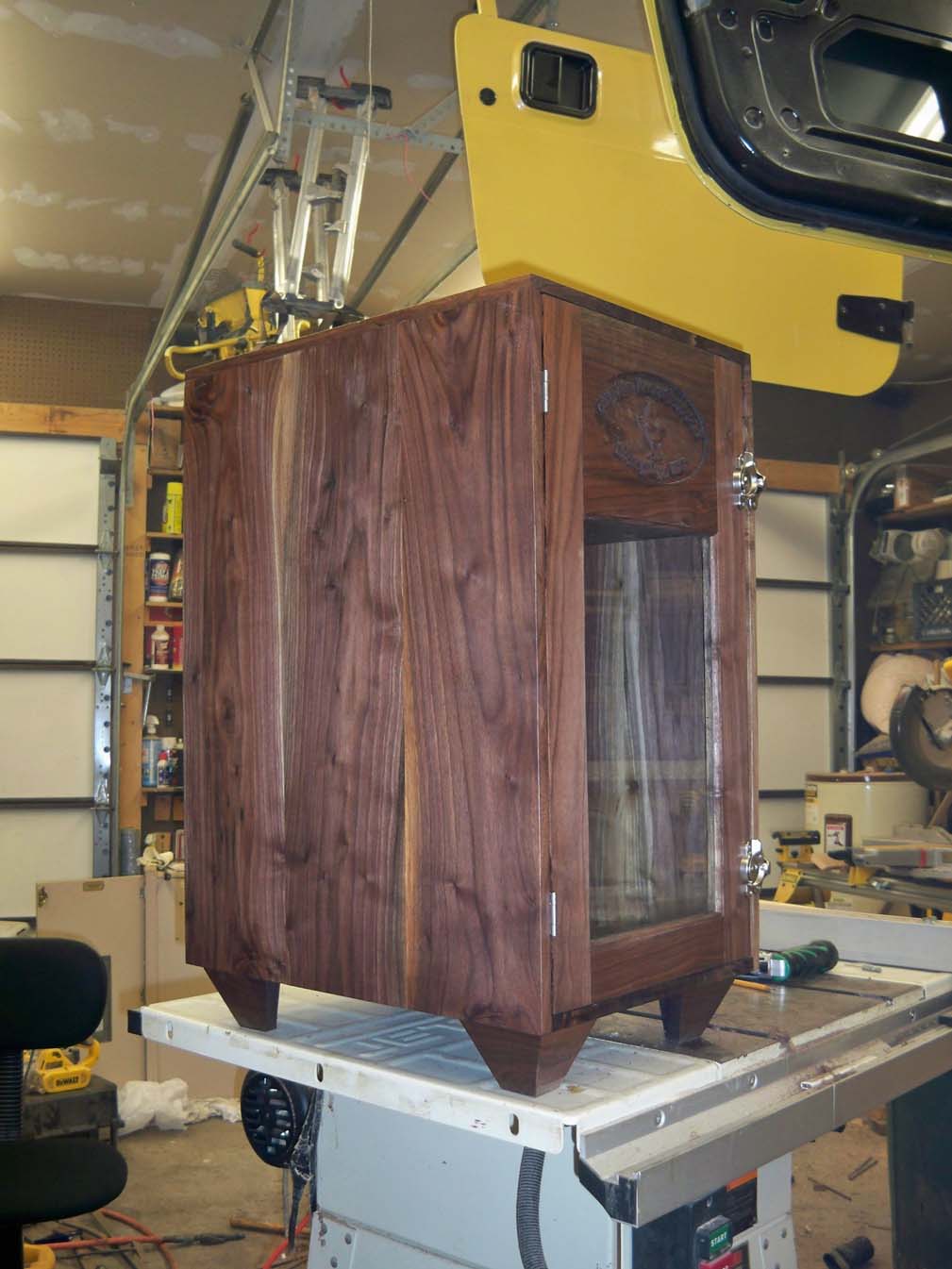

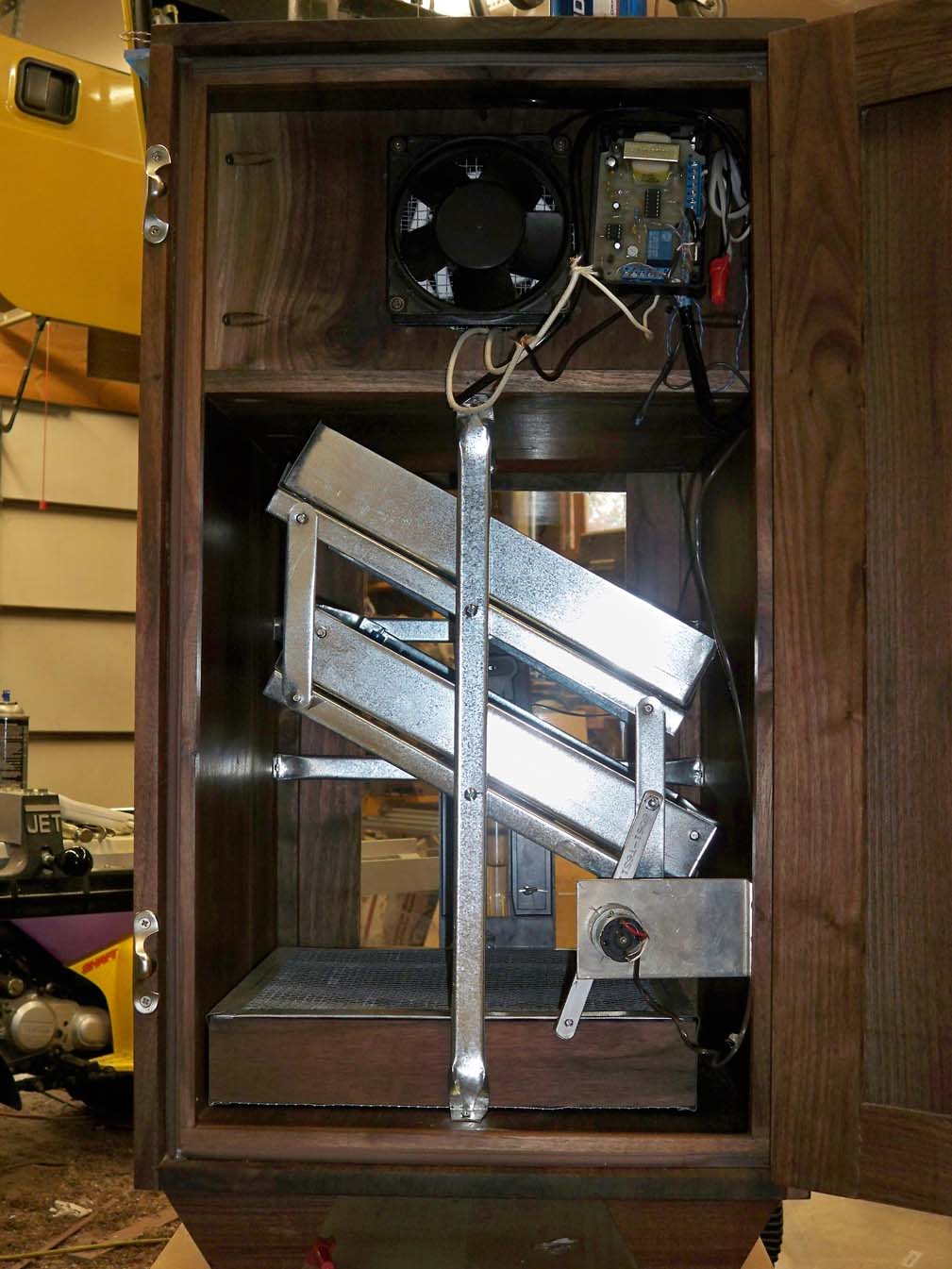

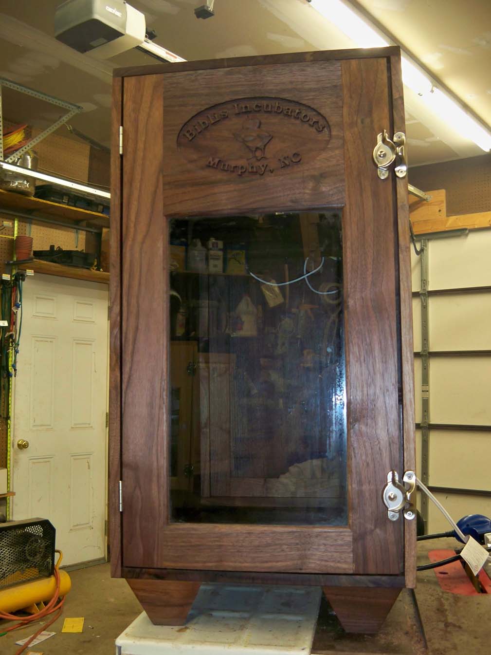

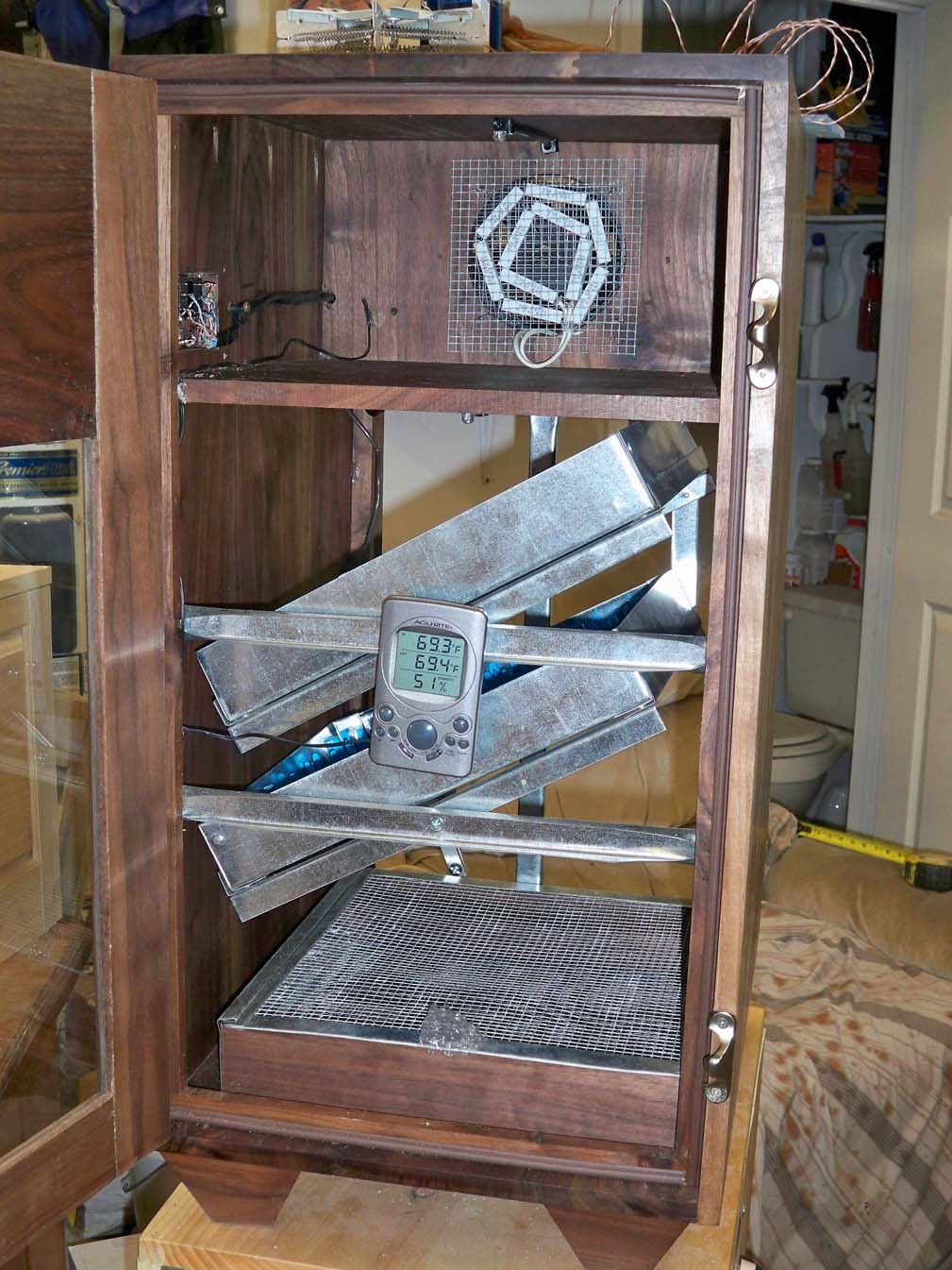

This is the model that i'm working on right know, It's in shambles but you get the jest of it. The heater that is in it is one i built yesterday to try out. It is the 18ohm resistors. It will work good to maintain temp but i'll have to add another nichrome wire to bring the temp up to the temp. The pic of the watt meter is displaying the nichrome heater wattage by itself. This is what i want to change.

Beautiful cabinet. Honestly I wouldn't worry about efficiency for this kind of application. If you want it to be more efficient design it to use better insulation. If it's in a room that would benefit from auxiliary heating just don't bother. One of the best insulators available is air, although you'd have to do a little extra work to cover the cavities to make it pretty looking there's no reason you couldn't use hollow walls with 2 or 3 air layers inbetween, using thinner wood with an air gap rather than a single piece of wood, the R value will jump dramatically.
Some of the best insulation I have found is the simple double foil backed bubble wrap stuff. Around here the more common brand is Reflectix.
I use it on all of my hot water lines for my boiler and three layers of it, about an inch thick total, is enough to keep snow from melting on 200 F water lines all winter.
Its R value is about 7 per layer but the ability to reflect heat gives it a much higher equivalent R number.
For lower cost high heat retention I dont think there are too many other types that can compete!
Foil is a great idea, but you need an air gap to utilize it. In the kind of cabinet cbiblis made the primary conduction method is just that physical conduction, simple air gaps alone will dramatically increase efficiency, add foil to that and it's even better because it reduces the radiation that would be the primary transmitter of heat in an air cavity. Least I think. I'm not entirely sure the primary heat transfer in an air cavity is actually radiation, but it's a greater portion of it compared to simple conduction.

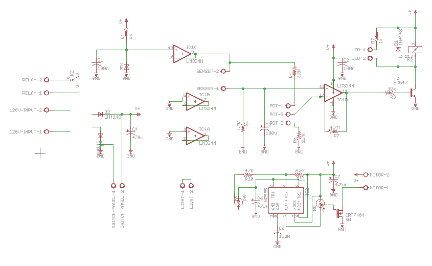

I will increase the r-value if i have to. I have an idea to do both of the suggestions. I could build the exterior box then line the interior with 1/2" hvac ducting board. Then case it in with a thin 1/4" layer of walnut to cover it up. It would look good and insulate. This would however add a significant amount of cost and time. How about the heater? Are ya'll saying to just install the 60ohm and be done with it?
my thermostat is still in design state. i have built several prototypes so far. I want to do everything i can to it before i set them in stone and have them printed commercially. Hence the addition of the humidity and temperature leds in the other post i linked to.
Yeah, the heating coil is effectively irrelevant as long as it produce enough power to get the temperature you want, just keep in mind if it's capable of producing a too much heat you'll want to add a saftey mechanism seperate from the main system to shut everything down and sound an alarm if it would go over temperature. If it it's well insulated you could start a fire if the temperature controller failed.
