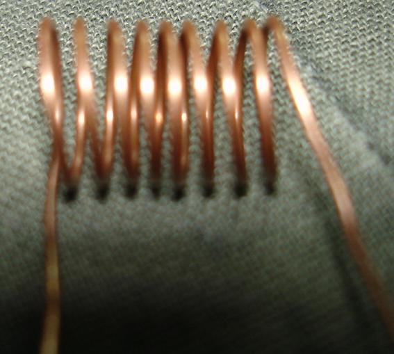

Anyway I have attached the photo of a new Inductor that I coiled using the enamelled wire from a coax cable.

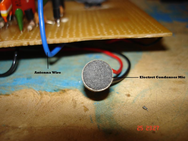

I've also attached the photo of the electret mic and antenna.
The photos of the electret mics I saw on the net have a metallic top. But mine has some kind of black coloured furry top. How do I check if it is working?

if the wire is really from coax cable it is definitelly not enameled
and it looks like bare copper wire - not enameled.
why is it 9-turn coil? for broadcast fm range circuit like this
it should be only 4 or 5 turns wound on 5-6mm form which is then
removed.
Hi T_an,
Where did you find that 250V candy-striped old cap? Its inductance is probably more than your inductor!
Hi Panic Mode,
My FM transmitter works fine with a 9-turn closely wound coil made from 1mm enamelled wire on a 3mm former, and also this project from where I got the idea:

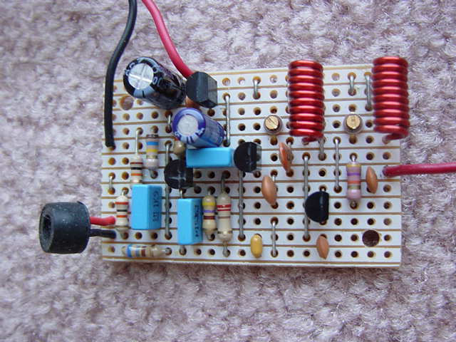

Here is a pic of my FM transmitter circuit built on a copy of Veroboard. It is Mod4, but using the circuit board of Mod3, so a few of its parts are very close together and I have resistor R6 and little ceramic cap C2 underneath. I have a 680 ohm resistor at the lower left as a current-limiting resistor for its LED. I don't have any space on this board for the 5.1V zener diode in series with the LED that shuts it off when the batt gets down to about 5.3V as a low-batt warning.
Look at the tiny size of its trimcaps and electret mic. The mic has a thick rubber sleeve around it so is actually much smaller. The 1mm wire for my coils is so stiff that you can stand on them and they don't change. :lol:
