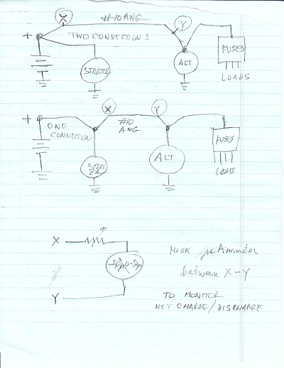

hmm, never thought of using micro-ammeter as currents can be quite huge
care to draw schematic just for sure Mike?
Goal is to have bi-directional alternator and load current between X-Y, but not starter motor current. You can set full-scale deflection by how far apart X and Y are on the wire, or by putting a 100Ω pot in series with the meter.
hmm, good thing with microammeter is that i don't need to cut or drag high-cauge wire all over the place. is that potentiometer calibration so to say?
If you have the patience, you can calibrate it so that 50A=50uA. Since the "charge/discharge" indication is diagnostic, just a "relative" indication is likely "good enough"
well if i want absolutic precision i wouldn't use analogue meters, they tend to give better overall-idea for situations. If i got it right, if i take more from battery what alternator can produce, meter shows as discharge and vice versa?

We already talked about this. Dont run the starter motor current through the shunt...

Do you really care about cold cranking amps? If so, two shunts. One to the starter (unidirectional 500 A) and one bidirectional to the rest of the car. The "dual scale" switching nonsense is up to you. Could be -800-0-800 / -150-0-`50 to make it easy with a zero centered microammeter.
Shunts are usually labeled with a voltage (usually mV) full scale with big lugs and small lugs. Between the small lugs is the precision resistor. so you might have 100 A, 50 mV as an example.
So converting a milliameter to a voltmeter requires two things:
1) Full scale current
2) internal resistance
1: Well, current is the same in a series circuit, so all you need is a way to do some varying. Variable PS and a fixed resistor. The voltage across a known resistor is current. figure out the steps.
2: the internal resistance "stumps" people. Cake. Use a variable resistor and a fixed power supply and adjust the resistor to 1/2 scale. Remove the resitor and measure it. that's the internal resistance of the meter. Simple. Figure out the steps that avoids emitting magic smoke.
Turning known characterized meter into a voltmeter is now easy too. Some resistor in series with the microammeter wil turn it into a voltmeter.
Make your own meter face. I can take a pic of an 8th grade science project (1970's) where I did just that.
changing the resistor based on starting/running shoud not be too bad. Just make "start" the normal state. The shunts alwats stay in place.

Well i don't really care measuring startupu current, if car starts, it is enought. If i want to monitor that, i'd need peak detetcor because it's so fast analog meters won't hold it long enought, i'd presume so
What i want to monitor is normal consumption so i can better monitor on-road whether charging is enought from alternator and such
I haven't yet put any of these voltage/ammeters, but i like more the idea of using microammeter over normal ammeter just because then i don't need to cut wires and all that....
What is funny, i yet have no idea what size of meter is enought, because i don't have any high-wattage woofers on trunk, i doubt i need 100A meter. Frankly, i haven't yet even located main fuse on this car which sounds ridicilous i know, every car owner should know where main fuse is.....unless it is some big wire what just snaps instead of fuse, which sounds like bomb to my ears.
So, only normal current is enought, no need to monitor startup-current
