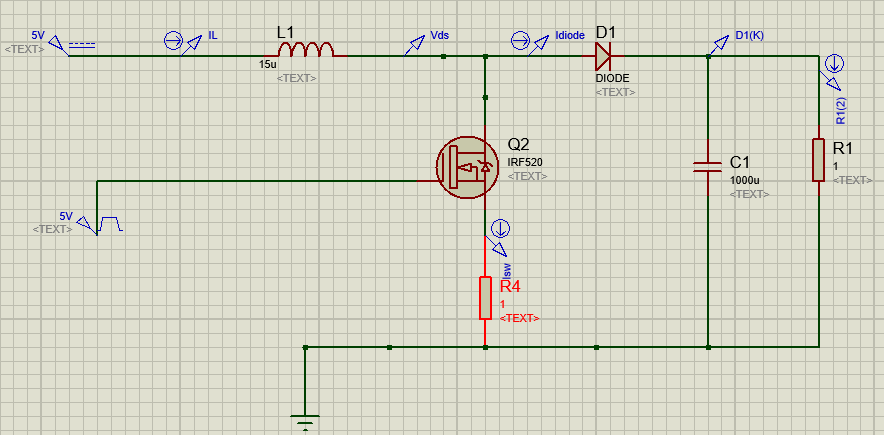

Hello,
I'm trying to drive a mosfet with a 5v 100kz pulse, but I can't activate it. Does somebody know what am I doing wrong ?
Thanks :)

Just checking, you do realize when the MOSFET is switched on, that it's just shorting it out, right? You're not going to get any current to the right of it.

Nice remark, I tried placing a resistance between the mosfet and the ground, but the mosfet is still off. If I replace the mosfet by a bipolar it works perfectly...uu
Remove R2, I don't think it is really serving much of a purpose there. Also, 10k for R5 seems quite high. Try exchanging it for, say, 4.7k, or even 2.2k. I just pulled these values out of mid-air, no math went into finding those values.
EDIT: I almost think you can take out R5 completely.
Is the signal on the bipolar transistor supposed to be inverted? The way you're triggering the FET now, it will switch on when the signal on the BJT is switched off.
Furthermore, the components to the right of the FET are connected directly between +5v and ground, meaning they will always be supplied with current. The 1 ohm resistor is going to take most of the current. Are you trying to switch on current to the components to the right of the FET? If so, you're taking a completely wrong approach.

I simplified the schema (see my last post pls), now I send the pulse directly to the FET.
Try a square wave 5V or 10V peak signal as the input.
That's what I did, but still I can't activate de mosfet. I tried with the IRF3711 fet, and also with a generic one.

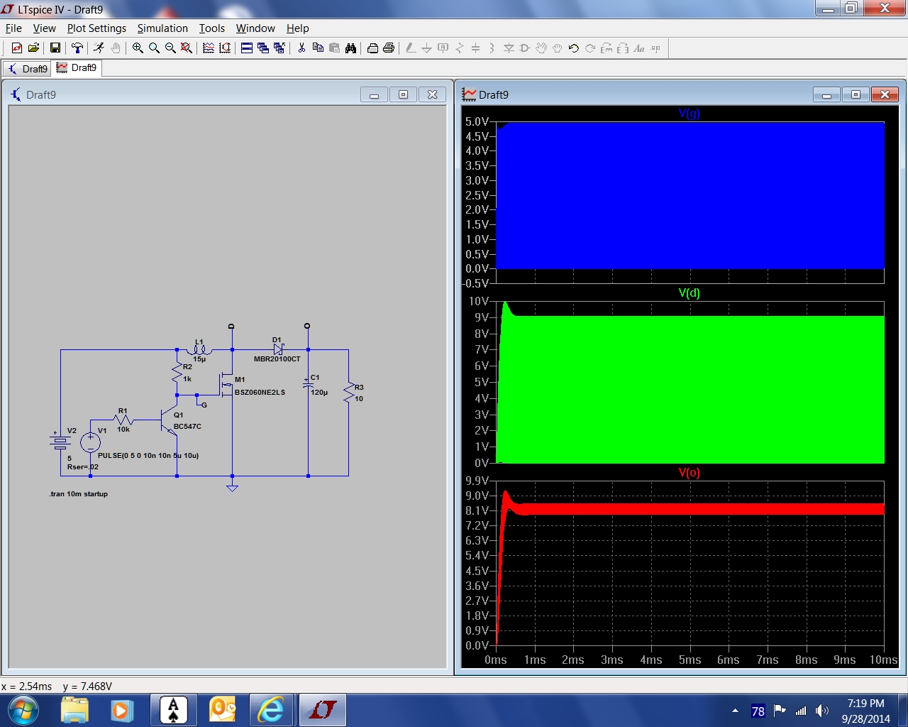

I don't use Proteus, but here is spice.

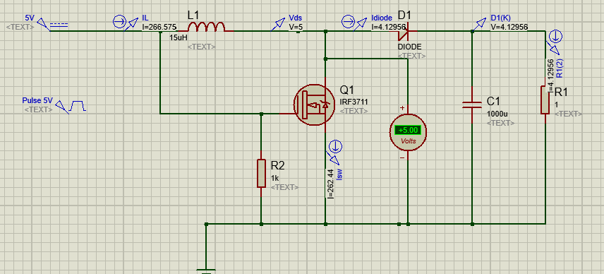

DerStrom8, I tried this:
Do you see that the FET is not activated? Even if I connect it directly to the 5V source ! I also tried placing a button, and I get this error:
DELMIN increased to 2.2e-16 due to lack of time precision
transient GMIN stepping at time 1.2
TRAN: Timestep too small, timestep=2.77e-16: trouble with instance D1
The load is only 1 ohm and the Mosfet is an old one. When the Mosfet switches then the voltage boost will not be much.
I'm kind of guessing, but it looks like maybe your inductor has very low resistance so 264 amps thru the fet. Since it can't do that it may show 5 volts still. Try it with a resistor - say 1 ohm in place of the inductor until you can see it switch.
