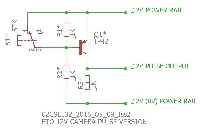

I am trying to trigger +12v going to a multi-view backup camera to signal it to change views when I press a toggle switch. The problem I face is that the toggle switch is NC and the 12v drops OFF when the button is pressed. I remember using 2 relays in the past to get around this situation but I forget how to make this work and how to wire it. I would like to use as small of a setup as possible and the small backup camera is rated at 12v <70mA so I would like to use as small of a setup as possible. Any help would be greatly appreciated.

Hy throttleman,
Here is a circuit that will do your job.
The output will normally be 0V. When switch 2 is pressed the output to the camera will be 12V and when the switch is released the output will be 0V again.
(the * after the component names have no significance and should be ignored)

The 12v source is an ignition switched power source. I am using a cigarette lighter power source. The trigger only needs to be a momentary 12v to switch to the next view. Thanks for your help!
Then Spec's circuit should do what you want.

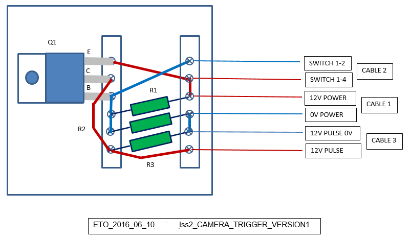

Here is a layout for the camera pulse schematic shown in post #3
Please check both the schematic and the layout for errors (there normally are some :))
NOTES
(1) The unit is built on to the inside of the lid of a small plastic box using a twin row tag strip (cut down) screwed to the lid.
(2) The components and wires are soldered to the tag strip as shown.
(3) The input and output to the unit is via three two core cables. Theses should enter the lid via three holes, preferably with grommets in them.
(4) It would be advisable to include a 1A fuse in the 12V supply line.
(5) The transistor can be screwed to the lid for security providing that the lid is an insulating material and a nylon screw is used (the metal tab of the transistor is connected to the collector).

(1) Tag strip: https://www.ebay.co.uk/itm/Epoxy-Terminal-Strips-Single-Double-Row-5-20-Solder-Tags-Various-Sizes-UK/121946366282?_trksid=p2047675.c100010.m2109&_trkparms=aid=222007&algo=SIC.MBE&ao=1&asc=20140221143405&meid=82759e78dfbc43b2975d502f7c29f429&pid=100010&rk=4&rkt=13&sd=131835526552
(2) Resistor: 1K Ohm, 3 off:
(3) Power transistor: TIP42x (where x= any letter) https://www.onsemi.com/pub_link/Collateral/TIP41A-D.PDF
(4) Connecting cable: Mains cable 2 core, 3A or higher
(5) Interconnecting wire: Strip sheath off mains cable and use the core wires
(6) Case: to be defined
(7) Grommets: 3 off
ERRATA
(1) Title lower should read 'PULSE' not 'TRIGGER'
