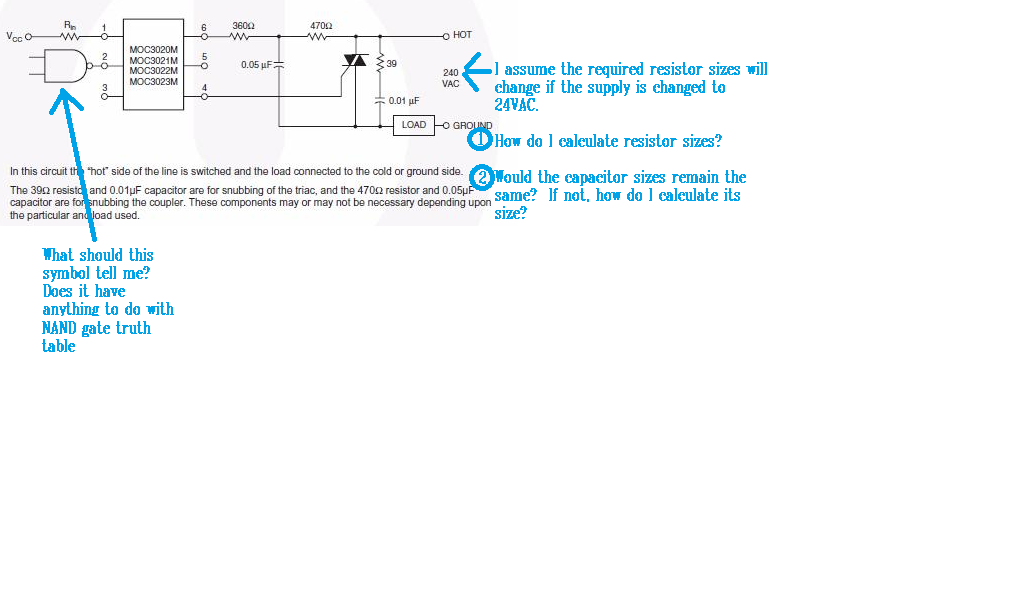

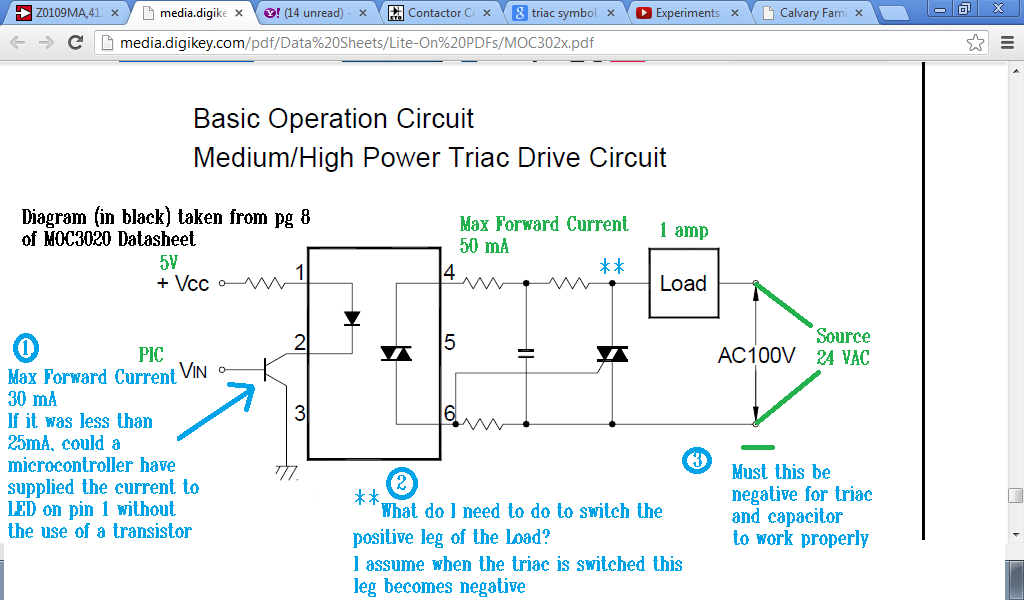

I am trying to use an opto-isolator (MOC3023S-TA1) as a switch for a 1 amp circuit. I have a lot of questions but would like to start with the 3 on the image.
the moc3020 can be driven directly by a microcontroller. 30mA max doesn't mean you need to drive it with 30mA, it means don't drive it with more than 30mA.
there is no + and - sides... it's AC... there may be a HOT and Neutral... the capacitor needs to be nonpolar AC type.
I use a MOC3032 which lists max current at 60mA, and I drive it at 7.2mA.

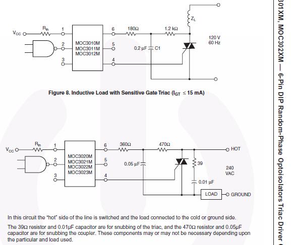

Attached are two drive schematics directly from the MOC3010-3020 data sheet:
1) It depends which micro you use. Check the datasheet to see what the max allowable current is.
2) and 3) You are driving this with 24V AC so the polarity is constantly reversing.
yes, that is a NAND gate, but all you need to know is to hook pin 2 to your uC and drive it low to turn on the circuit. To set the pin 1 resistor, take the 5v source minus the on LED voltage (1.5V) minus the output low voltage (assume .7V), divided by the current.
Note the design specs are listed at 10mA, so, designing for 10mA, (5-1.5-.7) / .01 = 2.8V / .01A = 280 ohm = 270 ohm or 300 ohm.
{2.8V / 270 ohm = 10.37mA or 2.8V / 300 ohm = 9.33mA Note that the uC output low and/or LED Vf (voltage, forward drop) can be a little higher or lower, as well as the power supply, so that is why we design with 5% resistors when it doesn't matter if we use 10mA, +/- 10% (9-11mA).
As the note in the schematic states, the resistor/capacitor values are only representative of a specific design, so depending on what your load is will depend on whether or not you even need a snubber. Basically, you calculate the RC value needed for the frequency response you are looking at. Then, since capacitors come in 10% values (or larger), you pick a capacitor, then base the resistor value on that. The values given are a good place to start, and I'm am not an expert in snubber design, but I can research it. Unless someone else wants to weigh in here???
note that you need an extra snubber (rc network) when driving it high vs low, that's why driving the low side is more popular.
it mainly depends on your load type: is it resistive, inductive, capacitive? A mix? what is the 24vac source? is it noisy, clean?
