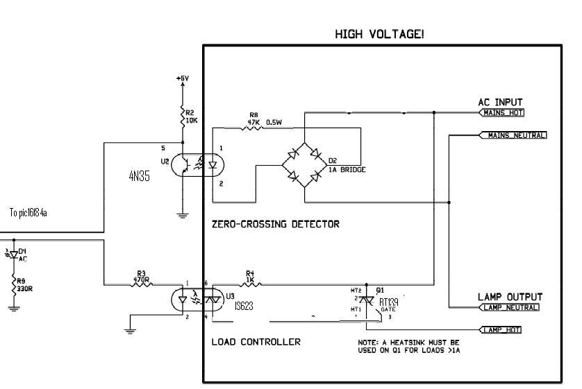

hi all
Iam facing aproblem on firing triac , iam using pic16f84 to control the firing phase angl Via timing
attached the circuit
there is only problem that the triac cut off when itis loaded by 100 watt load
every thing is ok this include
1. zero crossing detectin
2 signals from/to pic16f84
3.opto coupler "IS623" and opto isolator 4n35
i check the phase control proccess by oscilloscope and phase controlled wave was OK
the only problem is the triac goes off when the 100watt load is loaded
any help will be appriciated

At what phase angle are you trying to fire the triac? What voltage is driving the opto?
Try some resistance across the cross over iso-coupler diode. You may have poor rise and fall times without it.
Don't connect your lamp to the low side of the traic. Connect to the hight side.
hi all
thanks for replying
I try all what you all mentioned , unfortunally it doesn't work
actulay i have abeautiful phase controled ac 220 sine wave
But once i connect the 100 watt load it disappears i gues that opto coupler IS623 is the part which makes
the troubles
any ideas , hints will be appriciated
thanks alot
BR
I think this would happen if you have exchanged MT1 and MT2 on the triac. Be sure that MT2 is the center wire/tab.
